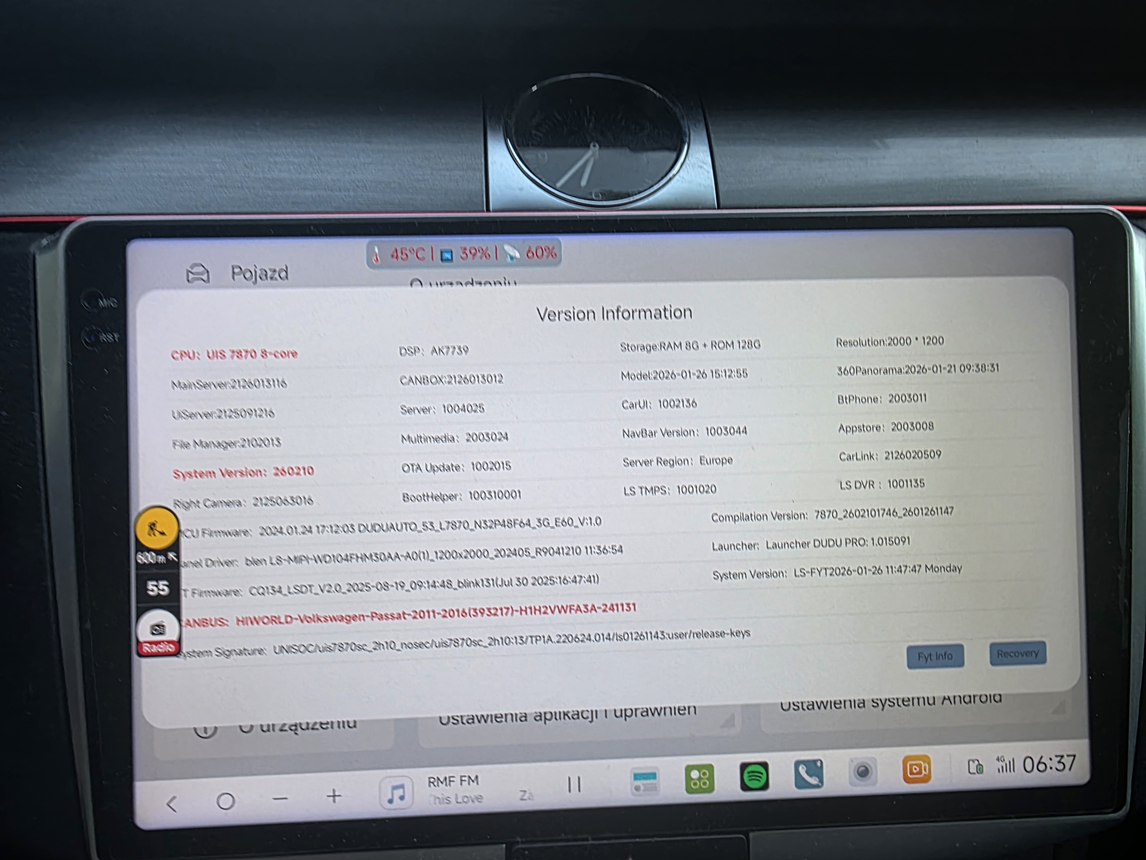

I just got a HIWORLD CAN converter for the DUDU7. I have the VWFA.20 model for VW. Previously I had a Raise box. The HIWORLD works, but the speed data is sometimes wrong, the handbrake info is missing, and the engine water temperature is visible in the vehicle settings but missing from the DUDU launcher widgets. The odometer shows no values, while the engine revs are correct. Could I please get some help with this?

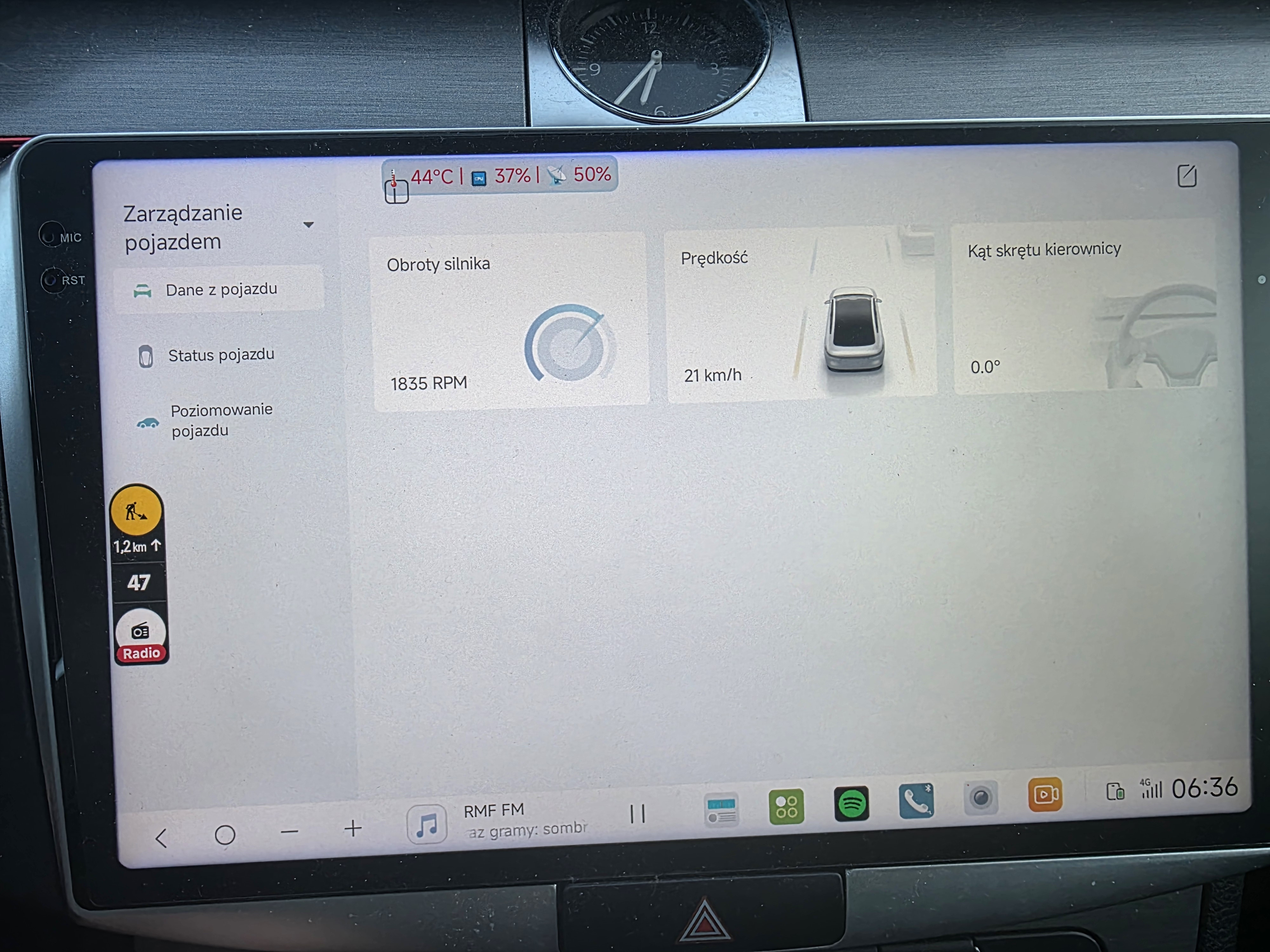

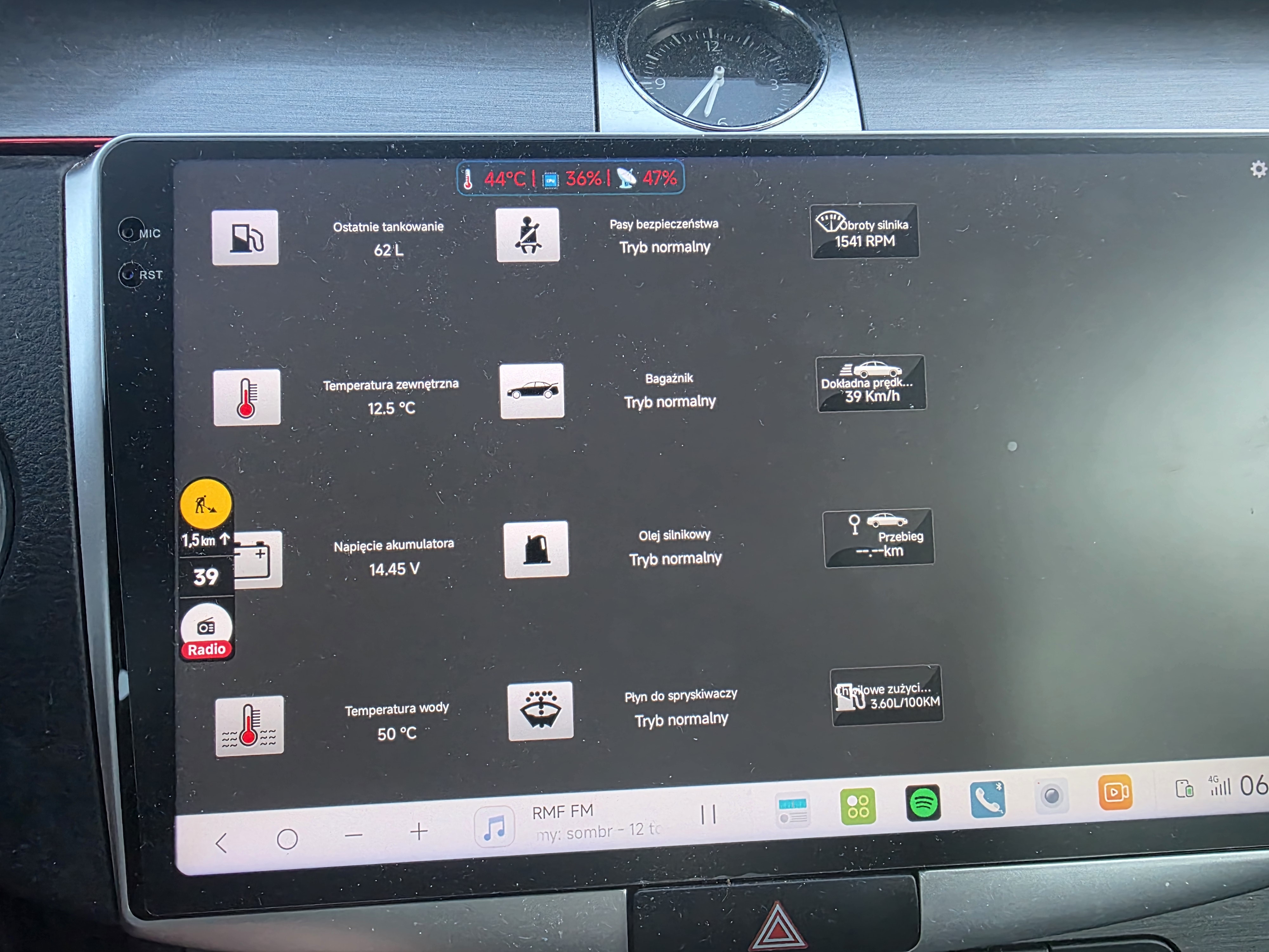

I just drove my car and recorded data from Vehicle settings tab. Speed in Vehicle settings is correct, but in the main launcher in the widget is wrong (on RAISE canbox it was correct). In Vehicle settings this "Water" temperature is incorect, there should be oil temp i checked it is oil temp instead of water. It would be nice to get there real water temp not only the oil temp.
