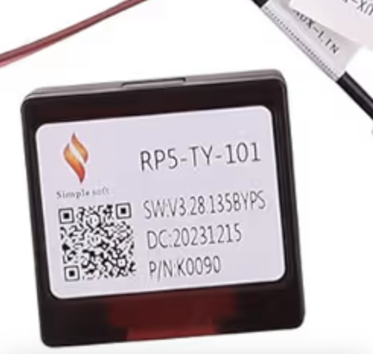

I can't find my car CAN BUS on the list, could you please help me with that?
CAN BUS information:
TYZ 20201201
HW: V2
SW: V3
Car model: 2007 Toyota Camry Hybrid.
And, when I click on the SWC tab, the screen froze.

        ahmedjassm
        There are too few vehicle brands supported by this CANBUS box. You can consider purchasing other brands of CANBUS boxes, such as RZC (Raise) or others.
          caolz
          I am planning to get a new canbus.
          What company do you recommend, HIWORLD or RZC?
          Thanks!
            ahmedjassm
            Both of these brands are acceptable.
