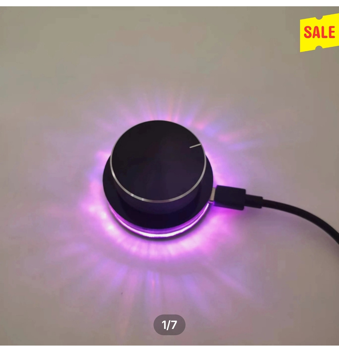

      Im using this
      https://a.aliexpress.com/_EHRLev2
        10 days later
        TiL Does it work for all sound sources or just things like music? Does the pause / continue feature work? Does it require setup or is it automatic? Thanks!
        Sorry for the delay. Works for all sound sources. No setup required, pause and next song works, but for next song it's inconvenient.
        This can be tested as well, but volume up and down won't be as convenient.
        https://a.aliexpress.com/_EGIjRYg

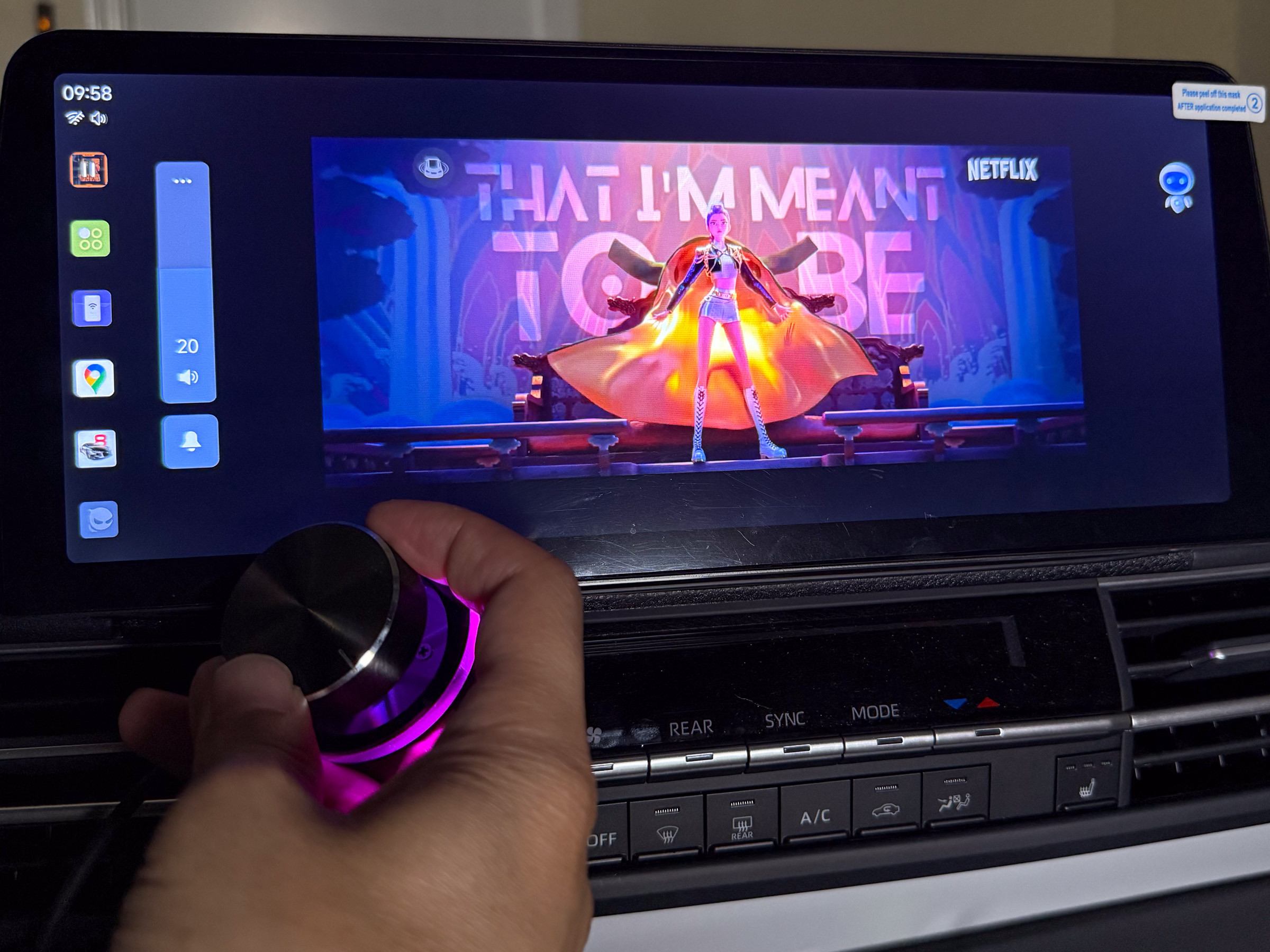

        eurban I found this USB volume knob on Amazon and ordered one to give it a try. Will report back when I receive it and test it out! https://amzn.to/4giZsRJ
        9 days later
        Just want to come back and say that this $10 volume knob definitely works with the DUDU7! Just hook it up to one of the USB connections, and it's plug-and-play. In addition to turning it left/right for volume up/down, you can also click it like a big button to mute/unmute, and if you hold it down for 2 seconds you can toggle the color-changing LED ring on/off. Finally, you can just get some foam tape or something to mount it where you want. Excellent! https://amzn.to/4giZsRJ
