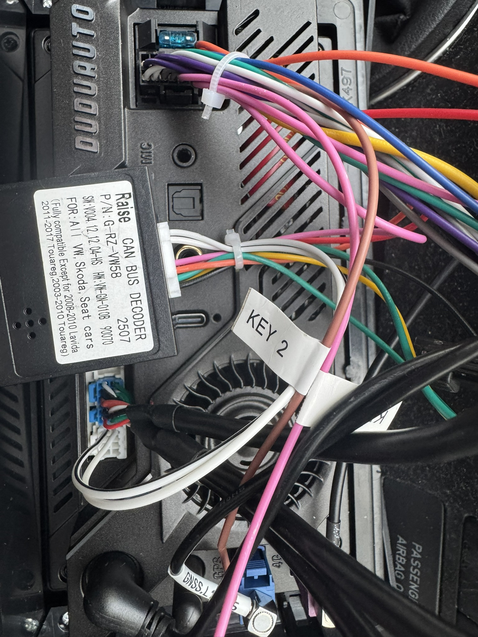

I had the same issue on a VW T5 Transporter 2008. I think they have the same CANBUS platform.

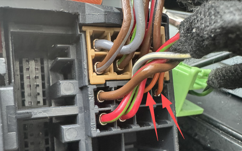

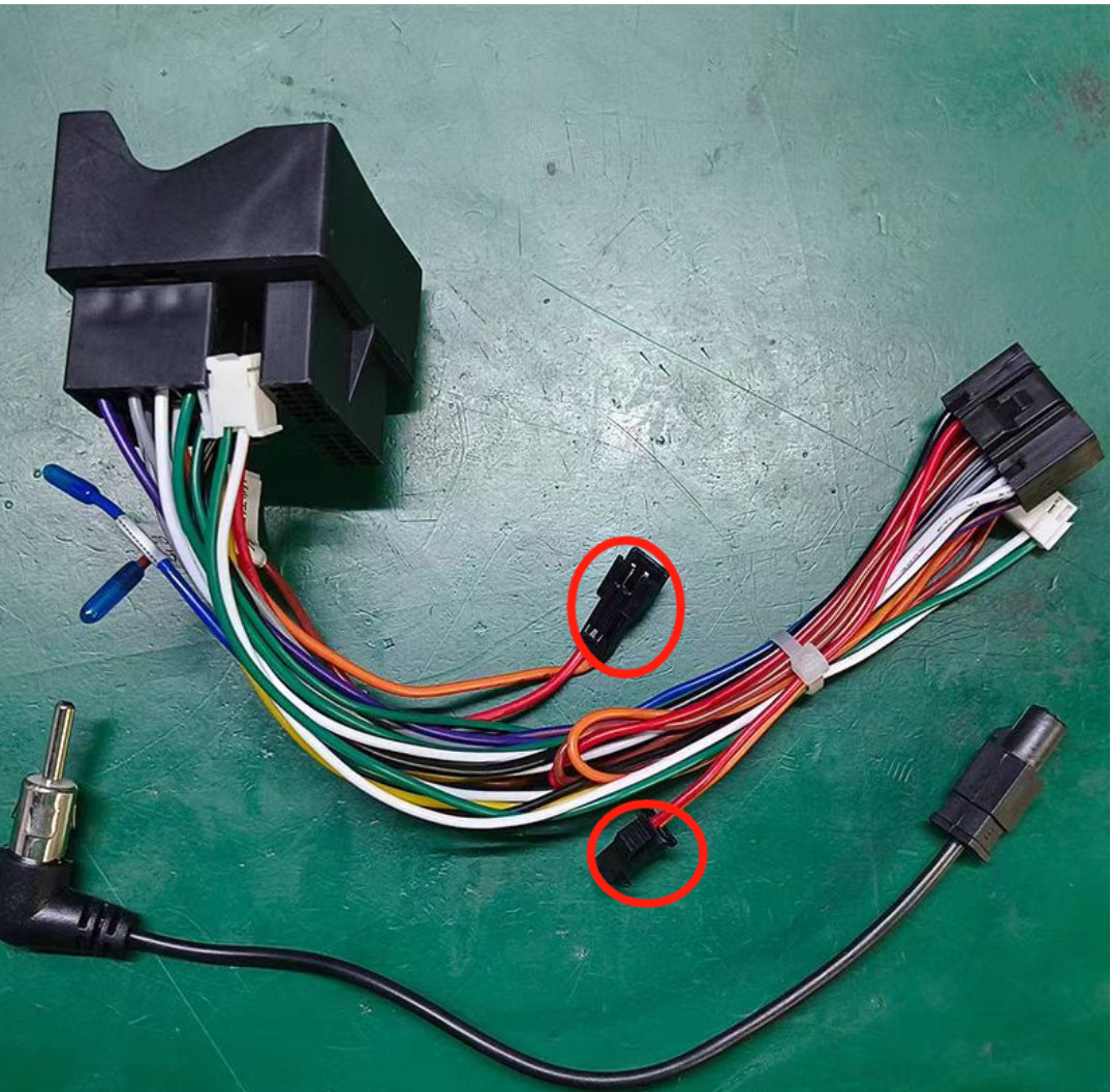

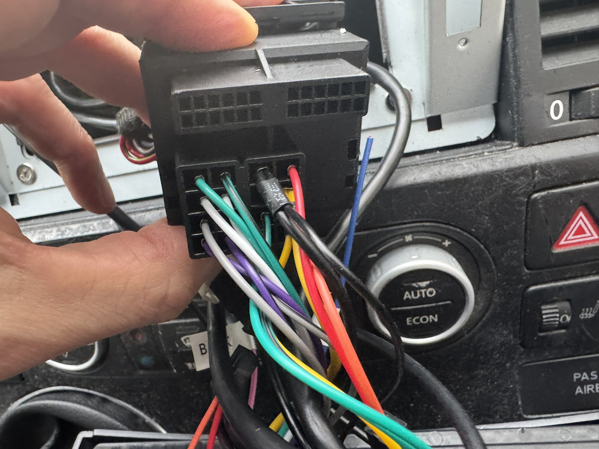

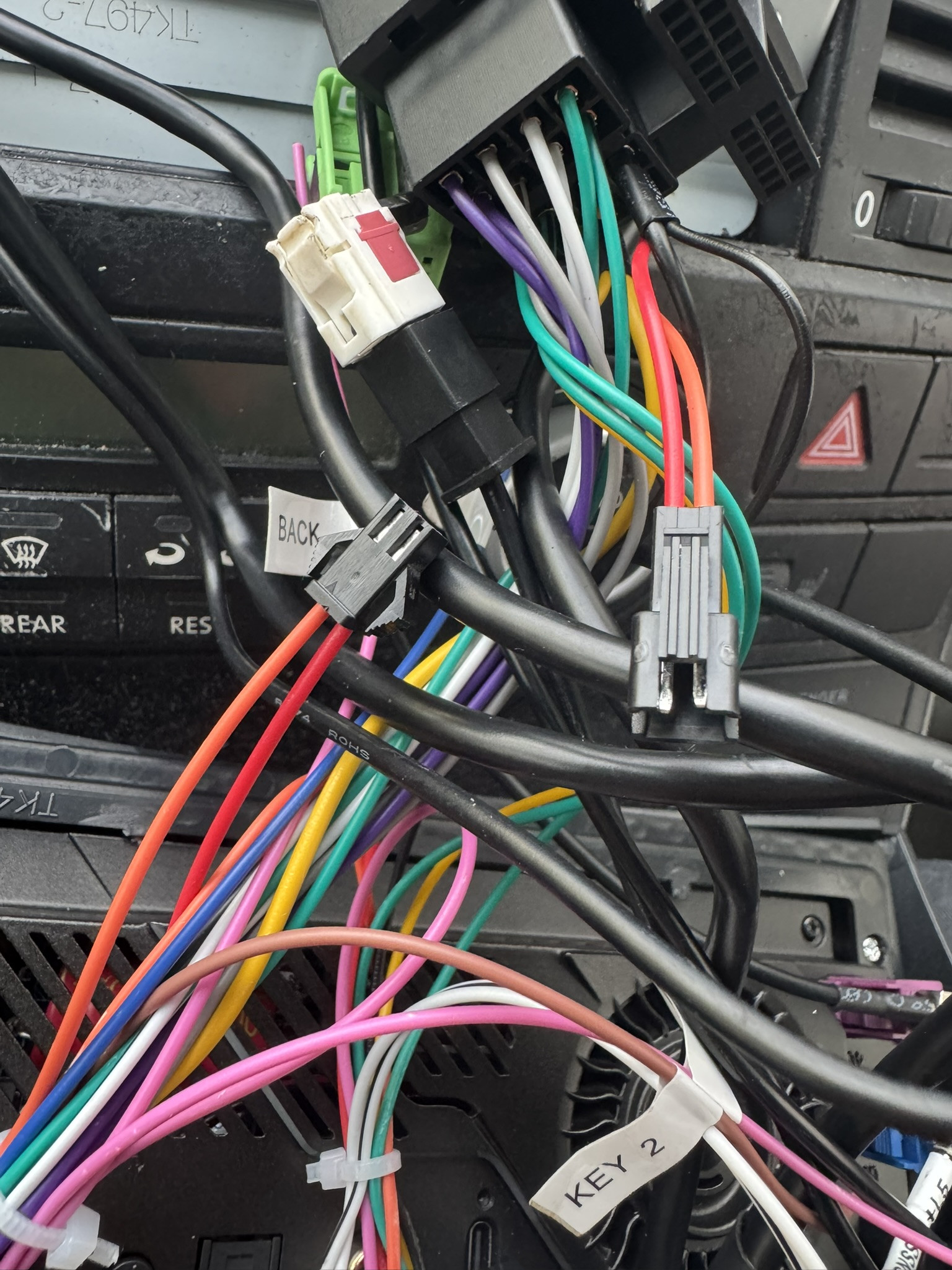

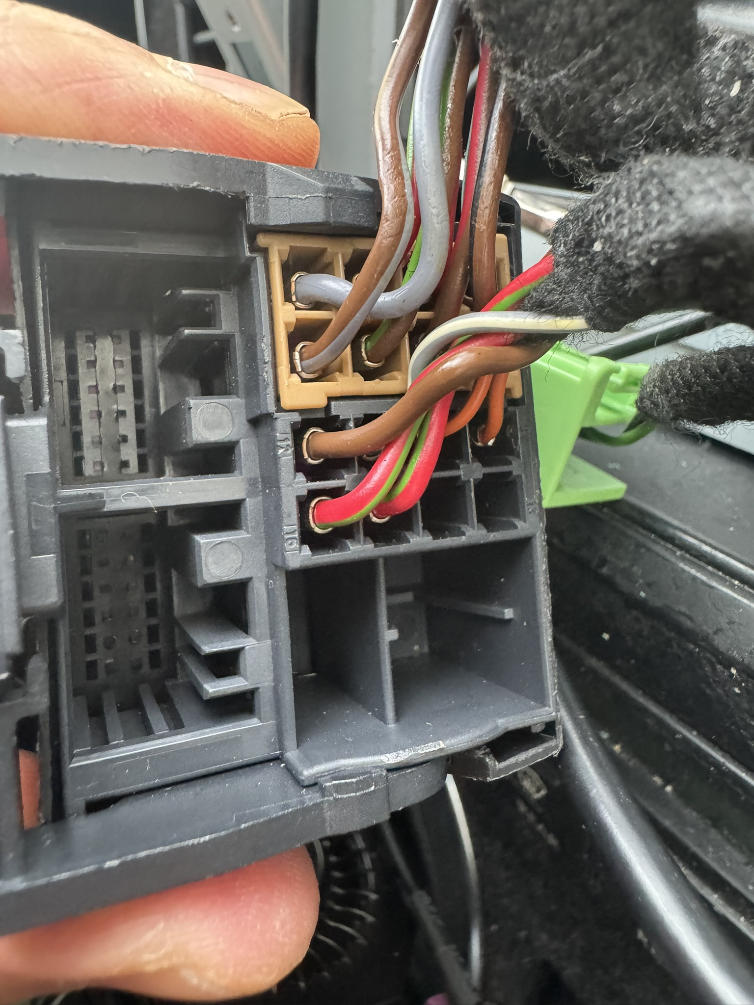

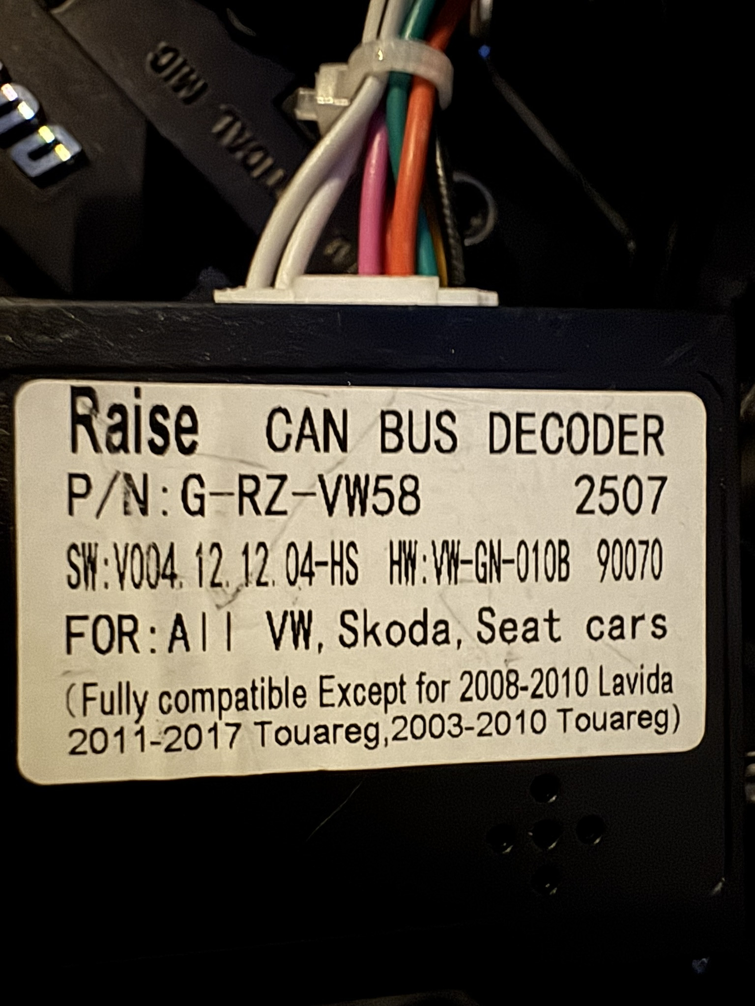

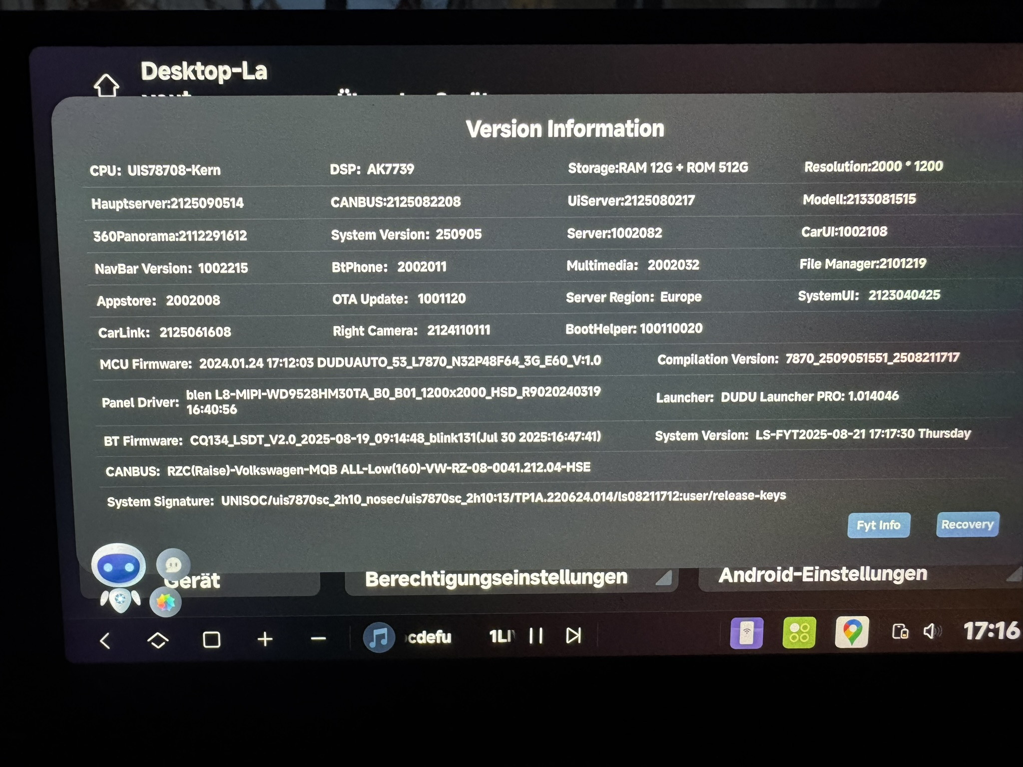

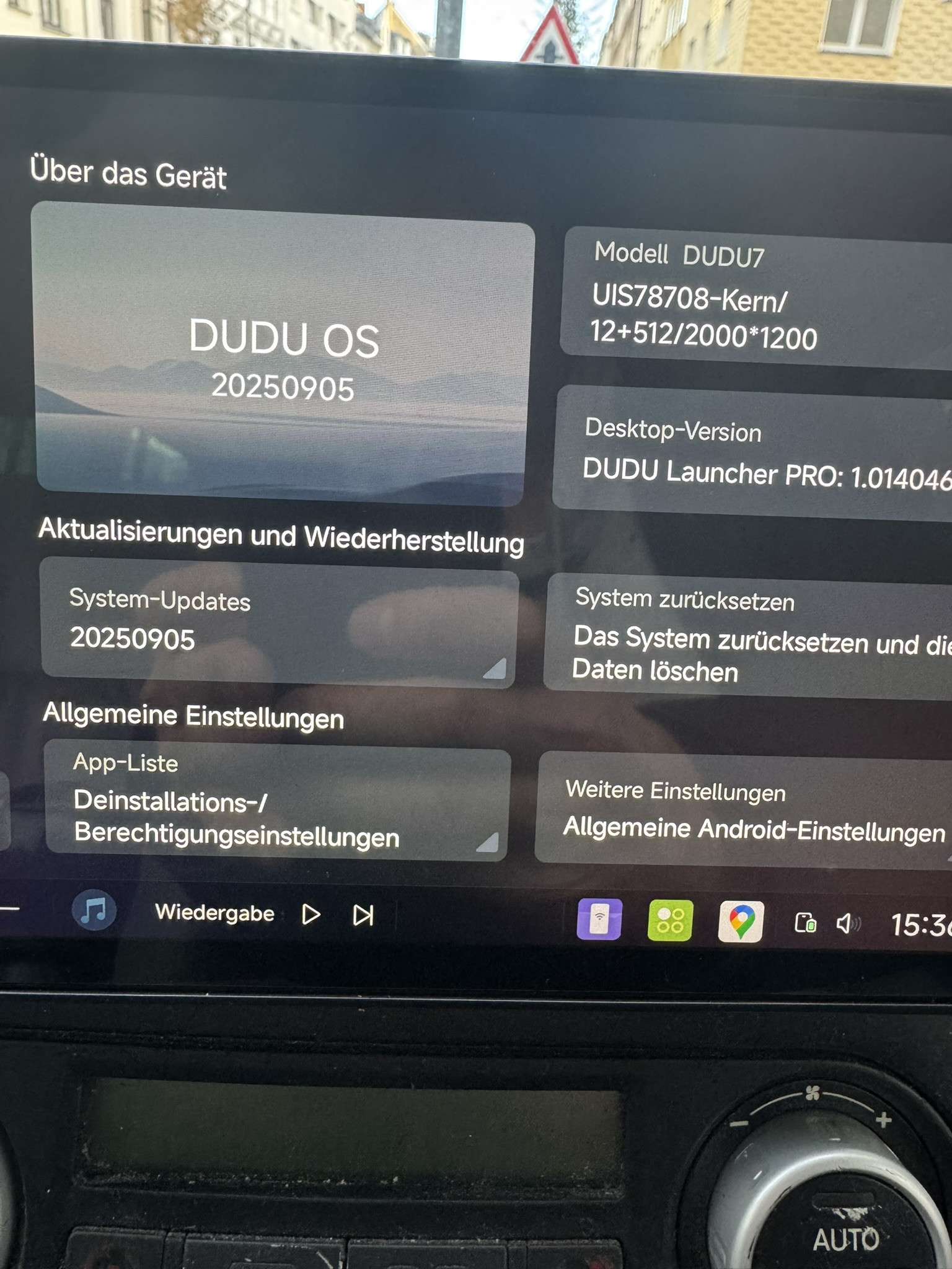

I have tried Raise VW-RZ-08 and VW-RZ-58 (multiple devices with different software and hardware version), and all of them have the same behavior: In general, they work just fine. Steering wheel, back gear, light switch, ... works as expected. But the Ignition signal, which is required by Dudu to switch on the radio is not forwarded.
I recently found some firmware updates (AFAIK May or June 2025) for Raise, but I haven't had time yet to test them.

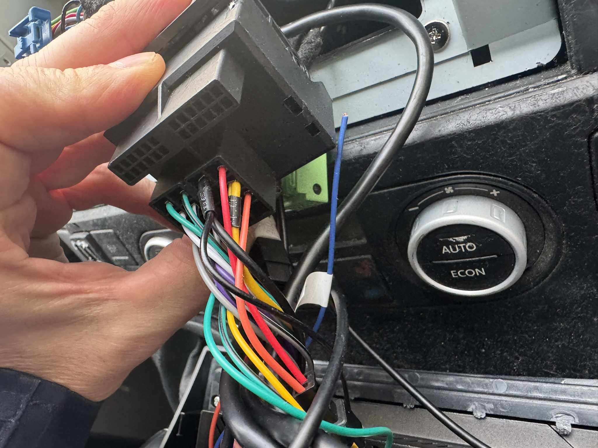

I fixed the issue by replacing the Raise with a HiWorld VWFA.20. According to the documentation it is not perfectly supported by Dudu, but it works. And actually, the VW T5 doesn't expose much information through CANBUS anyway, so it doesn't really matter.
