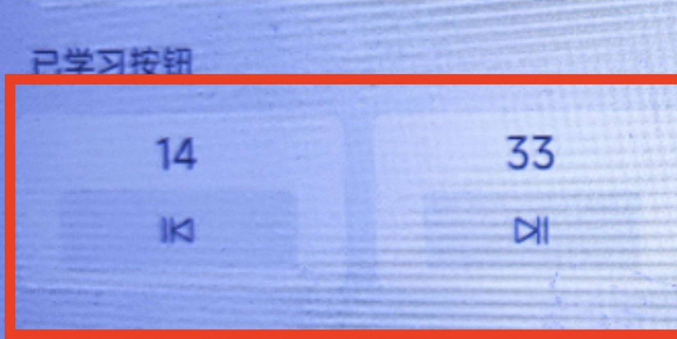

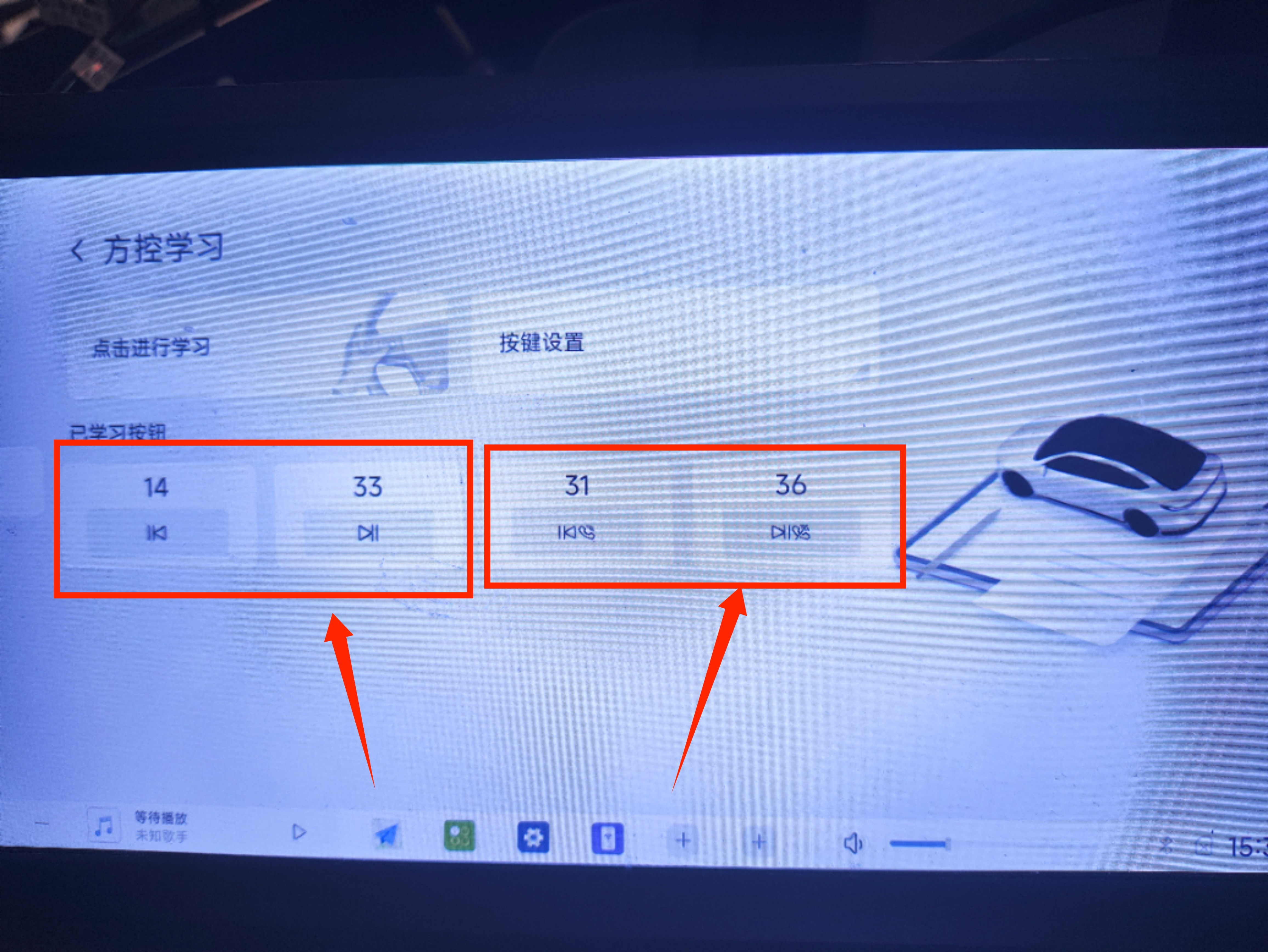

DUDU-Meng DUDU-Meng my buttons are set like this
Also, did you try putting device to sleep (not shutdown) then wake it up by giving it ACC(12v) and then try to use the steering wheel control? This is how they break on my end
And one thing more i experienced the same SWC issue when i was using CarLink v2.25.1020.0906 on my TeyesOS before installing DuduOS but i didn't pay much attention to it as mostly i used to put my Unit in shutdown mode so this proves that the issue is with CarLink app and not DuduOS.
And again the older CarLink version 2.25.0926.1708 does not have this SWC issue on my CC3 running DuduOS, so i will continue to use that.
