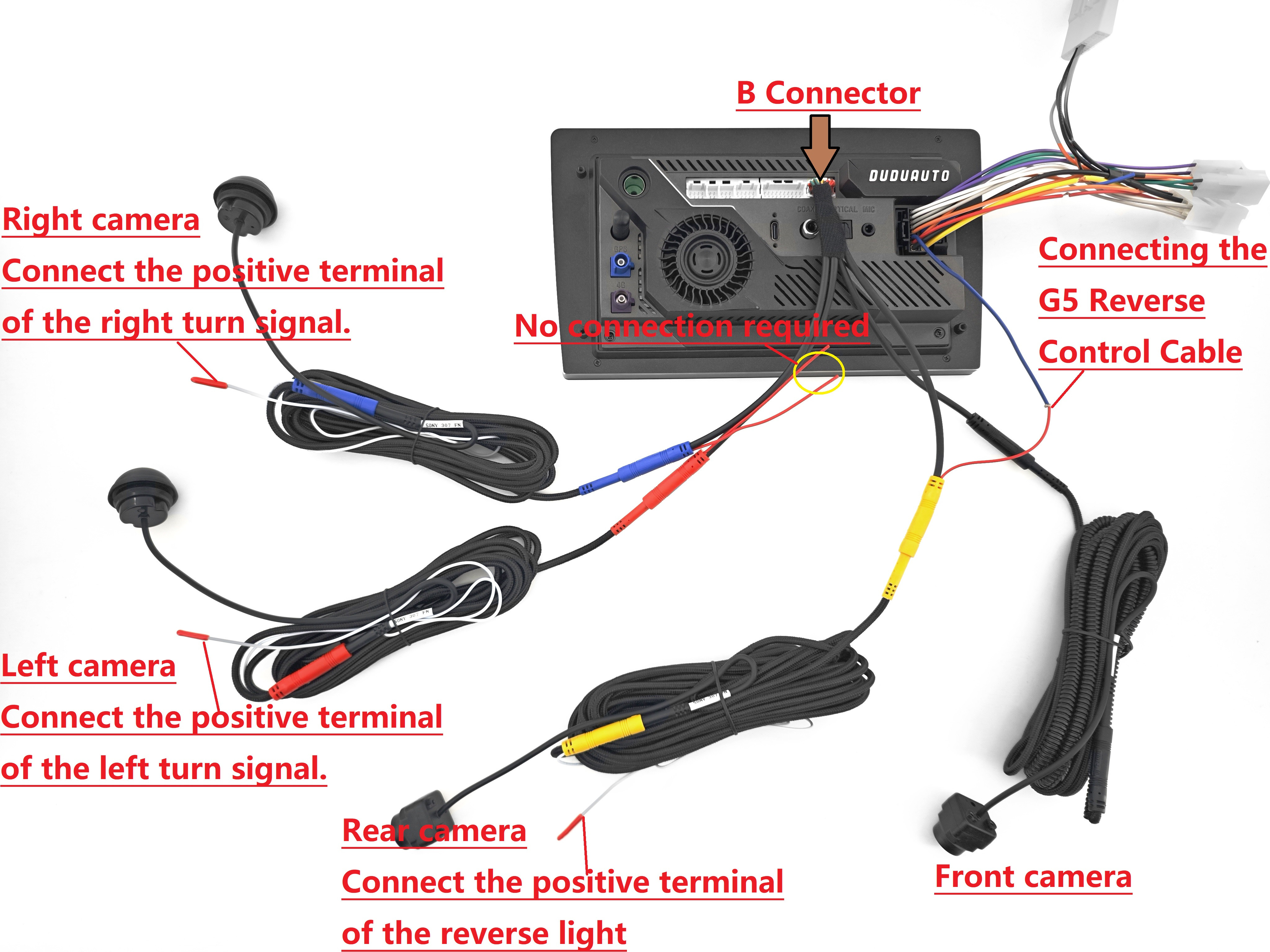

Having backup Camera issues, I have the DUDU 7 WITH 360 camera integration and I'm not getting any display on the screen. I have checked voltage at the white wire at the camera for 12v input. I know there is a small white wire near the radio does it need power as well?
