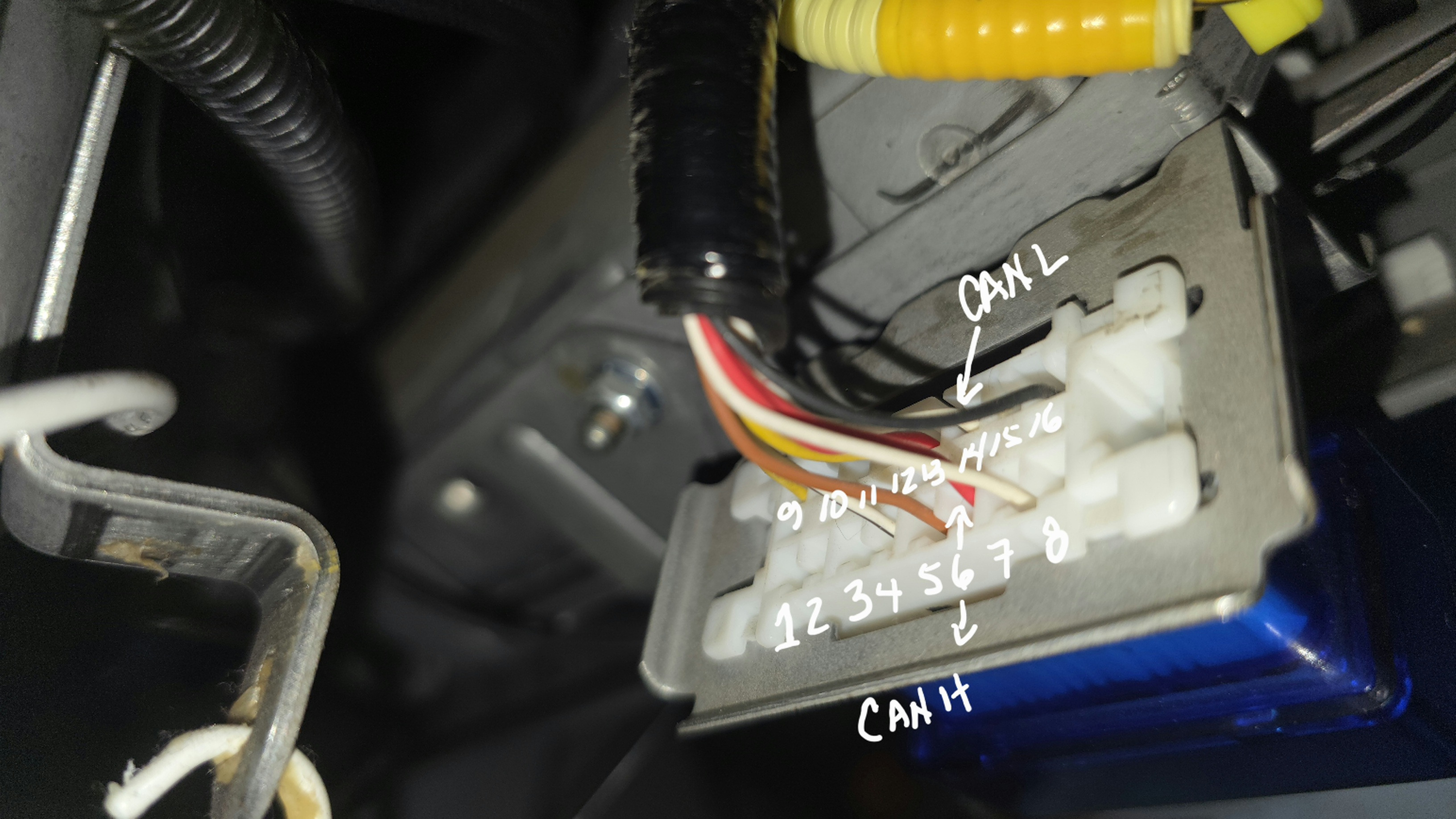

Gabe1321 According to my search, yes my sienna has CANH( red wire) CANL( white/black wire) and i took a picture of my sienna's obdll and it shows exactly those two wires [upl-image-preview url=https://forum.dudu-auto.com/assets/files/2025-11-02/1762115381-716036-20251101-180017.jpg @dudu-lai
Sienna14 For my 2014 sienna xle, I ran obd connector adapter to raise box to head unit, then parking lines, doors, and parking sensors work. Found it on AliExpress. Left another canbus plugged into the harness provided to turn on JBL amp.
