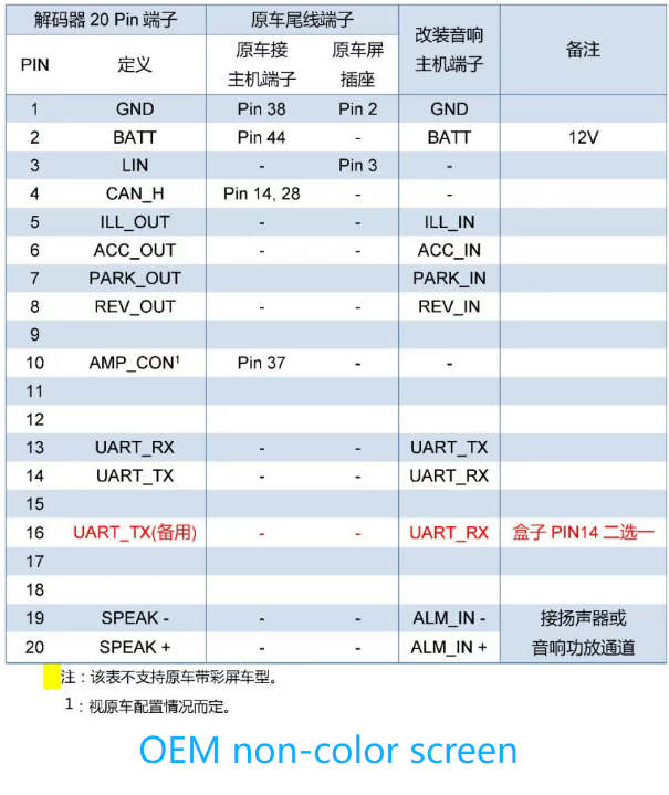

I try to find/confirm the right can bus box hardware for a Chevrolet Volt 2011-2015. There are some derivates from this car like Opel Ampera, Vauxhall Ampera and Holden Volt which have the same software.

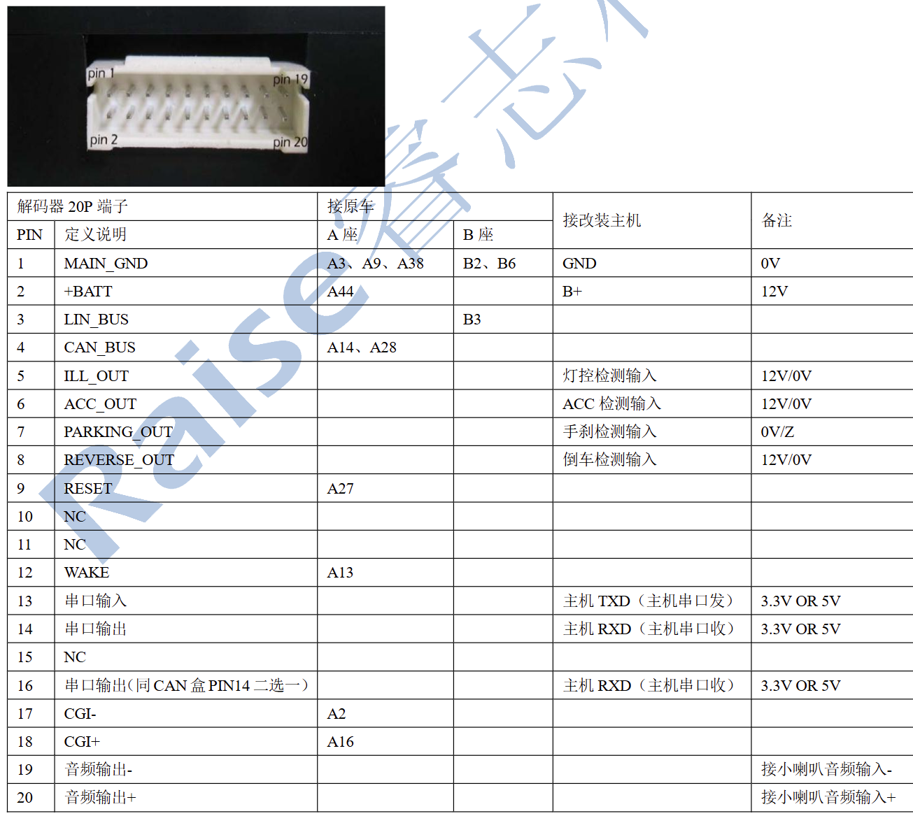

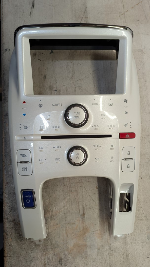

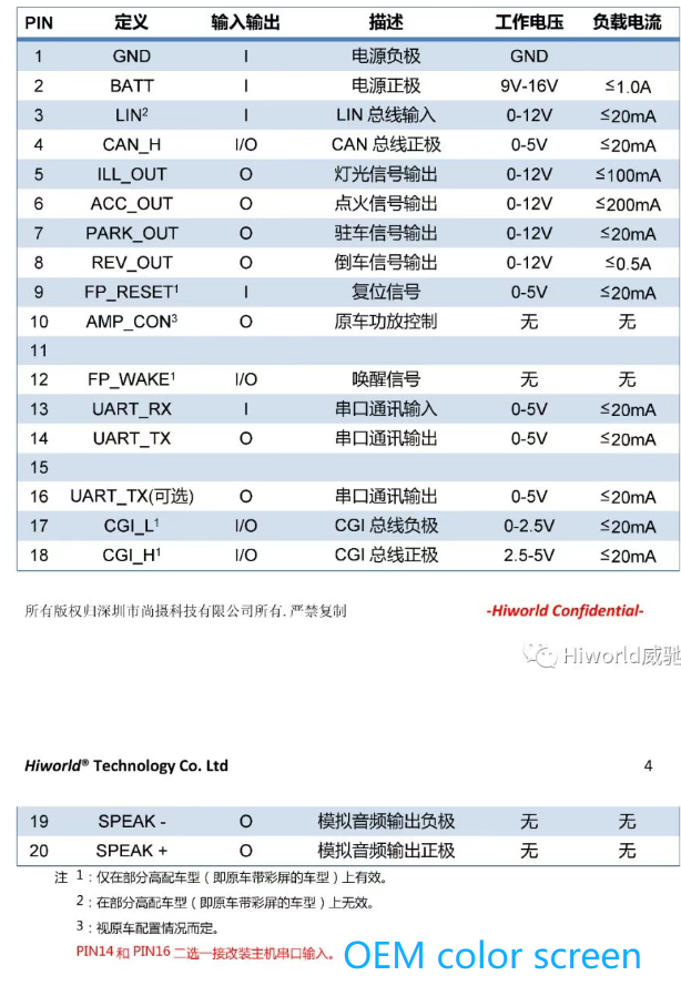

My car uses all bus connections + center stack reset/set of the canbusbox, i connected them all and it seems they are all working fine (3 Lin bus, 4 GM Lan, 17/18 CGI, 9/12 FP reset/wakeup)
Up now i have tested 3 boxes:
- Raise RZ-GM-09, SWC works mostly, park sensor works, blinker works, HVAC works a little with mistakes, Car Center control does not work
- Hiworld GMF 6.20, Basic DUDU Service frequently stopps working, test not possible
- Hiworld GMF 1.21 Basic DUDU Service frequently stopps working, test not possible. This is the Canbus Box is from what i know and the seller/technician told me the most compatible for my car since it supports gmlan, linbus and cgi.
With this Box Original Car Volume, knobs and buttons WORKS for a few seconds up to the dudu basic service gets crashed ....
- Raise G-RZ-GM51 works mostly, park sensor works, blinker works, HVAC works a little with mistakes, Car Center control does not work and the illumination from it is heavy blinking, Reverse Gear does not work,
I would be glad to confirm the right hardware box to get to the software side afterwards. I will then submit all information to go through. Inside DUDU Software this Car or a similar car is not listed to select. Any hints with which selection i should continue later is also helpful.
