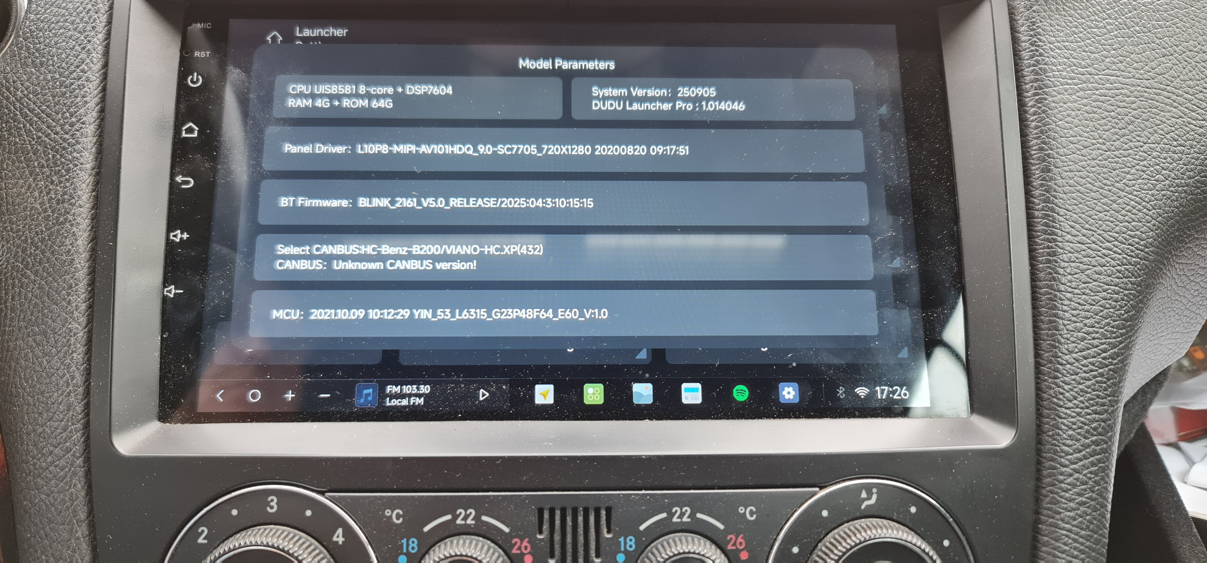

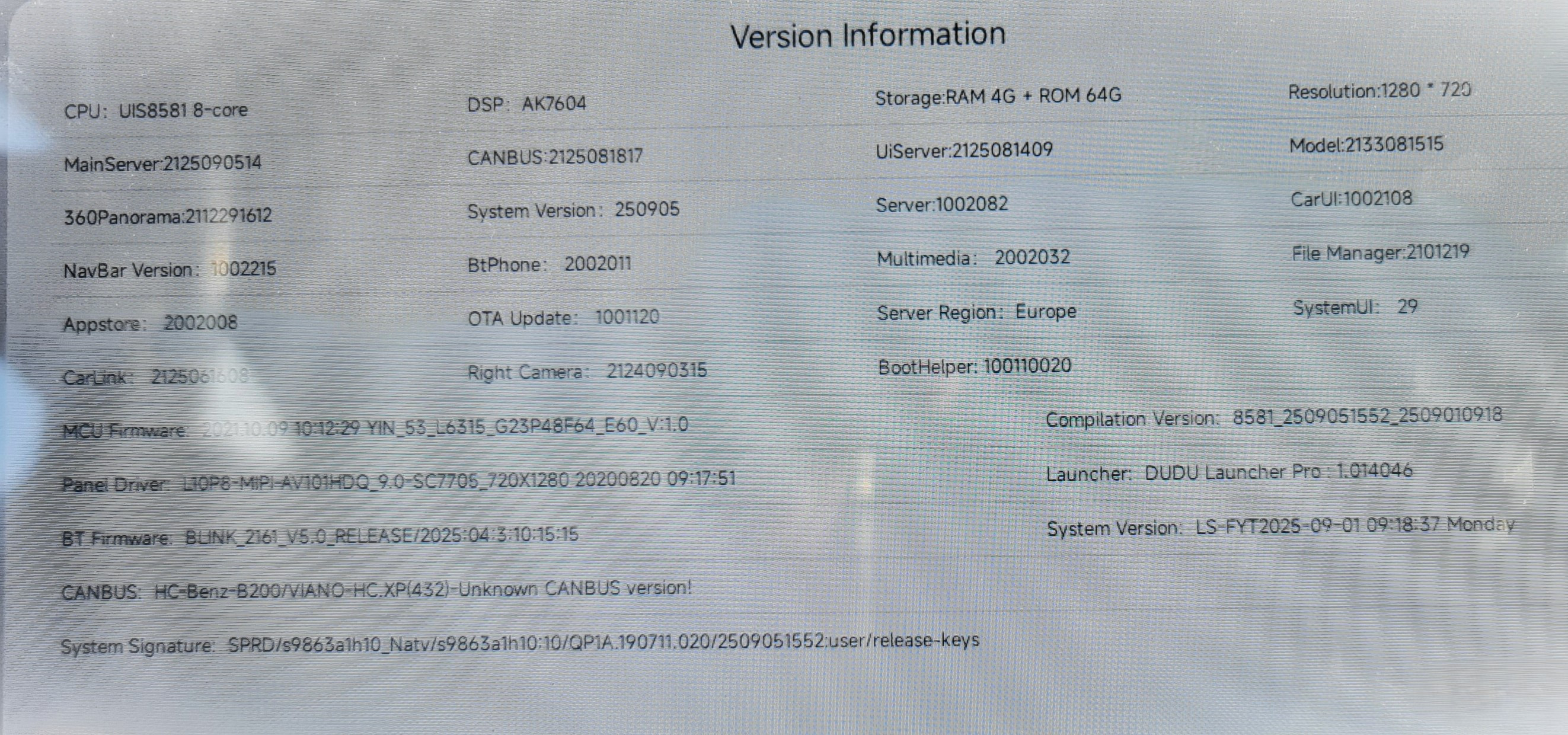

I am writing to report a series of critical and recurring software issues with my Mekede M400 car radio. I have been experiencing frequent system crashes and application failures, which make the device unreliable and frustrating to use.
I have collected and analyzed system logs and crash reports from the device. The analysis reveals that the problems are not isolated to a single app but are deeply rooted in the system's core software (firmware). The issues can be categorized into two major areas:
