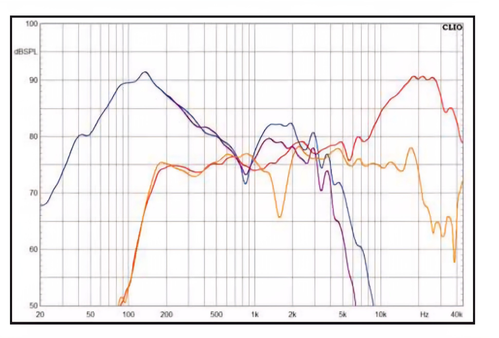

If it's interesting.
Both my VW T5 doors are insulated with aluminum butyrics. I use an Eton UG 3.2 VW T5 front system.
In general I find the sound of the radio very dull and thin.
