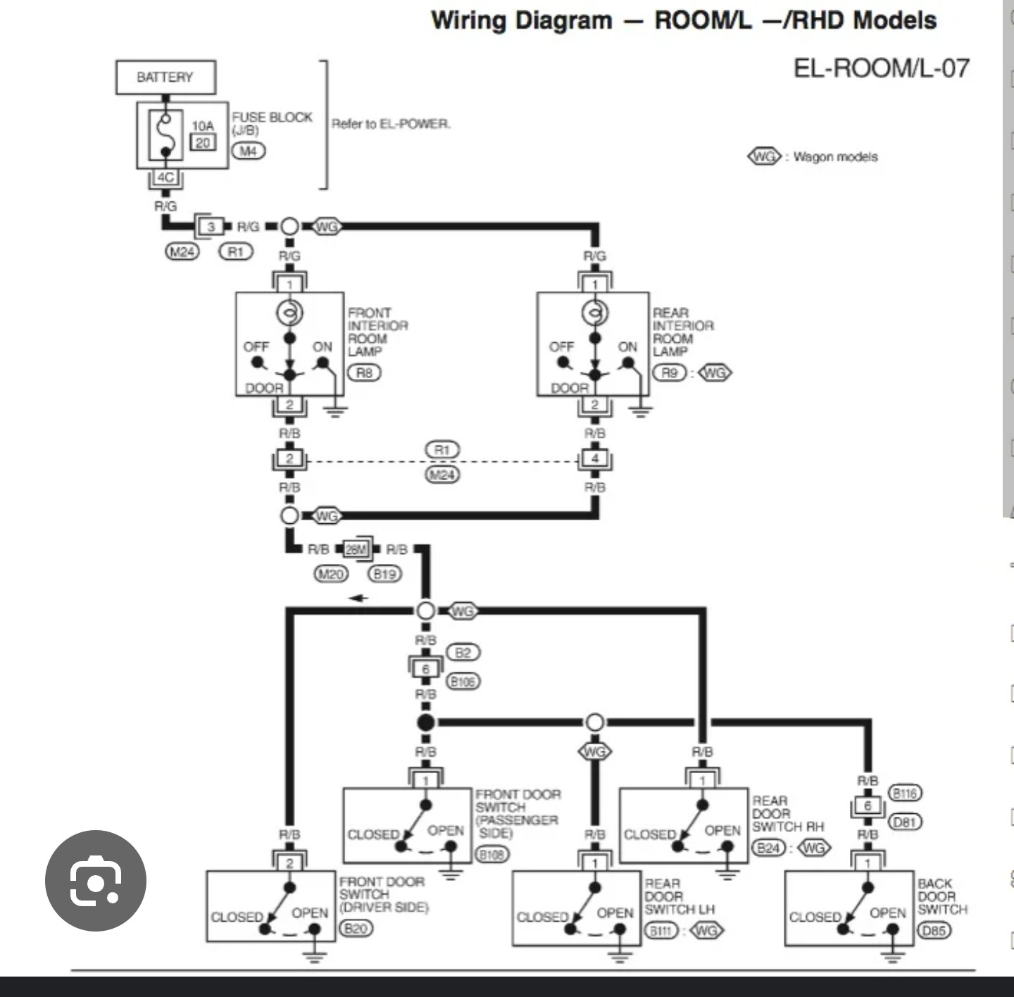

marcocamilleri1111 Just logic needs to be changed in the sketch:
- // HIGH meant closed before; set bits on HIGH
- if (digitalRead(FRONT_RIGHT_DOOR_PIN) == HIGH) newDoorMask |= 0x80;
- if (digitalRead(FRONT_LEFT_DOOR_PIN) == HIGH) newDoorMask |= 0x40;
- if (digitalRead(REAR_LEFT_DOOR_PIN) == HIGH) newDoorMask |= 0x10;
- if (digitalRead(REAR_RIGHT_DOOR_PIN) == HIGH) newDoorMask |= 0x20;
- if (digitalRead(BOOT_PIN) == HIGH) newDoorMask |= 0x08;
- // LOW (GND) means DOOR OPEN now; set bits on LOW
- if (digitalRead(FRONT_RIGHT_DOOR_PIN) == LOW) newDoorMask |= 0x80;
- if (digitalRead(FRONT_LEFT_DOOR_PIN) == LOW) newDoorMask |= 0x40;
- if (digitalRead(REAR_LEFT_DOOR_PIN) == LOW) newDoorMask |= 0x10;
- if (digitalRead(REAR_RIGHT_DOOR_PIN) == LOW) newDoorMask |= 0x20;
- if (digitalRead(BOOT_PIN) == LOW) newDoorMask |= 0x08;
Here's full sketch (provided you have resistors as per schematic):
