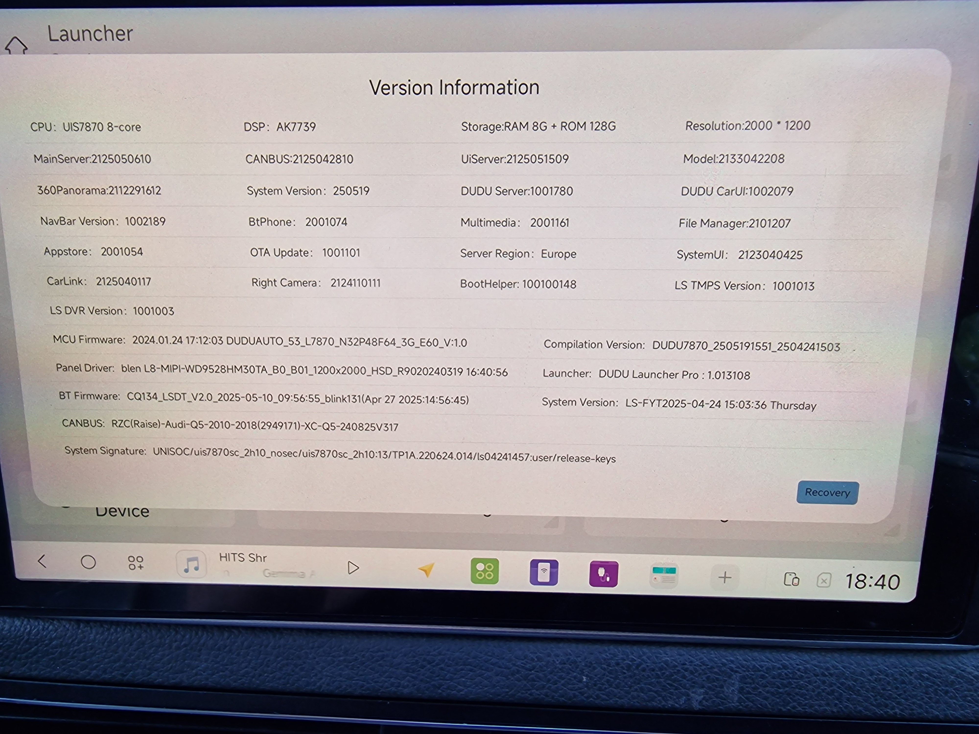

I ordered a dudu7 with wiring harness from your shop a few months ago, its had issues and im trying to iron them out. Your kit came with separate boxes the RZ-Audi-30 and the RZ-Audi-01.
The Aux worked correctly appart from occasional blips, but the parking sensors would not work. I have now fitted a harness from ali express from skyframes, this kit is with 1 box only, The parking sensors work correctly but the aux does not display at the correct resolution, You can only see 1/4 of the screen. I have tried going into vehicle personalization and the only option that can be changed is "Car screen settings" this does nothing! I have been in talks with the seller and he said the box auto sets the resolution but can be manually changed, Im at a dead end where and how to change it.
