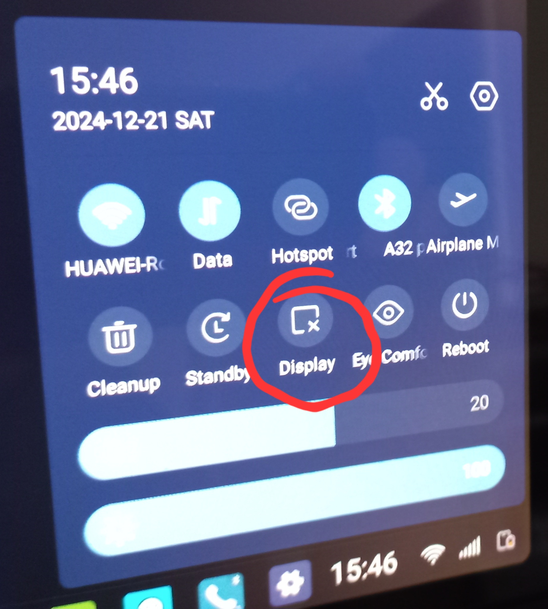

              is there a option to add the the system for future updates, to add a functionability to dark out the screen completly, and by touch of the screen to light it up again? so it wont generate any light in the cabin
                santino Tap on bottom right corner of the screen and then tap on "Display".The screen will turn off. For turn it on, tap on the screen again.
                  Robin that is it!
                  for what it is, this option is hidden, but hey when You know then its easy
