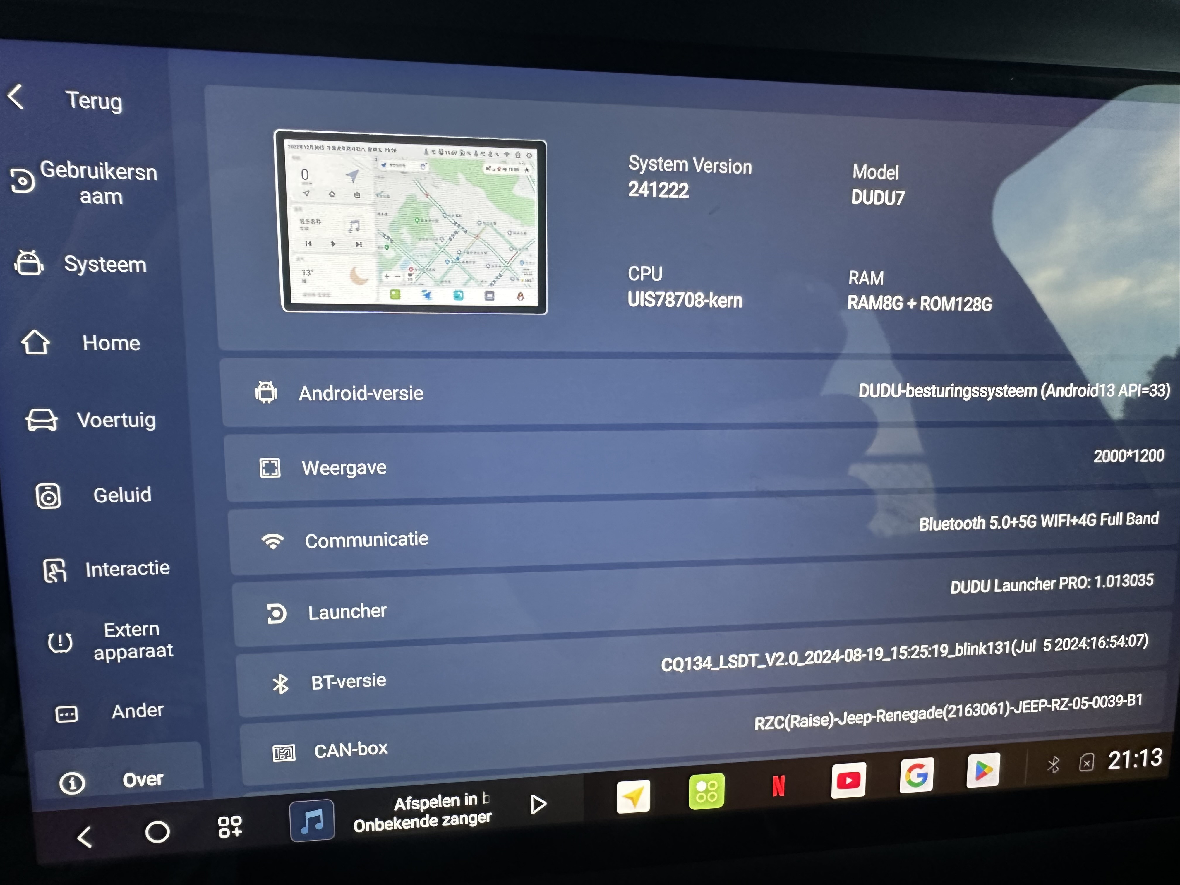

dudu-lai I99 The CANBUS box is working. Take a photo of the DUDUOS version information, maybe you can find a solution to the flashing mileage on the dashboard.

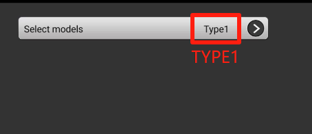

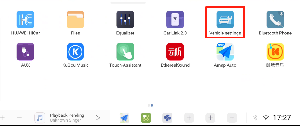

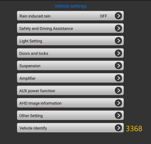

dudu-lai I99 Go to Vehicle Information > Vehicle Identification > Password 3368 > Select Category 2. After setting this, turn off the engine and lock the car for 10 minutes. Then try to see if the mileage display issue is resolved.

dudu-lai I99 Connect to the OEM head unit and test if these functions are working properly. If they are working properly, your CANBUS box is faulty.
