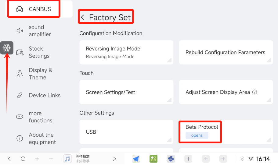

dudu-lai You can also download the Touch Screen Assistant APP from the App Store, then turn on the Beta protocol, open the air conditioner UI (snowflake icon) of the Touch Screen Assistant, and verify whether the air conditioner also has this problem.
