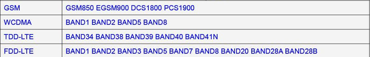

reg66 with some research ive found
DUDU unit supports 1,2,3,5,7,8,20,28A,28B,34,38,39,40,41N
Lte bands… .

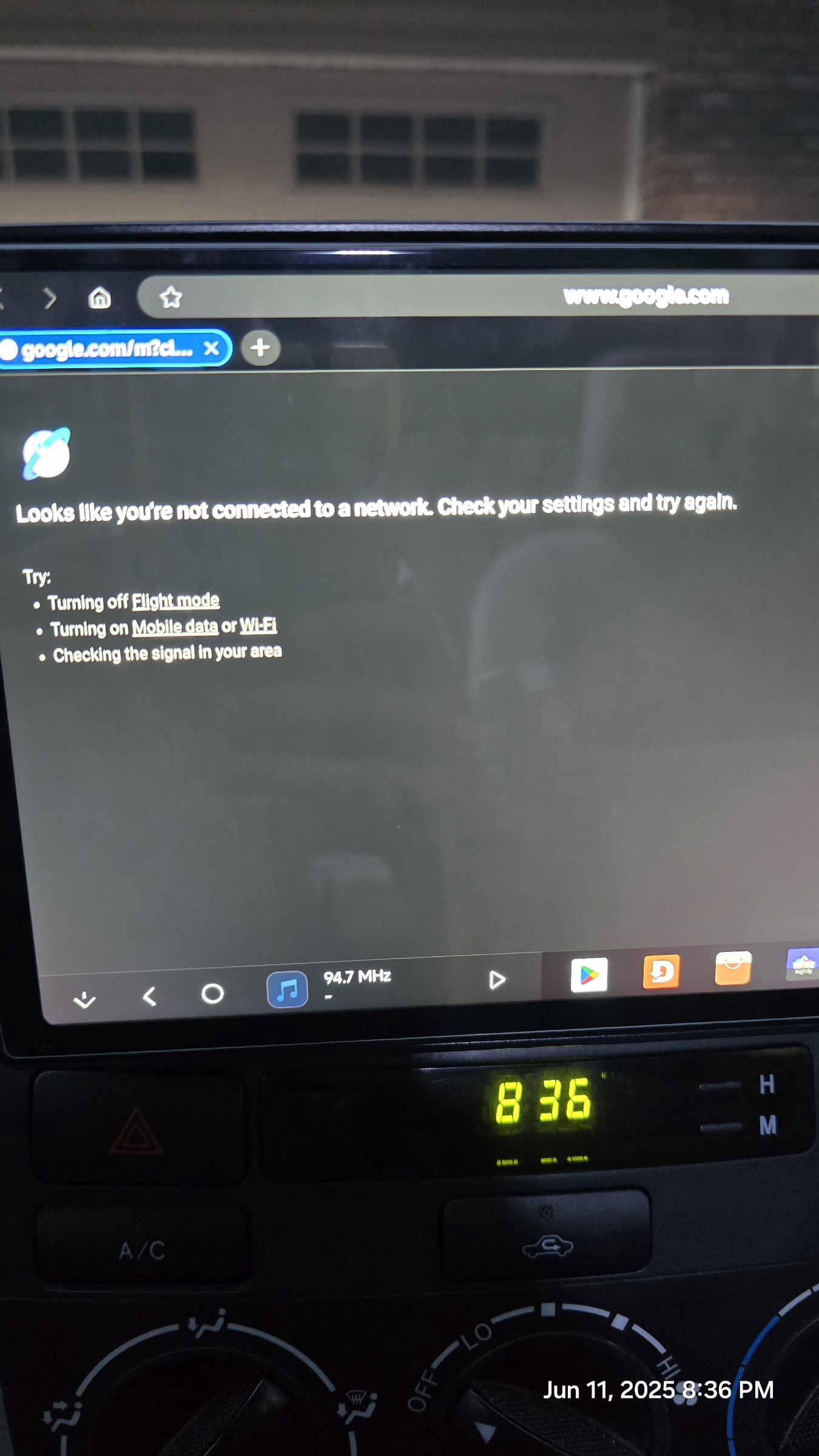

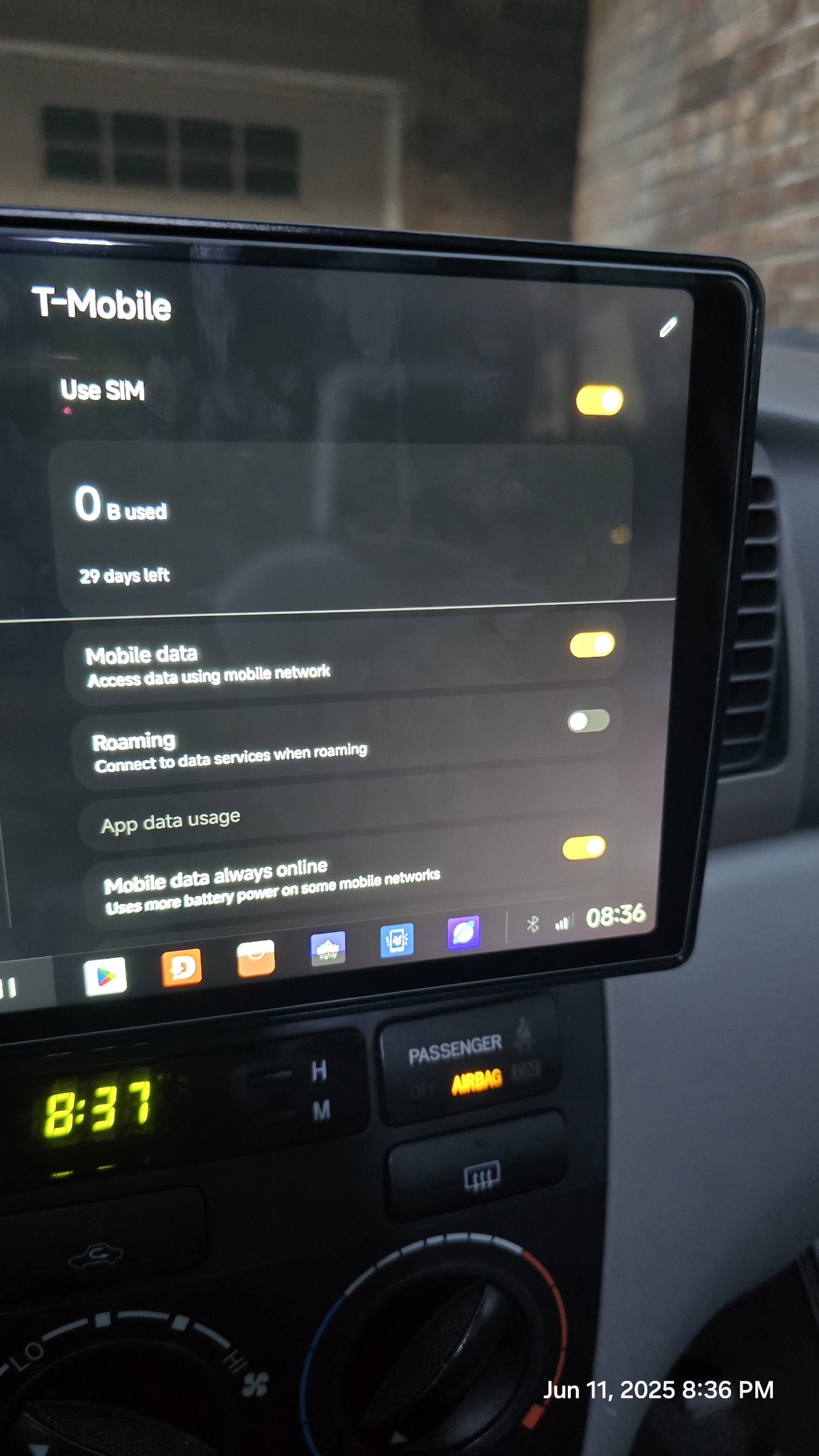

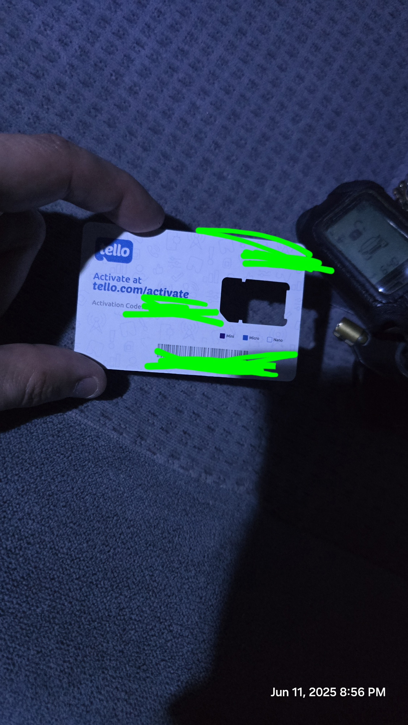

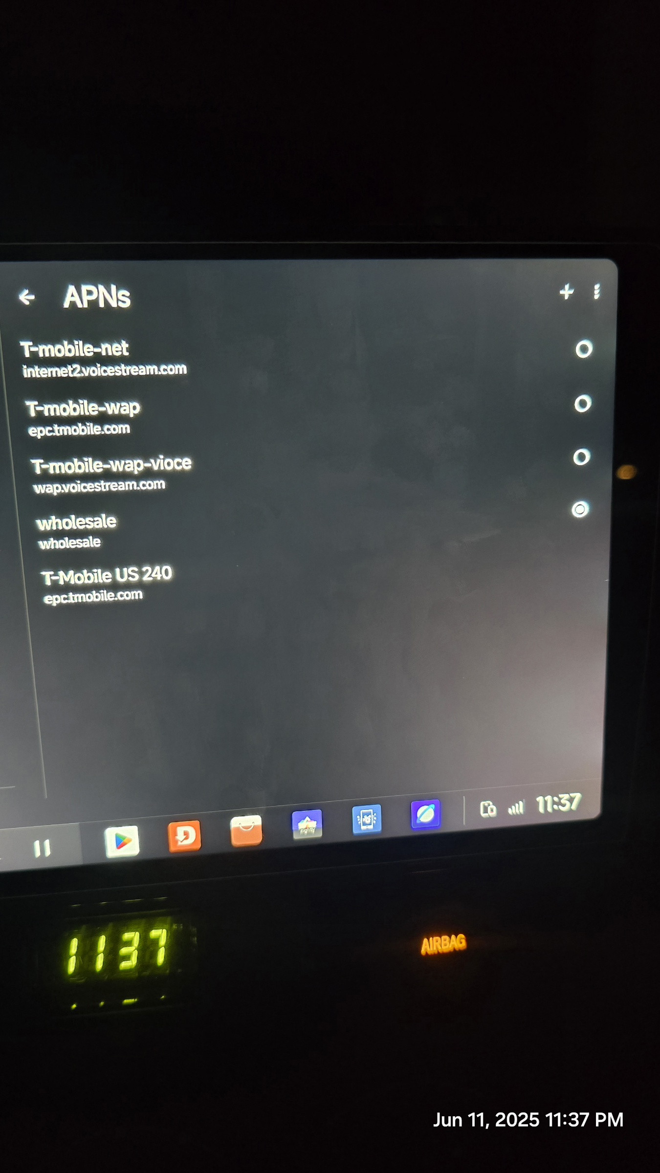

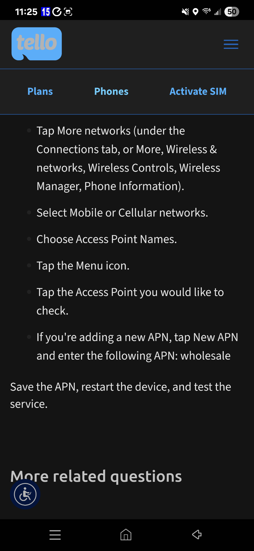

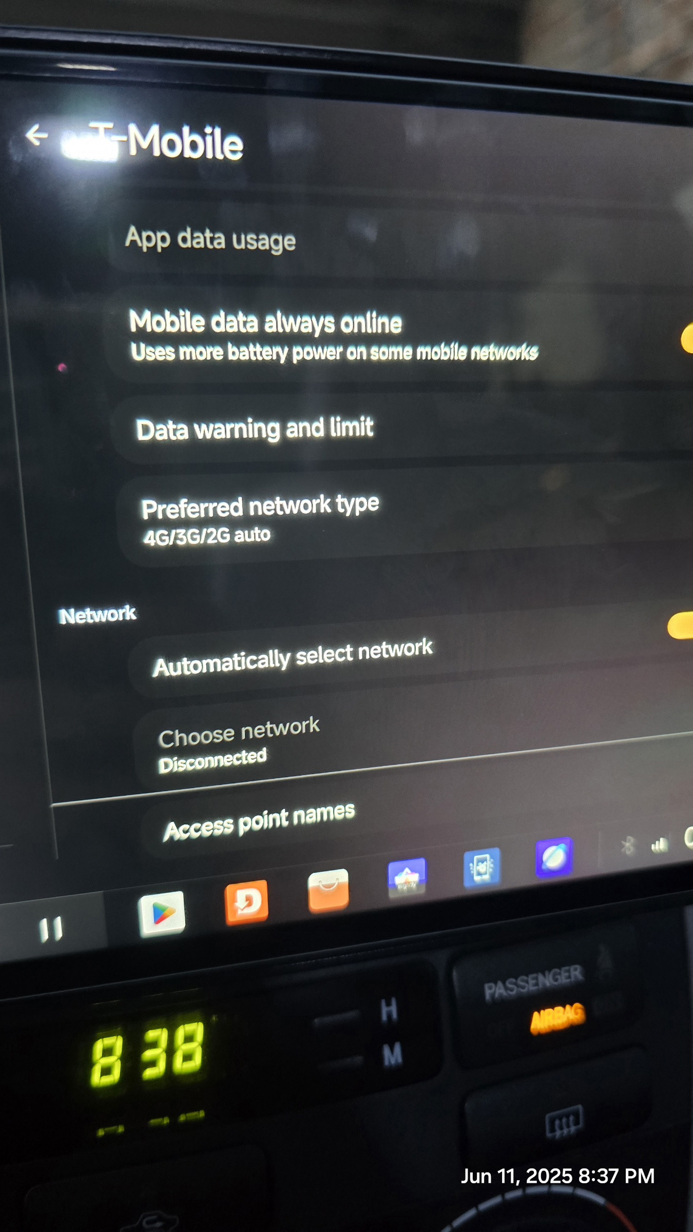

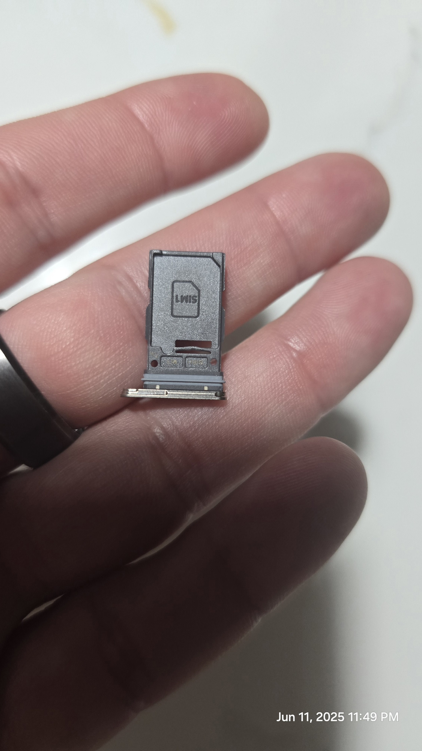

Im still a little confused because the tello sim that i am using runs off t mobile towers from what im seeing. It has no issues connecting/using data and only shares 2 of the same bands 2&5. One of them being not really. There are a few ACCESS POINT NAMES ( APN ) that this sim associates with.

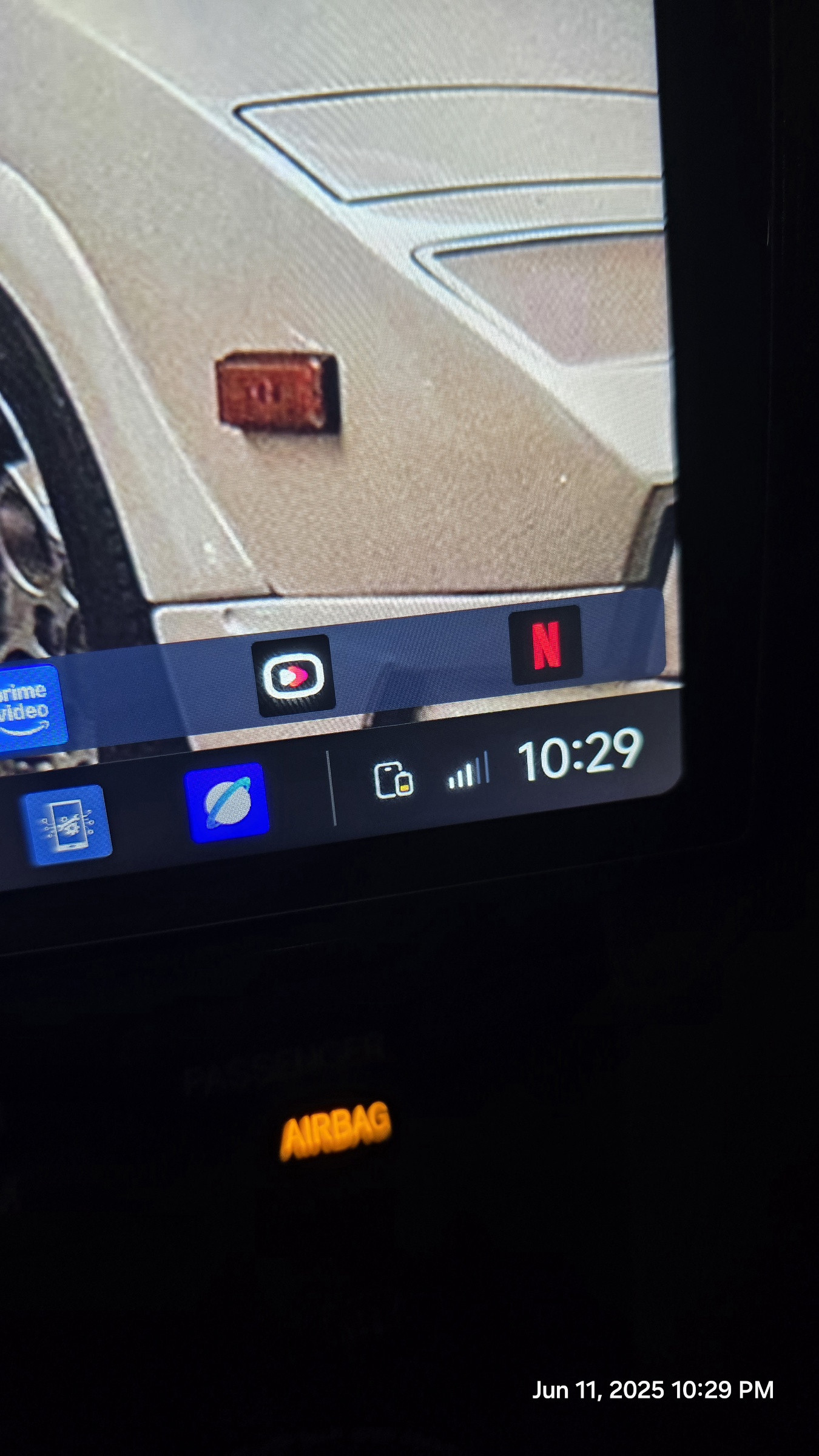

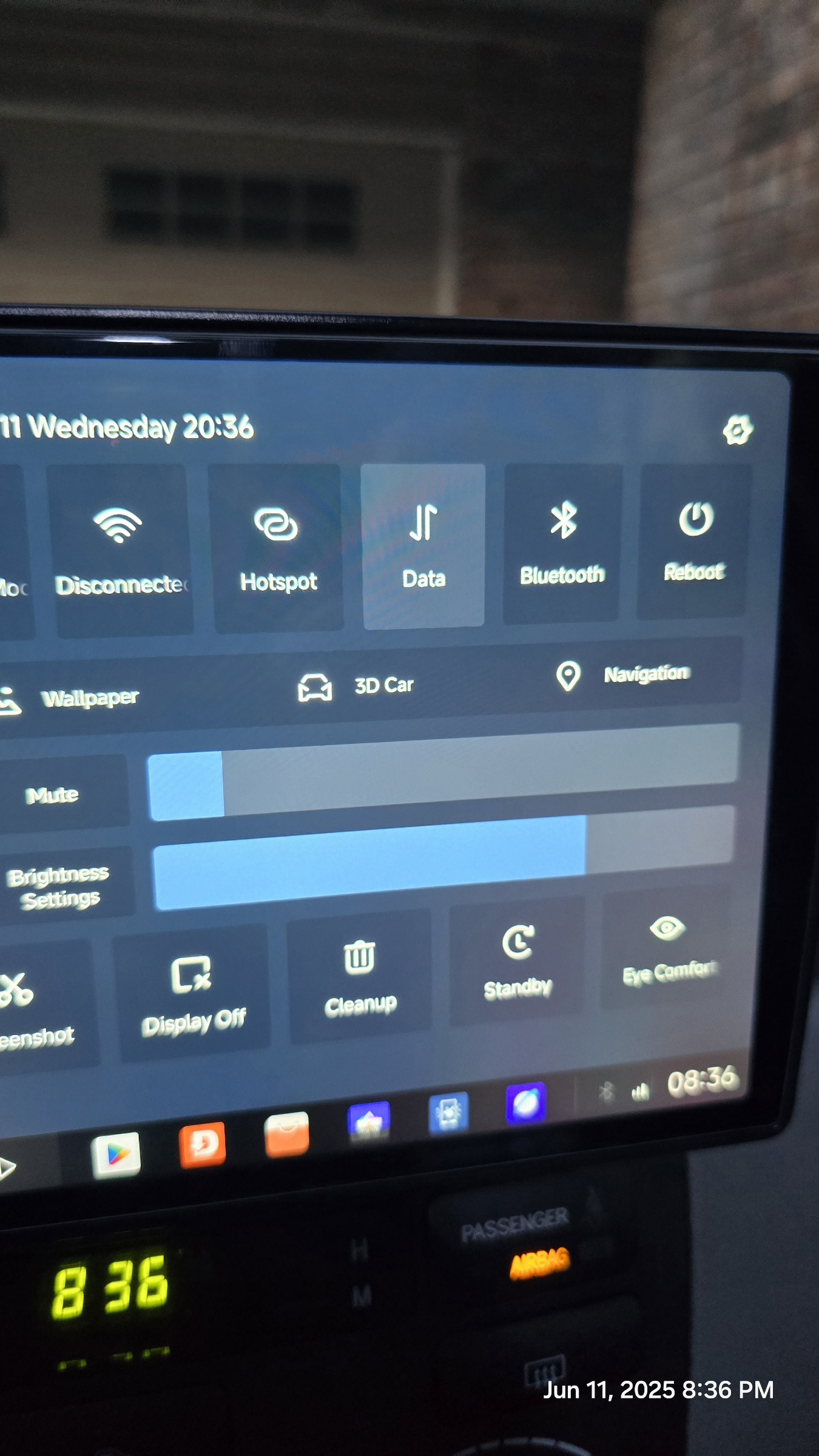

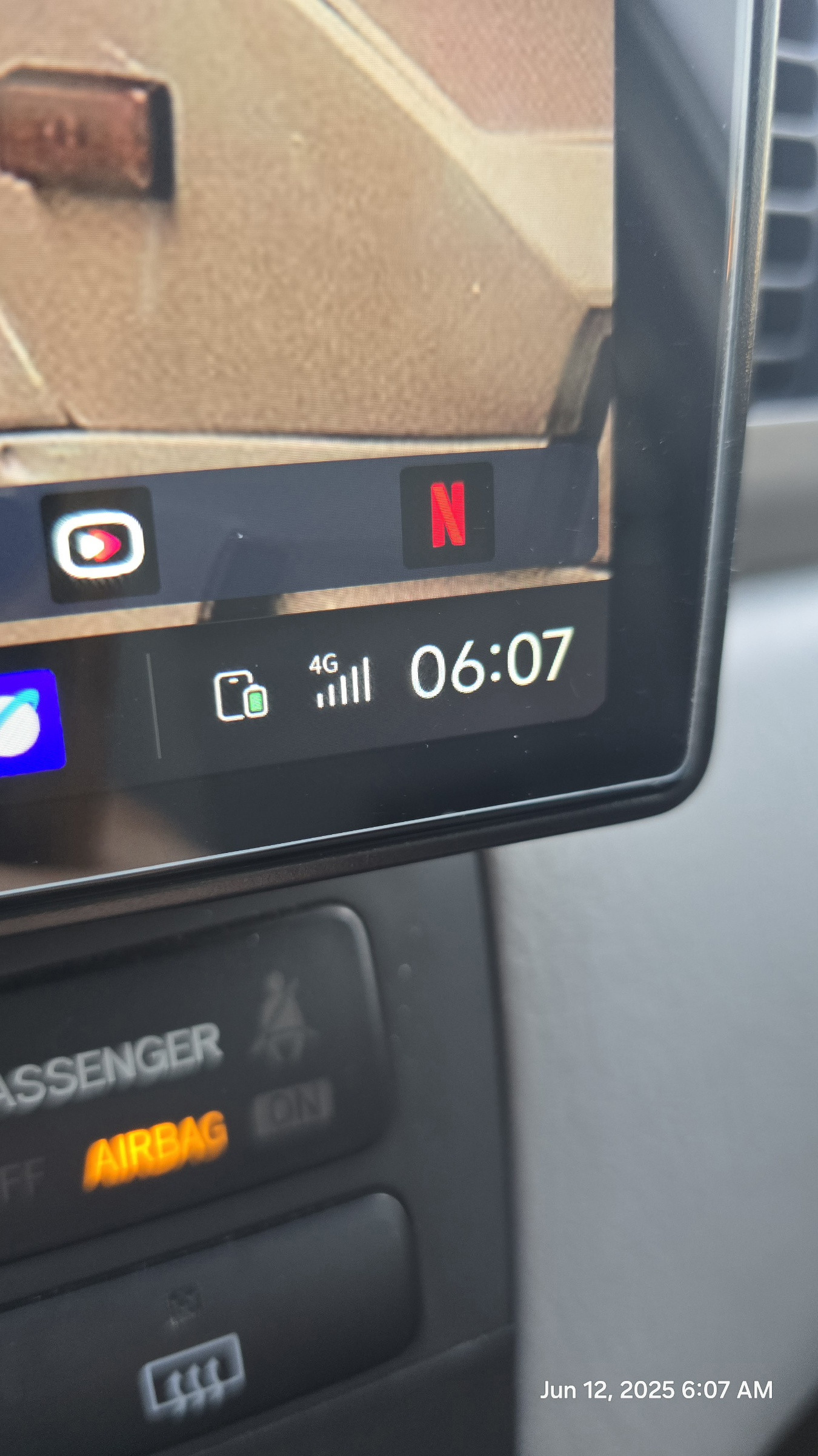

Now the verizon sim on the other hand uses the same 2 bands 2&5. It connects showing signal bars but no 4g shows. I cant use data. 15 min later 4g pops up and im able to use data but it doesnt seem reliable and drops the 4g signal only to search again taking forever to allow data usage. There is only 1 apn associated with the verizon sim.
For anyone that wants to see i uploaded a video showing the difference swapping out the sims on the spot. The difference here is $25 a month tello vs $10 month verizon. Both inlimited data. Verizon is my home internet and cell phone provider. This is why i really want to get the verizon sim to work if possible.
