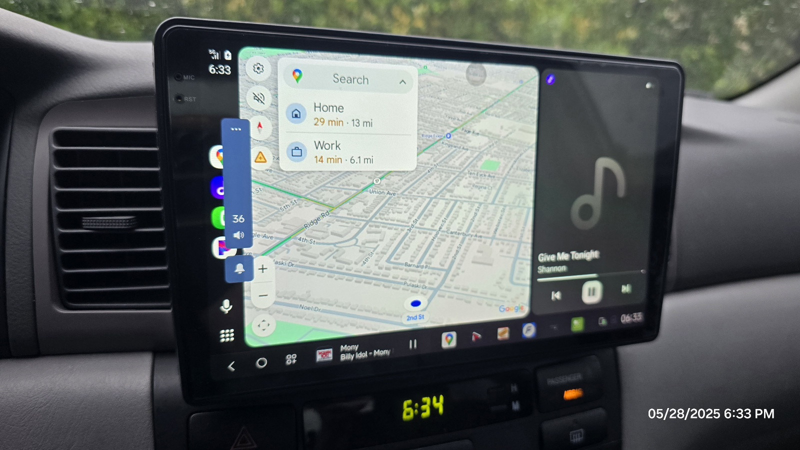

So finally finished installing the dudu7. One of the issues im having is poor volume. I cant enjoy the music. Volume is all the way up but its still very low. This is with windows up. With the front windows half open i wouldnt be able to make out the words. My pioneer unit sounded much better/louder with the same exact equipment.
My equipment is nothing special. 4 aftermarket speakers inside the car with 1 amp powering the sub in the trunk. There is no canbus 2008 toyota corolla ce. The radio does sound a little bit louder but any media i play thru android auto is really bad.
Any ideas?

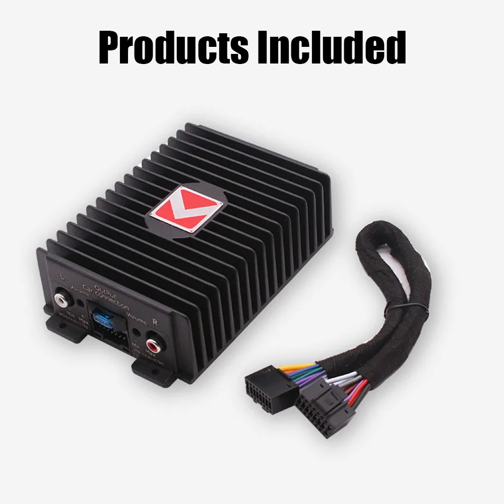

              robdx2 is that truely plug and play? What else is needed how does it connect?
              My car radio fuse is only 15 amp..can the circuit handle all the load?

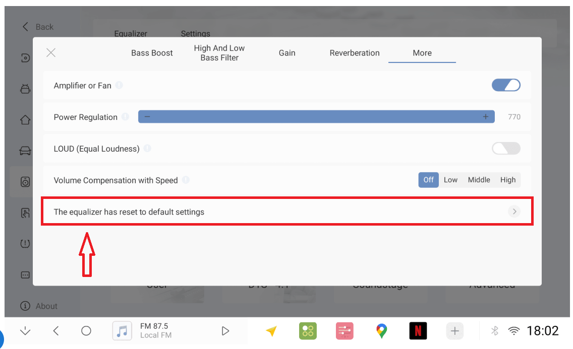

                I take it you've got the output turned right up under settings/sound/audio output/speaker power regulation?
                Mine is turned up to 490 (max on my Dudu7) and anything above 12 out of 30+ volume steps is way loud for me. My speakers are only 40W though.

                Failing that, I found certain settings in dts and/or lots of eq caused overall volume to decrease quite a bit. Now, in eq and advanced settings, I just have eq flat, sub gain up to max 10 and set high pass/low pass filter so that my speakers act as mid pretty much, tweeters for high and let the sub take the strain of most bass. Prevents door panel rattle too! Maybe it helps...
                Oh and also under the 2nd set of advanced sound settings (lower down), I have loudness set to on, to enable bass/treble freqs at lower to come thru
                  Hmm, my bad, I have got dts enabled 4.1 and volume output is still good

                    I had the same problem, I put the equalizer back to factory settings and the volume came back, now I'm careful about what I set.
                    Yes, I already have it on 490. Nevertheless, I still find it quiet. I will buy a power amplifier and try to compensate for it with it.

                    Skillzo1 Completly plug and play, I think my radio system fuse is only 10 amp and it works great. If you see the picture i posted above it comes with the cable shown in the picture. All you do is remove your power plug thats in your dudu unit and plug into one end of the dsp, then plug one end of the cable shown in picture into the other end of the dsp then other end of cable in picture back into dudu unit
                    Vehicle wiring > dudu wiring harness > dsp amp > dsp amp cable > dudu unit
                      robdx2 HUGE THANK YOU. I think ima have to try it. 😁🍻🤝
