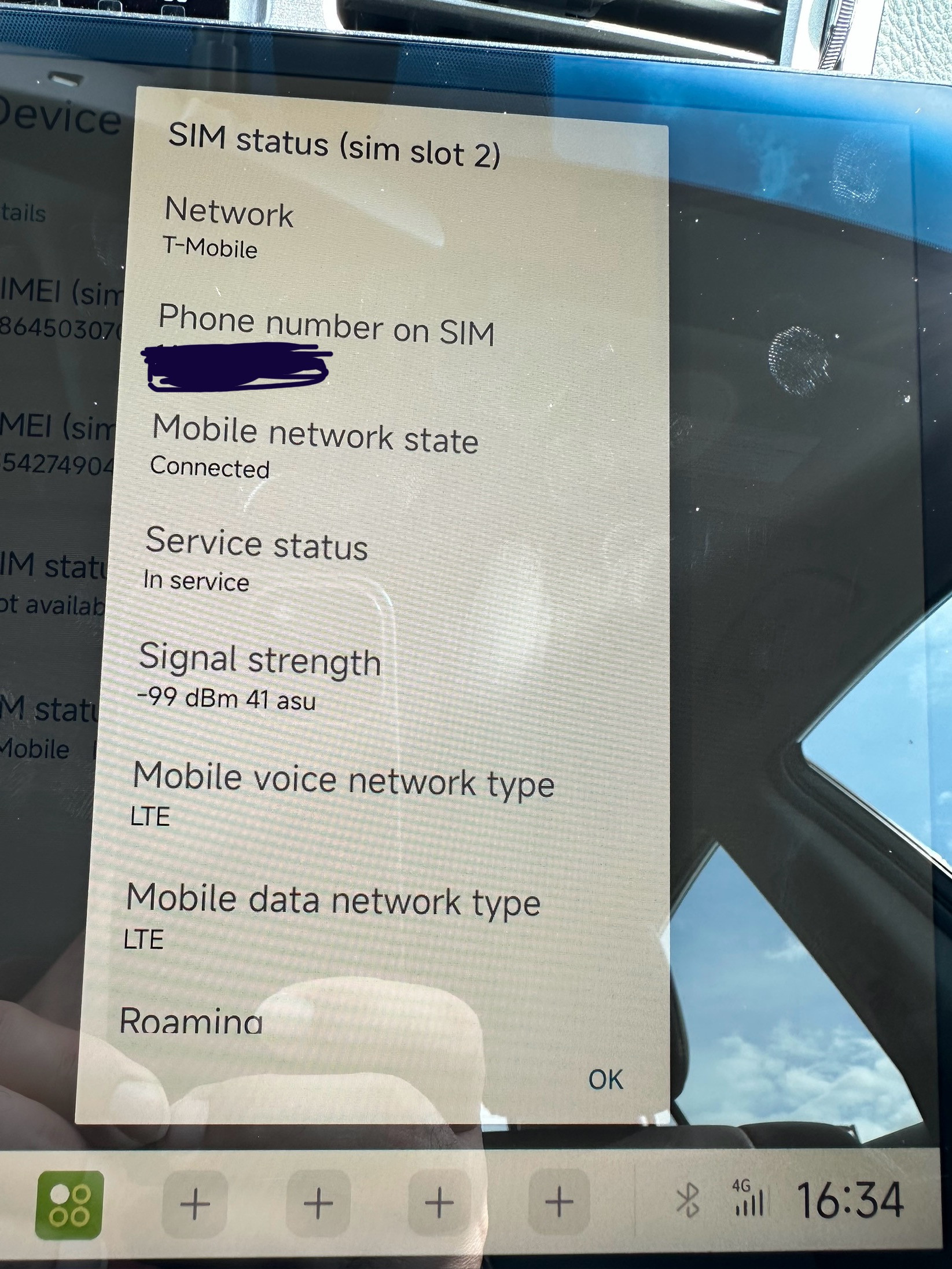

Dachoeks3 I have dudu7 unit and after upgrading to 3.6 my data does not work anymore. It shows as registered and signal strength is good but no internet. Worked fine on 3.5. Any suggestions? Edit: I did factory reset to see if it fixes it, didn't work.

Dachoeks3 Bladerunner666 yes, default apns are correct. I also re-downloaded update file and flashed it again and done another reset.
