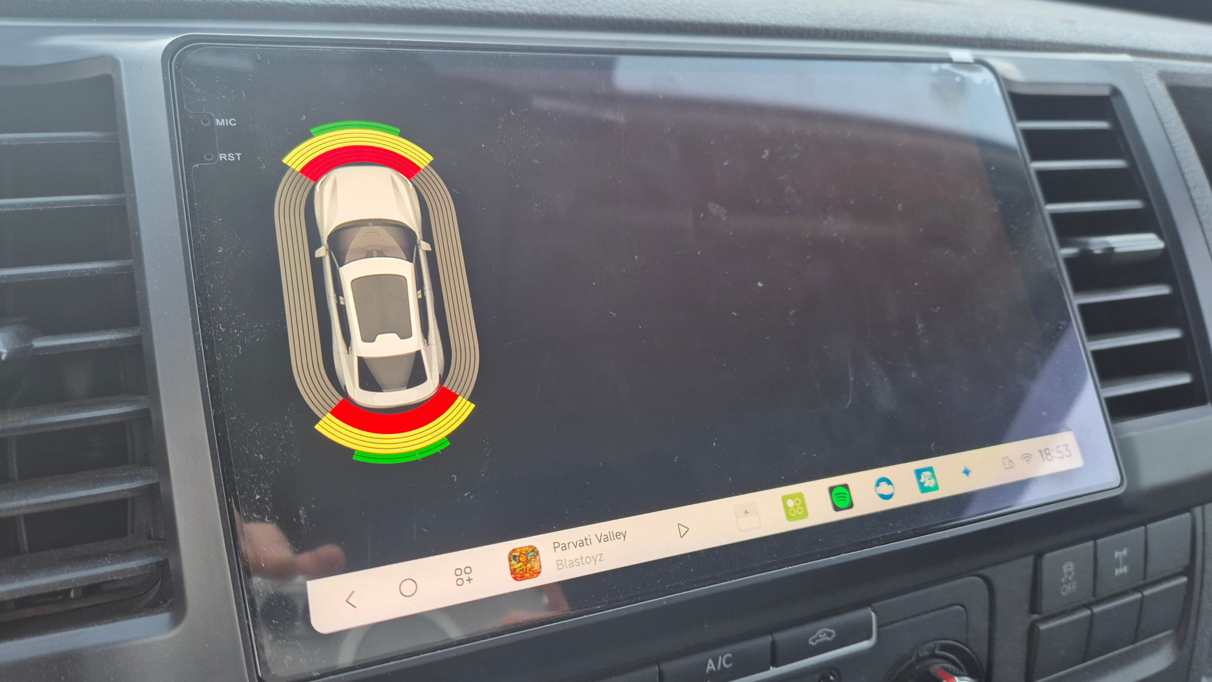

As shown on the video on reverse there are beeps correctly coming from the car, but the radar view is not updated. Other than that everything else including steering wheel buttons works well. It worked well on my previous noname head unit that I just replaced. Car is a 2016 VW T6.
What could be the issue?

The previous different Android radio had the reverse radar showing distance correctly, but Dudu 7 doesn't, as demonstrated on the video. I used the same CAN bus decoder. Dudu 7 doesn't work with my car's reverse sensors.
I have no camera, my issue is related to distance sensors only.

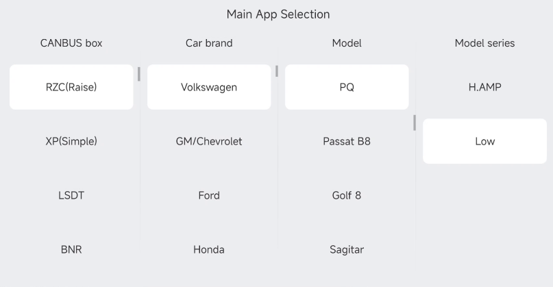

    Select this CANBUS to try

    Thank you, now I'm getting the actual distance metered.
    How can I disable the front view since I don't have a radar here?
