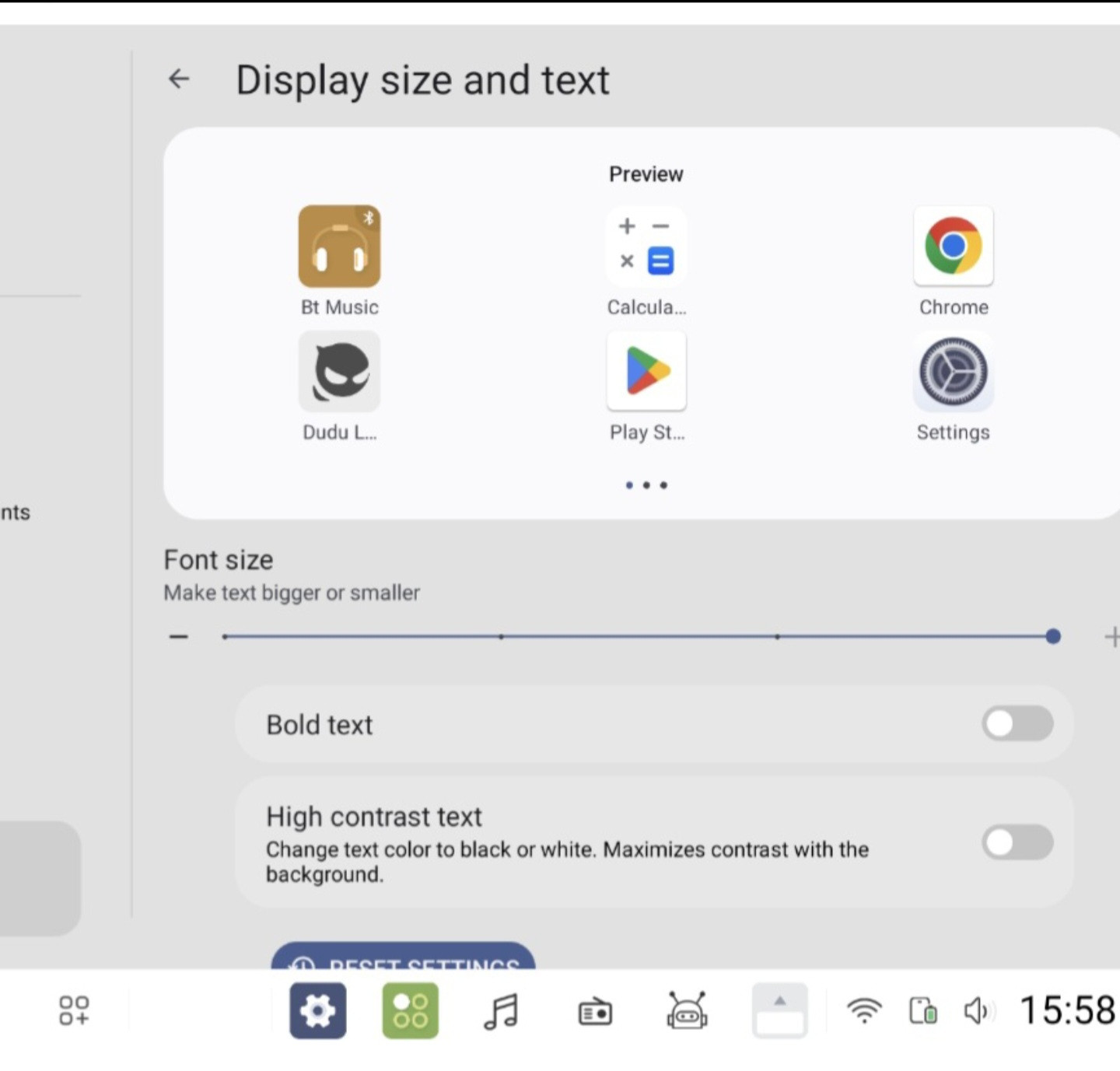

The software update is out, dudu 3.6OS /250519/. Has anyone updated their head unit yet? After the previous software update, for about 1 month, Waze was having a problem with a very small font size in full screen mode, I could barely see the navigation on my 10.1-inch screen. What about the current update, has the ability to adjust the font size been restored? If not, I would rather not download the new software. Does anyone have personal experience with this? Thanks in advance for those who respond. Regards. Ojika

Before the release of OS version 3.5, it was possible to adjust the font size on the head unit, which also affected the font size of Waze. My question was whether this setting option was returned to the program with the 3.6 update (See the sent image!) Has anyone had this experience?
    Ojika
    The setting you mentioned is the DPI adjustment, since the value has been fixed in config, you can only change it here for the current time, and the next time you turn on the computer, it will revert to the default.
    If you have to fix the DPI, you can use the generic DPI modification script, fill in the number you feel is appropriate, and use a USB flash drive to upgrade.
    This will help you, when you use it, note that you need to replace the bootstrap file with the most recent one available.
