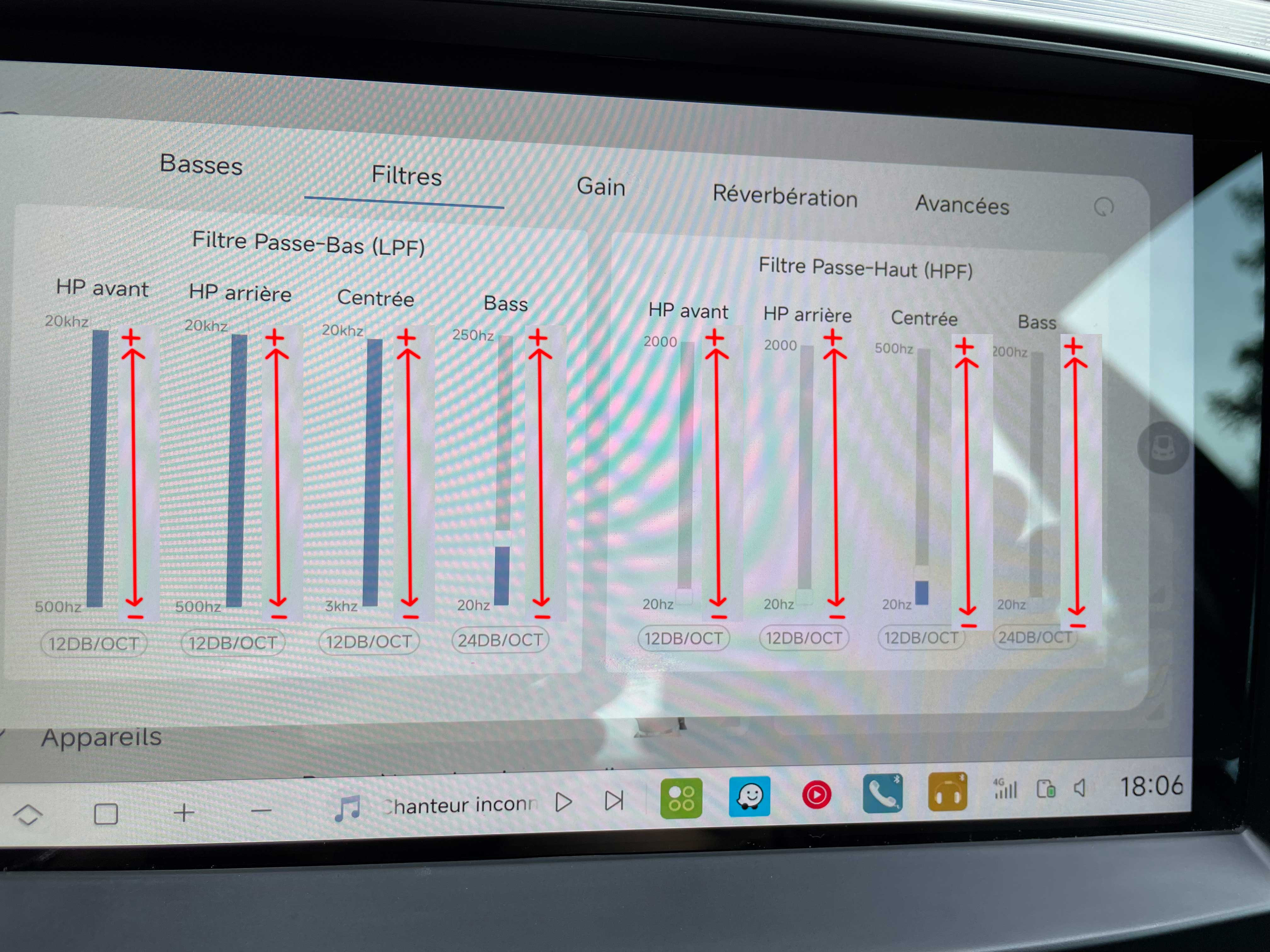

    Improvement suggestion – LPF / HPF filter :
    The current vertical slider for adjusting the LPF and HPF filters and DTS setting etc... is not precise enough. It would be very helpful to add buttons "+" and "–" to allow for more accurate and fine-tuned frequency adjustments. Right now, using only finger control makes it hard to set the exact value. Please consider adding this feature in a future update...
      Amin89 I agree, 100%. I also struggle with this when using the OS . I suspect there's a UI/UX programming challenge that's complicating the issue for the dudu team because its a very user friendly functional change that makes logical sense....

              picasso1850 can't set HPF at 80hz using touch, it always at 82 at closest. I agree that it should show + and - as well as the current Hz for the settings. For example I can only guess that the OP has 80hz subwoofer. Can see it anywhere that it is at 80.
