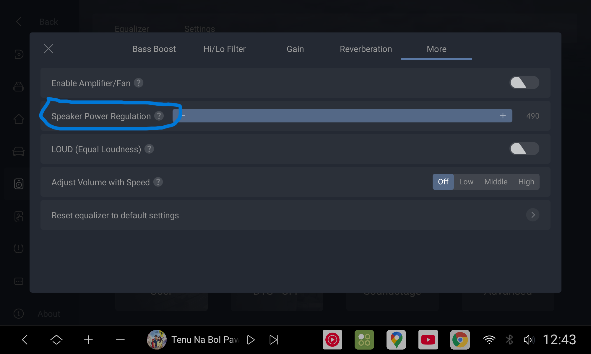

      applrsmacks Your car may have factory amplifier. Set the Speaker Power Regulation accordingly.

          abidali in the more tab the only setting I have is to reset the equaliser to default settings
          Alight I figured out the loud volume and I think the night light too just steeringwhell again
