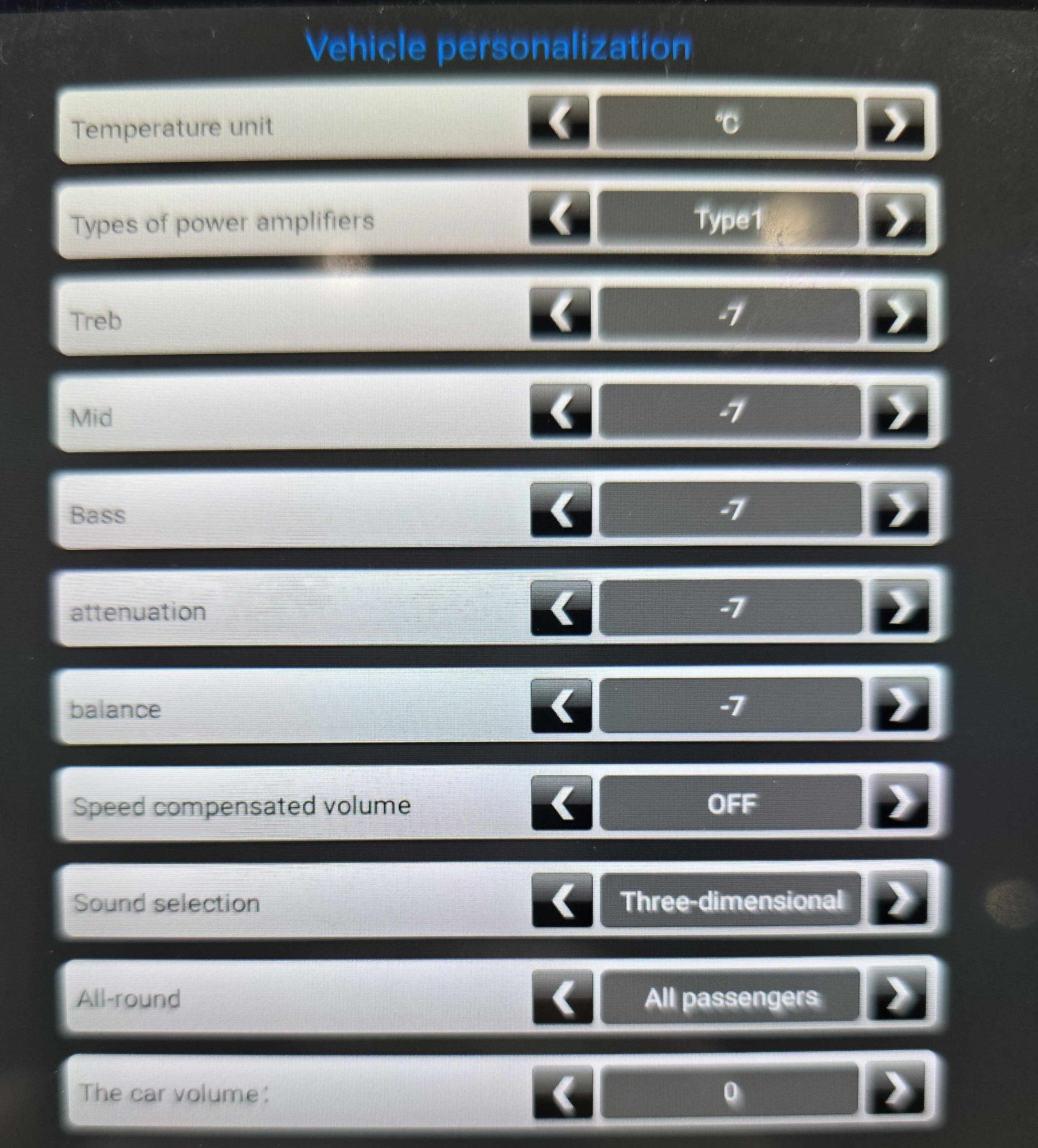

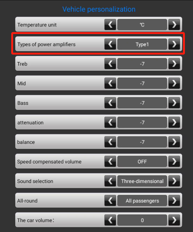

        80adid
        In the settings - try to change different AMP types, for cars with AMP, The car volume can not be 0!
        Also you can try to play music with the OEM host and turn up the sound, then connect to DUDU
        None of the settings in the photo can be changed, they are all locked. I did not set the car volume to 0 or any of these other settings. The OEM stereo works fine.

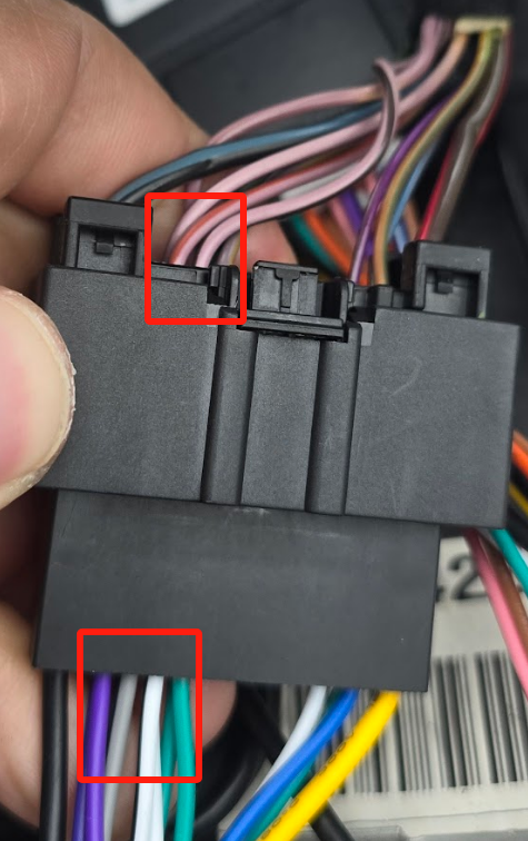

          80adid Do you have a photo of the CANBUS box? Pictures of the stock connector harness would be nice!

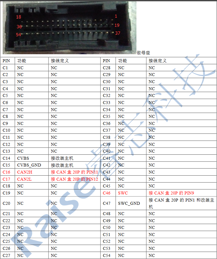

            http://www.szraise.com/Data/raisecar/template/cn_mobile/viewer.html?file=/Data/raisecar/upload/file/%E7%A6%8F%E7%89%B9%E6%8E%A5%E5%8F%A3%E5%AE%9A%E4%B9%89/FT082%E3%80%8A13%E7%A6%8F%E7%89%B9%E7%BF%BC%E8%99%8E%EF%BC%88%E9%A1%B6%E9%85%8D%EF%BC%89%E3%80%8115%E7%A6%8F%E7%89%B9%E7%BF%BC%E8%99%8E(%E9%AB%98%E9%85%8D)%E3%80%8119%E6%AC%BE%E7%BF%BC%E8%99%8E(%E4%B8%AD%E9%85%8D)%E3%80%8B%E6%A8%AA220401.pdf
            I did not find any information about the AMP of this vehicle in Raise's public information.
            Under normal circumstances, after the CANBUS works, the AMP will also start. But the AMP settings you adjusted in the vehicle settings will not take effect. This situation only occurs on vehicles without AMP.
            This phenomenon is difficult to explain.

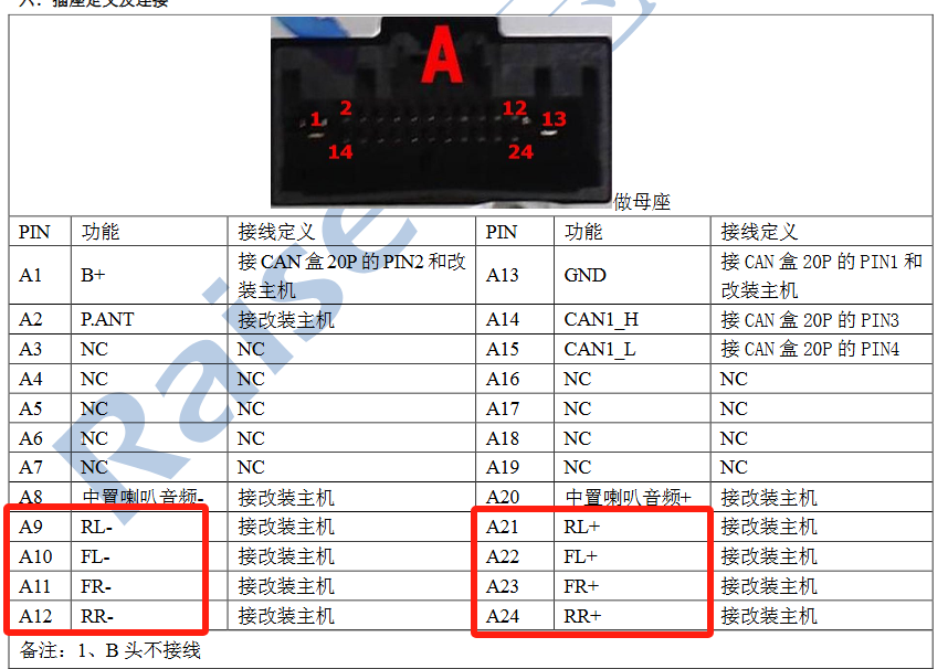

                80adid
                This is the audio output. Do you have any other Android radio device? You can try it.
                I can confirm that the stock SYNC3 stereo still works if I plug it back in but I don't have another Android stereo to test. I'm aware that these are the speaker wires but are they pinned incorrectly maybe?
                  80adid Audio is only on connector A. What do you think is wrong?
                  I don't know what's wrong but I still cannot get it to play through the speakers.
