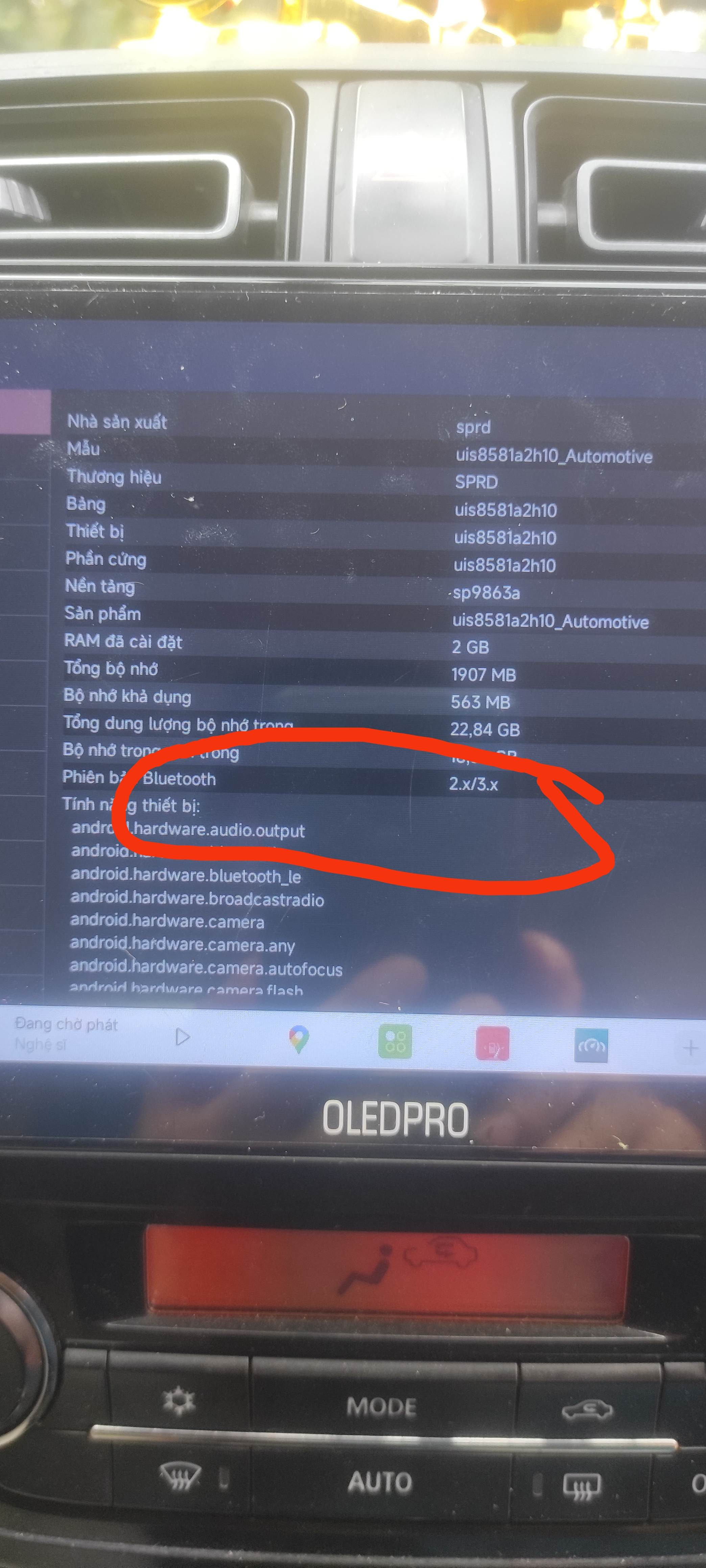

Pls help me. After I setup dudu, my head's Bluetooth ver is 2x/3x. All my device have Bluetooth 4+, so now I can't connect them with my head. Pls help me fix

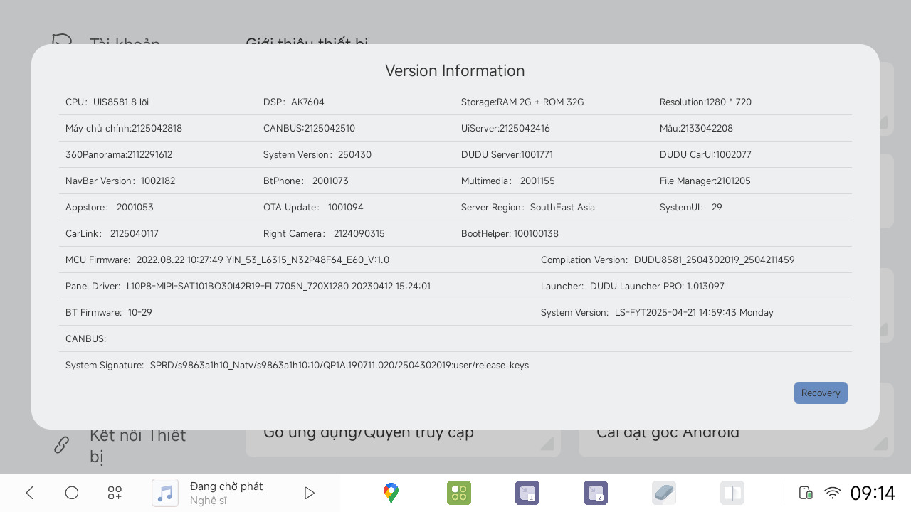

Settings, About, hold down the top left image. The system information screen that pops up takes a picture and uploads it here

      Bjnladjn @DUDU-Meng asked you for your "about device" info. Instead you provide a totally different screen. Please provide the correct screenshot. From what I see you have an 8581 processor. You can read on how to provide the right screenshot here

      Bjnladjn Settings, About, press and hold the upper left corner of the picture, the pop-up system information screen to take a picture and upload it.

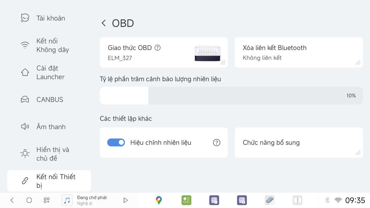

        When I connect obd it is null
        But I use torque connect it is OK

          DUDU4 uses this property, OBD you need an external device in the desktop settings to connect it.

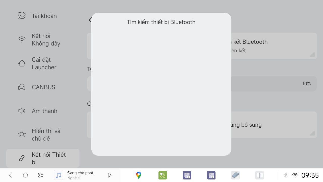

            Android Settings/Bluetooth 2
            Can you search for your OBD device here?

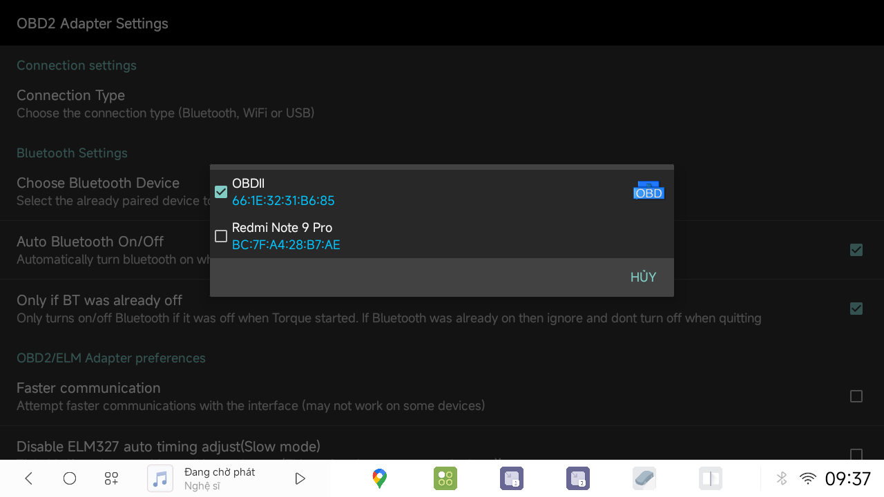

              DUDU-Meng I can see obd but it's can't to connect
                Bjnladjn
                You can see OBD in the Bluetooth search list, so you can click on it and select it.
                Check out this video for yourself, now all DUDU4 users don't have this problem you mentioned, bluetooth is normal.
                Please keep the firmware on its own bluetooth settings and don't try to change it.
