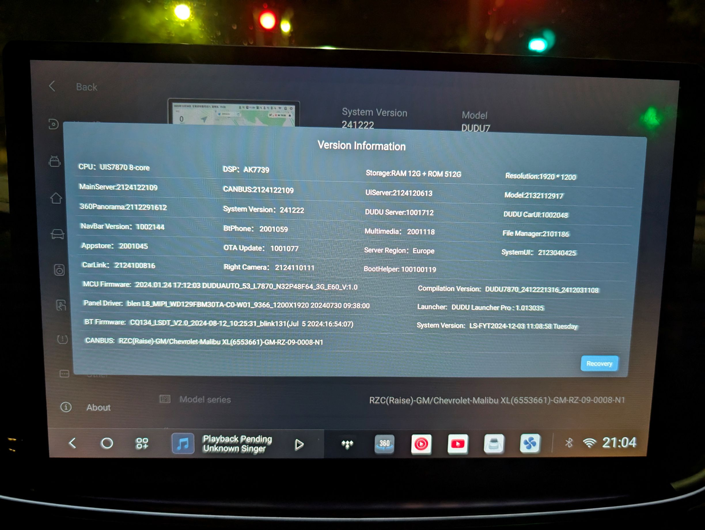

Head unit Dudu7, Canbus - raise gm-rz-09, car - opel Insignia sports tourer GSI 2020.

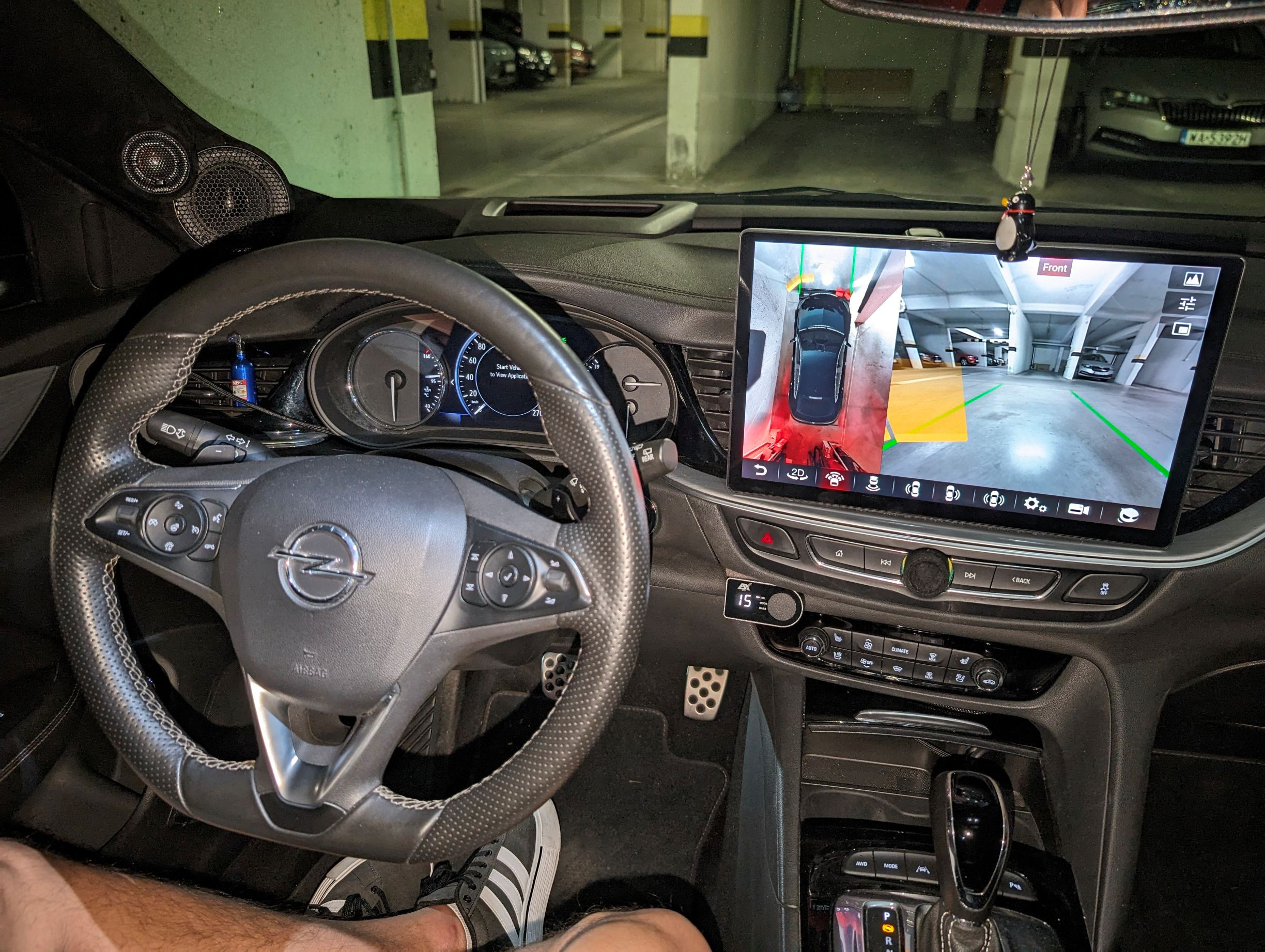

  • Parking sensors sometimes got stuck during movement even if there is no obstacle on the road anymore. It just continues to show colored bars next to the vehicle model.
Whichever I choose raise/gm/Buick regal regal GS, Malibu xl etc, these options worked just fine on the old HU

    Here is a video how odd parking sensors behaves. Remark - parking sensors on the factory display turns on and off correctly, but on the head unit sometimes it remains to show obstacles
    Sensor issue: went from nothing to something and got stuck. Can you get the 360 ​​panorama to always show and print the CANBUS log?
