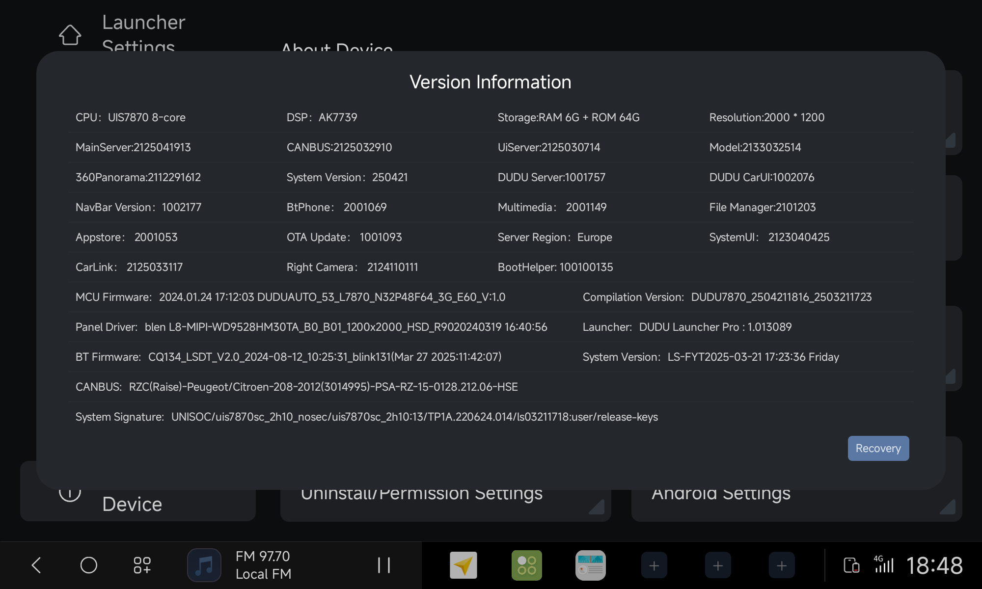

PLEASE please look into this as I cannot connect my phone to Dudu via BT at all. Obviously this is a fundamental requirement to allow phone calls etc to Dudu head unit. Please see attached photo of specs and BT blinklog for further info and let me know if there is anything more you would me to try.

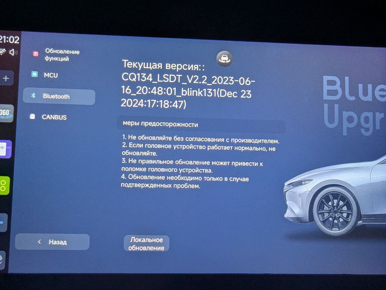

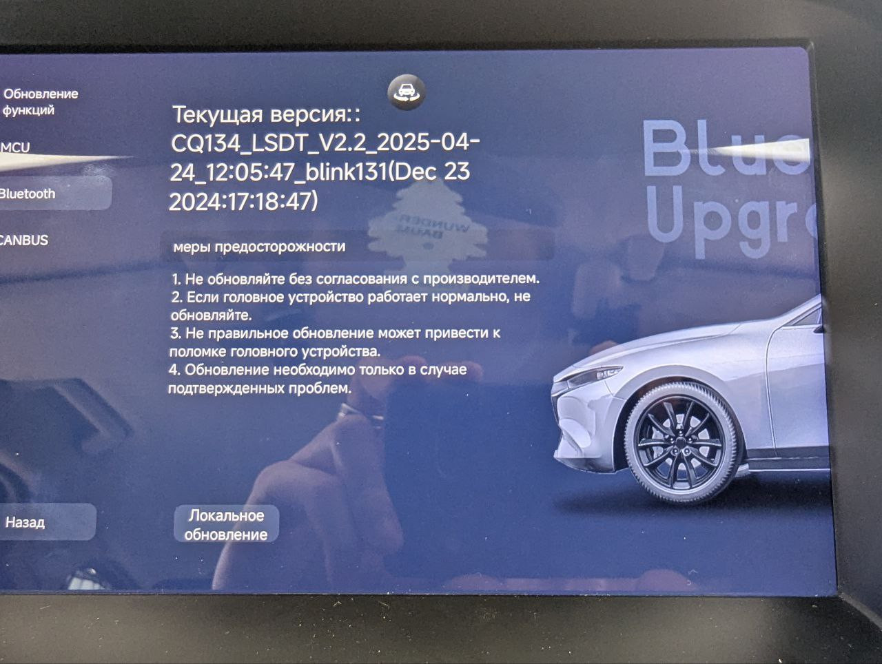

              I have installed the updated archive. I go to the System upgrade APP - More upgrade - Bluetooth firmware - Local update - and chosen 'blinkfile.bin'. Everything correct?
              But I'm still have the problem. After connecting the device to Android Auto when I listen to Youtube Music it freezes every 3 seconds. I think the problem is with Bluetooth that tries to reconnect every 3 seconds for some reason. Here is what I see on my Google Pixel 7 Pro device.

                Everything is fine, your DUDU6 has been upgraded with bluetooth firmware 20250424
