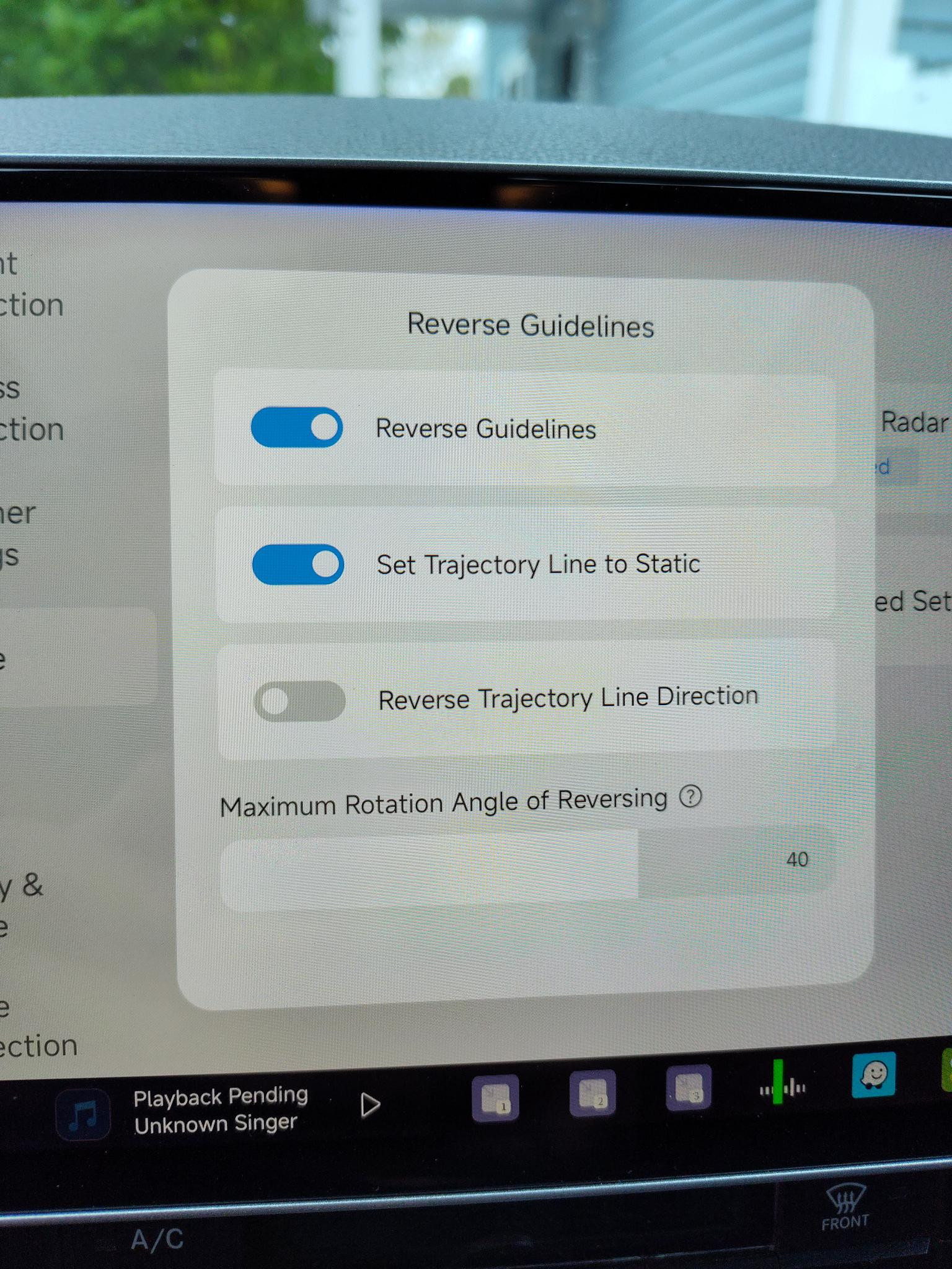

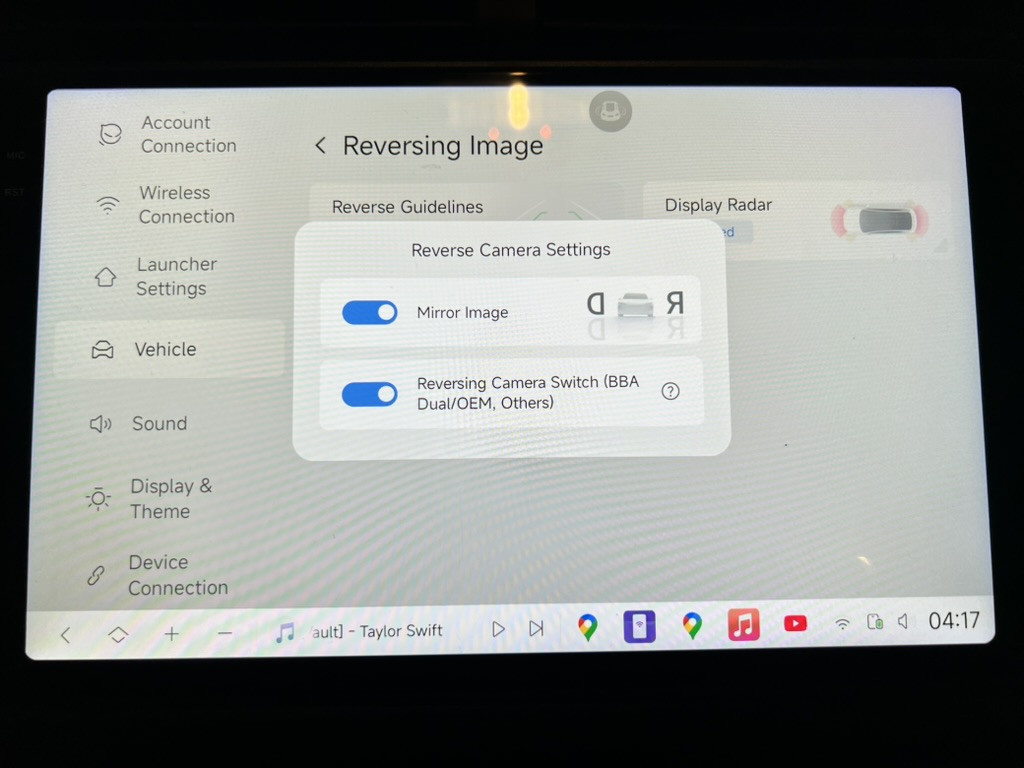

      hizzledizzlemizzle sorry, a lot has changed since previous UI. try vehicle> reverse camera > toggle 'set trajectory lines to static'. Prob not a canbus firmware update

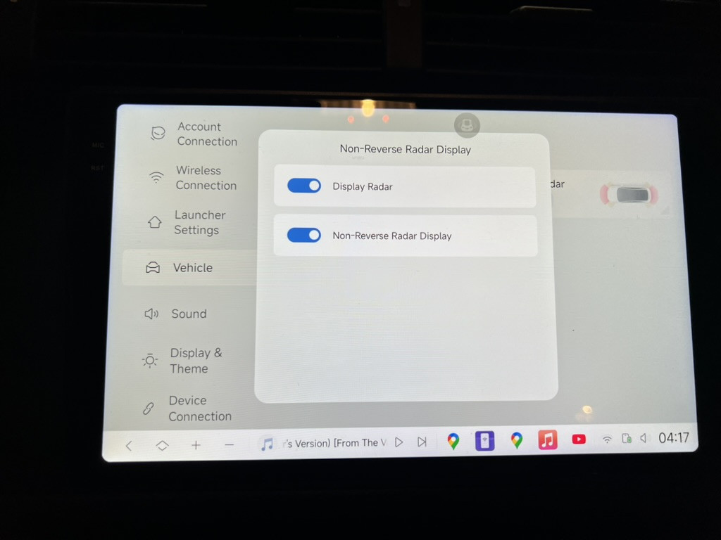

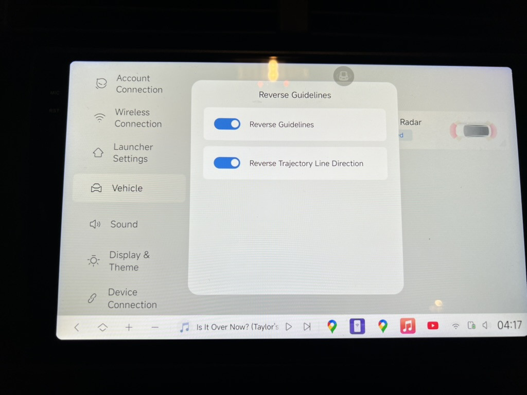

      Thanks again for the response. I don't see an option for trajectory lines anywhere in the vehicle settings (or any settings). Below are screenshots of the only things that are even remotely close. Am I missing something?
      Sorry, I can't help any further. Might be a canbus integration thing, though. Here's a shot of my view. Incidentally, my OEM camera didn't have dynamic lines but after installing the dudu7 I actually gained the functionality! A pleasant and unexpected option upgrade, lol.
      Thanks again. Weird that mine isn't showing up. My car has a steering angle sensor, and it definitely goes through the canbus. Also, I think all the other functions of the canbus work on my DUDU7 (doors show open/closed, turn signals, reverse indication, etc.).
      Anyone know if there's a software setting I need to change to active the "set trajectory line to static" option above?

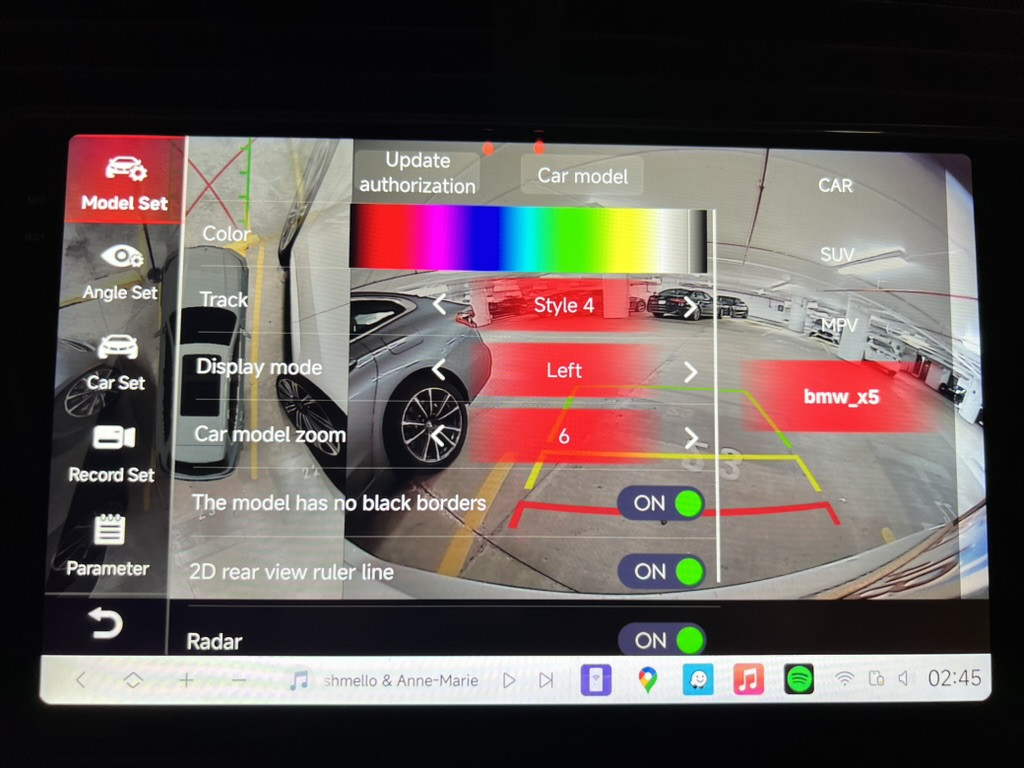

        hizzledizzlemizzle In the settings of 360 panorama - track style - is there a choice?

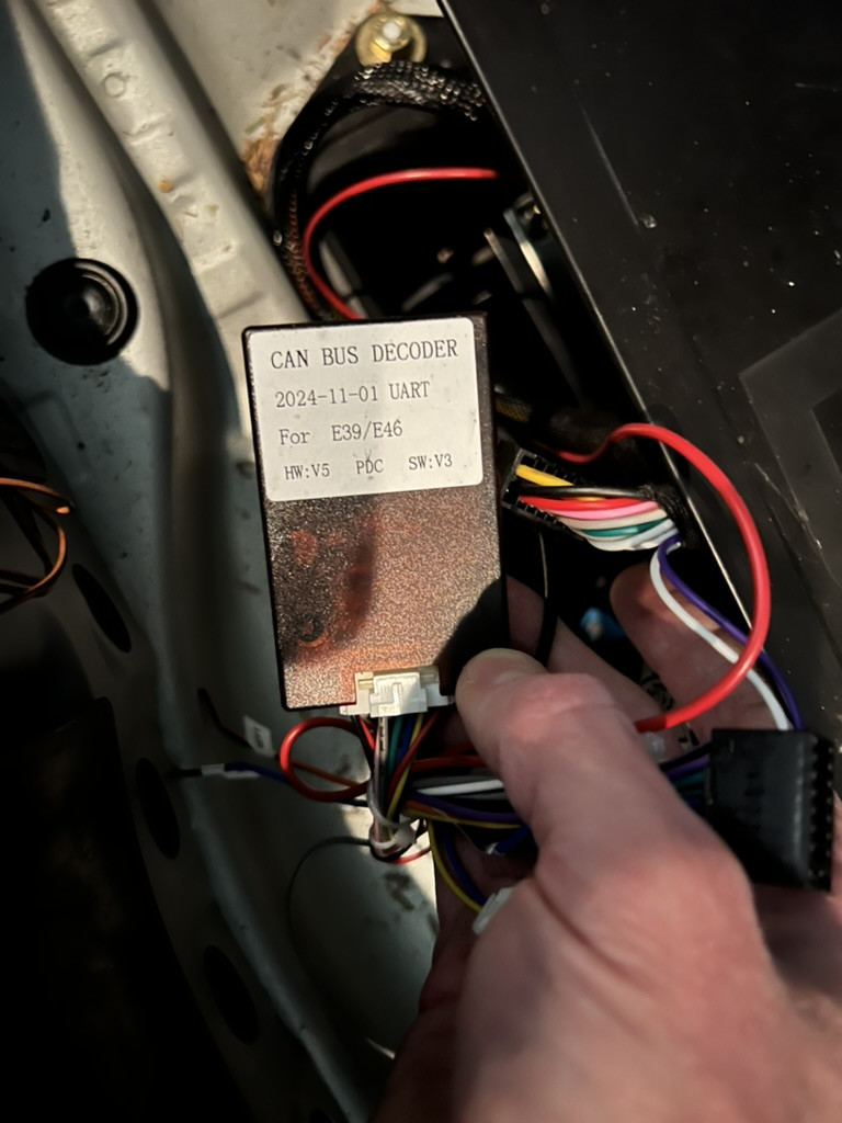

        What brand of CANBUS are you using?
        I have quite a few options in the track style (5 or 6?):

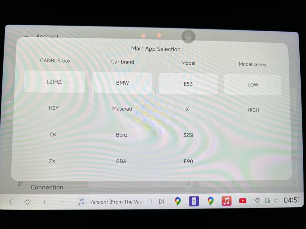

        Here is the canbus I have, which was sold in a kit for my 2005 BMW X5:
        Here is the setting I am using in the vehicle > canbus (I have also tried all E53/E39/E46 combos with high/low):
        Any idea why I can't get dynamic lines?

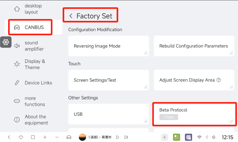

          Thanks. I tried to follow the instructions in your link, but I can’t fine the “print stock vehicle canbus” option (I have the beta4). Where is this?
            hizzledizzlemizzle

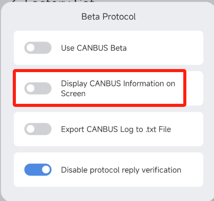

            Thanks. I have set that and also the selection to export to a txt file, but it doesn’t seem to export anywhere. I have checked all folders. Is this saved somewhere different to in beta4?
              hizzledizzlemizzle Generate a CANBUSLog folder in the root directory of the file manager.

              I am able to display CANBUS info on screen, and when I turn the steering wheel, it appears CANBUS data shows up on screen. Are there any settings such to make the "Set Trajectory Line to Static" option in Reverse Guidelines show up?

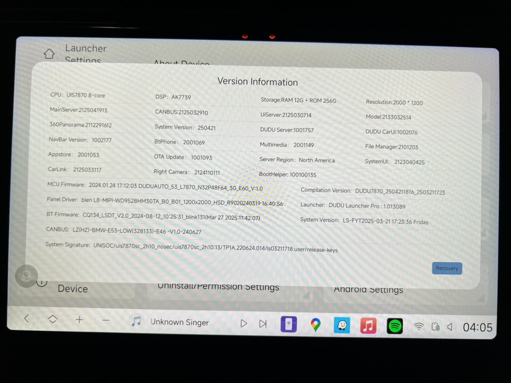

                4. System Information:
