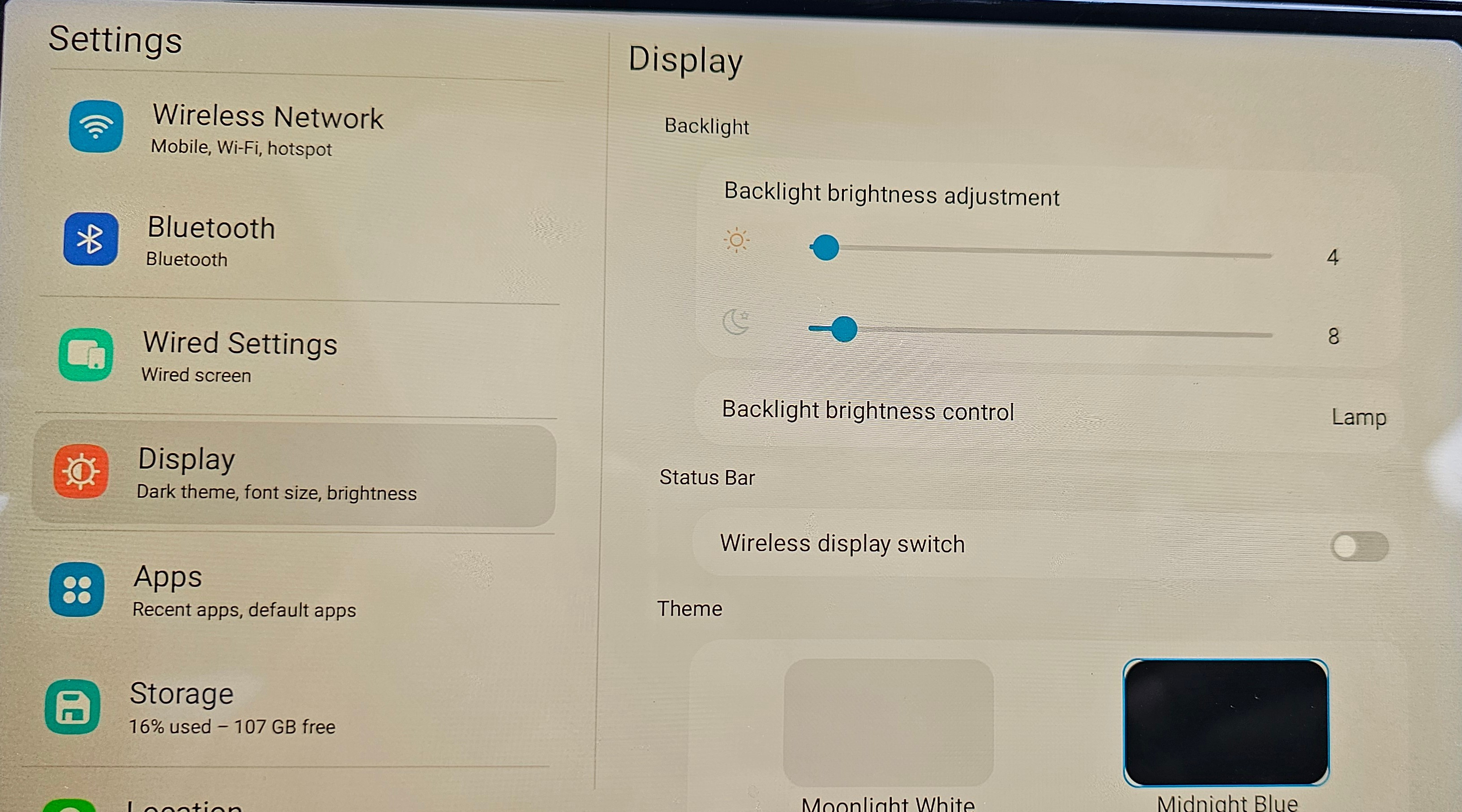

      falstaff In “Android Settings” - “Display” - “Backlight Control”, is it the light or the time that is selected?
      It needs to be selected as light
        dudu-lai it is set to "Lamp". There's no "Light" in that menu:
          falstaff
          Already set to light

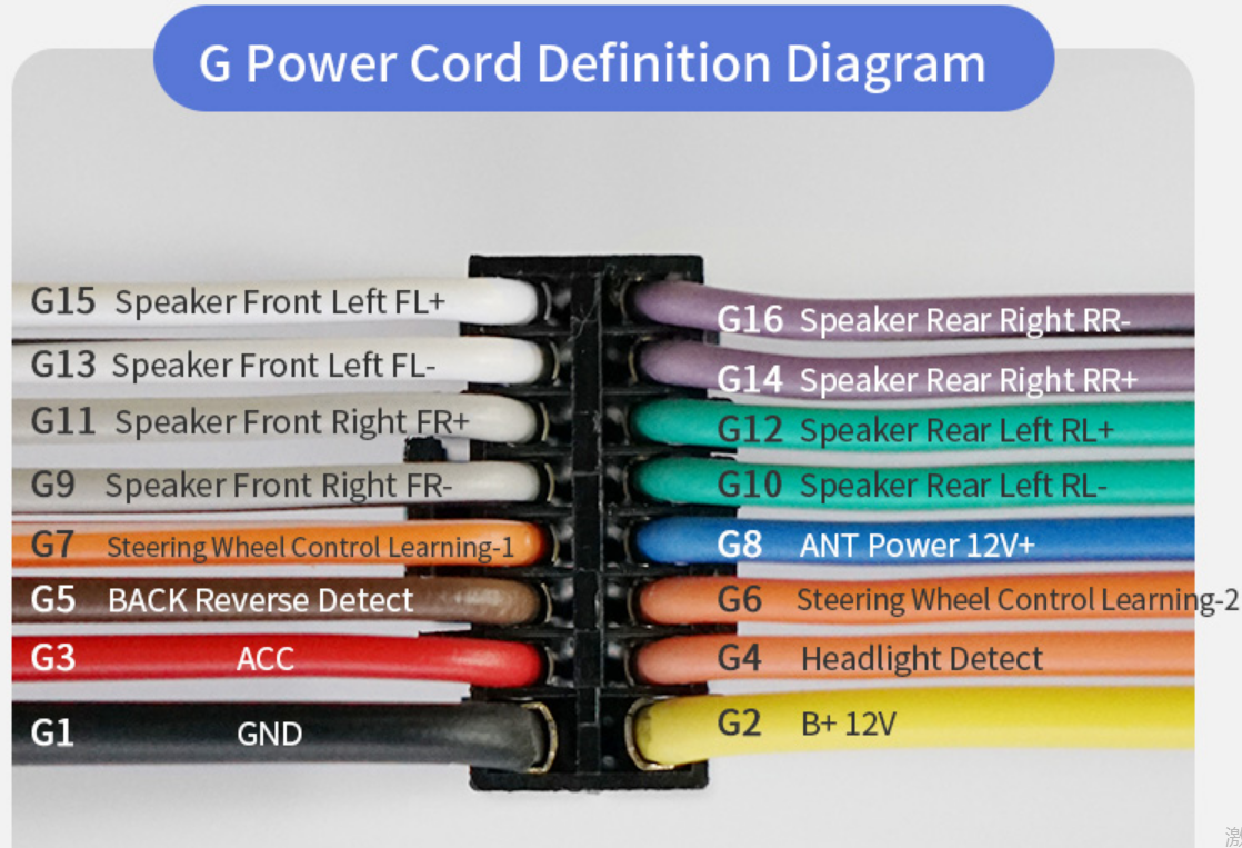

          In “Settings” - “Desktop” - “Day/Night Switch”, select “Light Switch” and set the “Day/Night Theme”.
          If it does not take effect, measure whether G4 of the DUDU G connector is connected to the light switch.

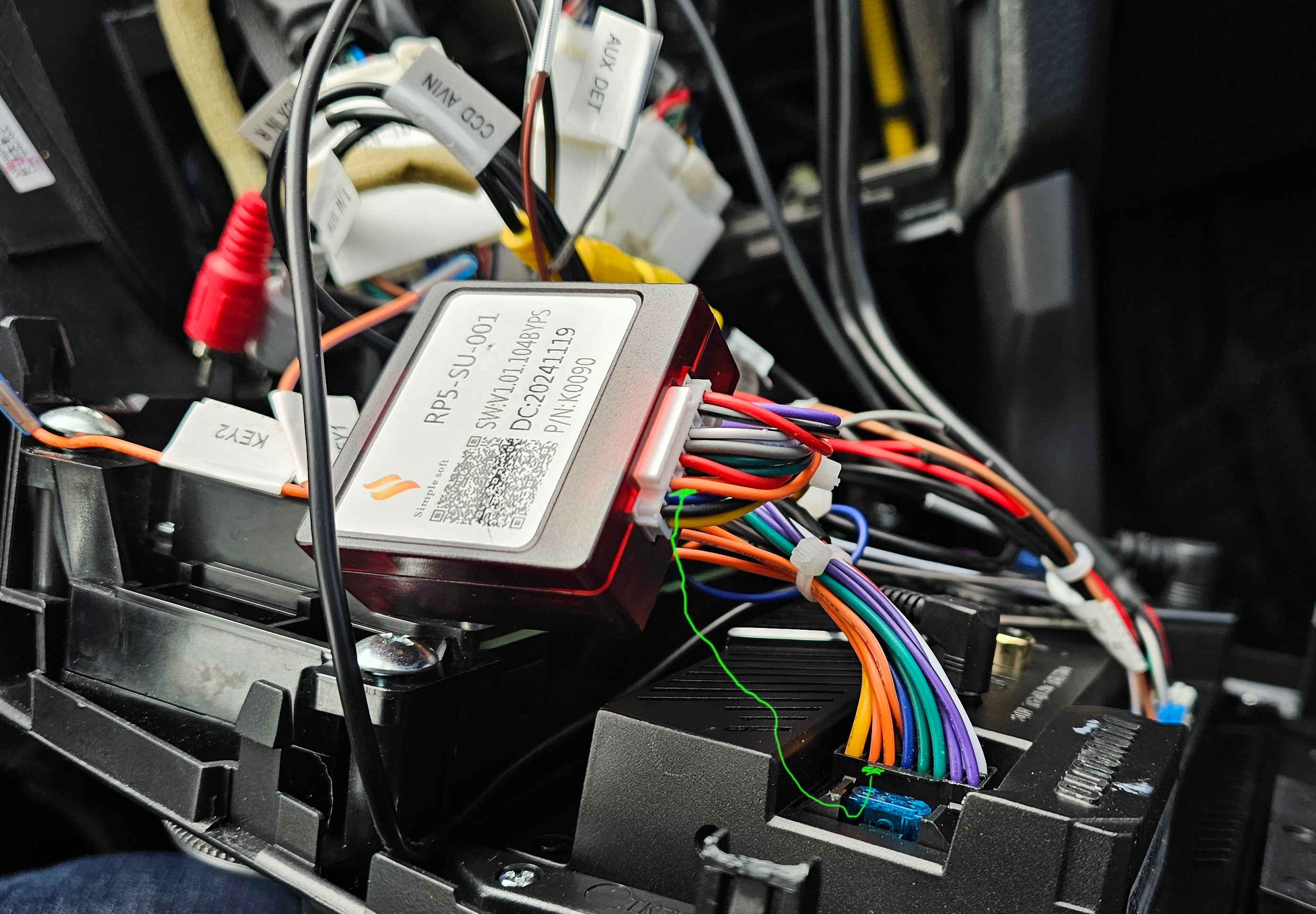

            I've already tested setting the “Light Switch” to “Day/Night Theme”. It has no effect. For now I manually use the Day Night button as recommended by @UK_mook.
            G4 is connected to the Canbus decoder. See the green line I've drawn in the photo below:
              falstaff Can you measure if there is a switch cable for the lights on the stock connector? Connect it to G4.
