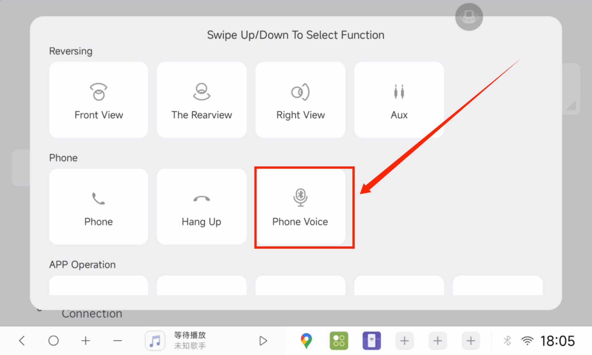

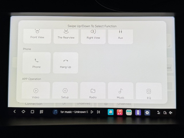

      DUDU-Meng On my Dudu7 with DUDUOS 3.6, the SWC Click To Learn only has only "Voice" command, I couldn't find the "Phone Voice" command under Phone. Do you know how I can bring out the "Phone Voice" SWC command?
        Al-Stallman
          DUDU-Meng On my Dudu7 3.6, I don’t have the “Phone Voice” command.
            Al-Stallman

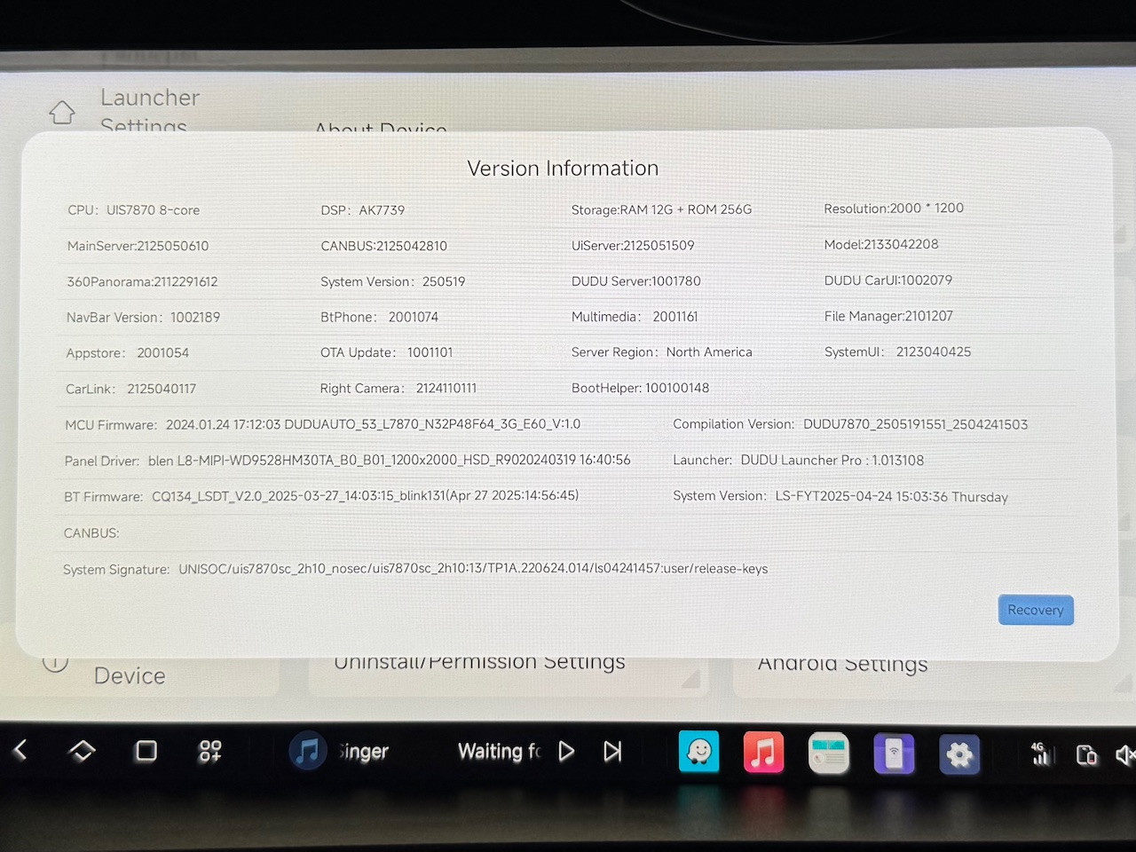

                I just saw your system information. You should update to the latest system to have this feature.
                This feature was added in June.

                  DUDU-Meng Hi Meng, thanks for sharing the APK file. After installing the APK file, the “Phone Voice” SWC command is now available on my Dudu7.
                  I have tested the “Phone Voice” command, it can activate the Siri on my iPhone connected via Bluetooth, this will only work as long as CarPlay is not connected.
