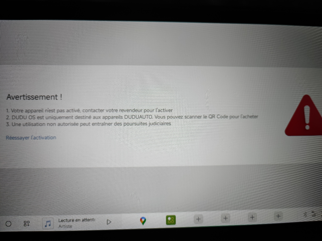

        Hello,
        I would like to know if this OS can be installed on every Machine ?
        I have a Mekede M700s 7862. Am I allowed to use it on my machine ?
        After the installation, a pop up inform me that my machine is not activated :/
        That is normal ? How can I get or purchase the DUDUOS ?!
        Thanks for you reply.
        Have a nice day !
          Gurlyc Es ist verboten die Firmware ohne vorherige Anmeldung zur Beta zu installieren.
          Bitte lese die FAQ wie man sich registriert.
            JhonnyD
            Thanks for the reply.
            I can't find FAQ anywhere about it.
            I can't find where to register or purchase the Dudu Auto beta tester.
            Am I an idiot or tired ? :/ idk
