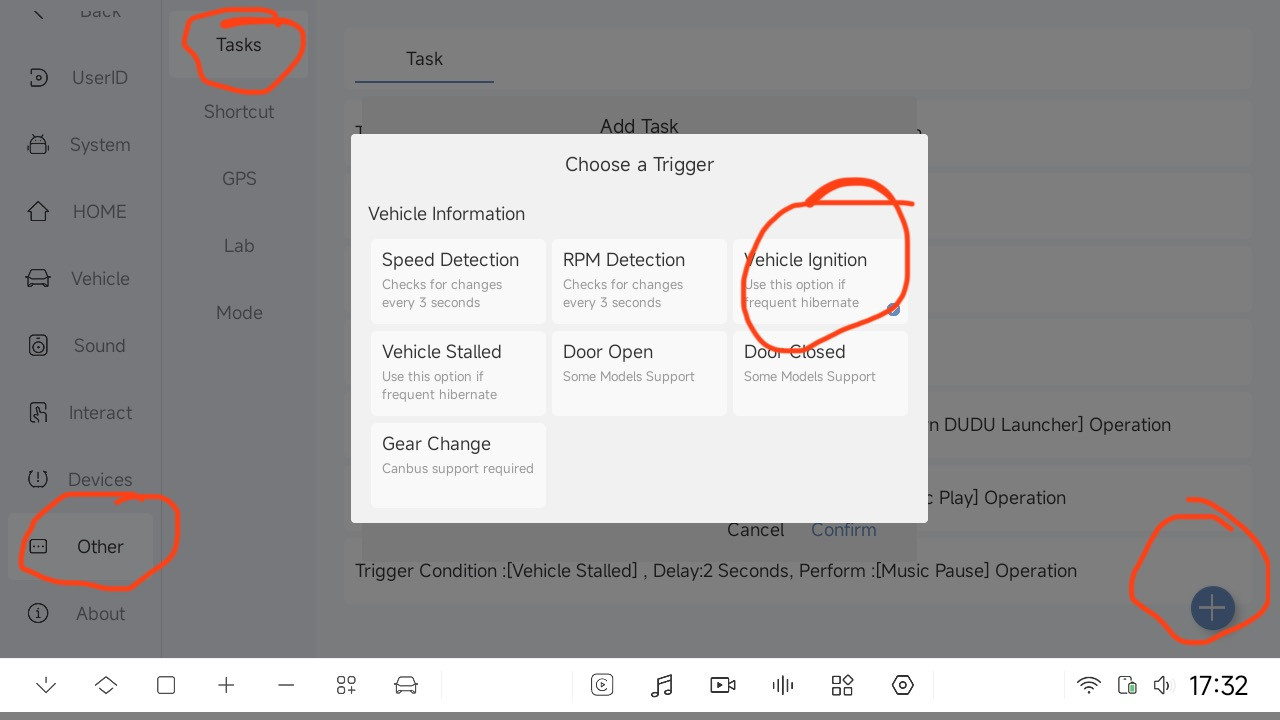

This is found in the DUDU7 Task settings
Settings | Other | Tasks
You click on the + icon to create a new automated task and then go through the options to setup
Trigger: Select Ignition Off
Delay: 1-2 Seconds (0 may also work)
Perform: Pause
If you want the music to resume when you turn the ignition back ok, do the same but with the Ignition on trigger and the perform set as Play..
You may need to add the music player to the no kill list

I'm now of course even more curious where to find the "Ignition on/off" trigger for dudu tasks, I just can't find it. Could you maybe provide a screenshot? Is it car/CAN specific? @DUDU-Meng (I'm on 3.5 btw, not using telegram so not able to join beta :/)

You can find the DUDU tasks as listed in one of my previous posts, I’ve indicated exactly where they are located.
Here’s an image to further back that up.
If you are using the beta firmwares, the latest 3.6 revamps the settings menu, if true, you need to go to ‘More Features’ section and locate the tasks sub menu.

I've used the tasks menu already but I just can't find that trigger, my UI is German though, so might be a translation issue, I'll look into it again, but I guess I'm using it already (it's called "start on boot" translated back to english) which is quite misleading.
I guess it's only meant for "Ignition on" so I would still need one for ignition off. I'm using latest Dudu7 12/256 3.5 with expert mode enabled
Hi, I have just checked and for German it’s labelled as
Fahrzeug Zündung
For the ignition off trigger, it appears it’s labelled
Fahrzeug abgewürgt
(Vehicle Stalled in English)
The translation doesn’t appear to be the best, however I have that set on mine for when I cut power to the ignition, my music pauses with no issues.
Hope this helps
Auto Task Vehicle Ignition That's the ACC energized, not the actual engine ignition.
I've added "ignition on" task to autoplay media. That works, the "car stalling" task sadly doesn't. Tested pause with tidal, native media app, native radio app and additionally "decrease volume" all in normal and minimal mode with different delay, nothing happens.
