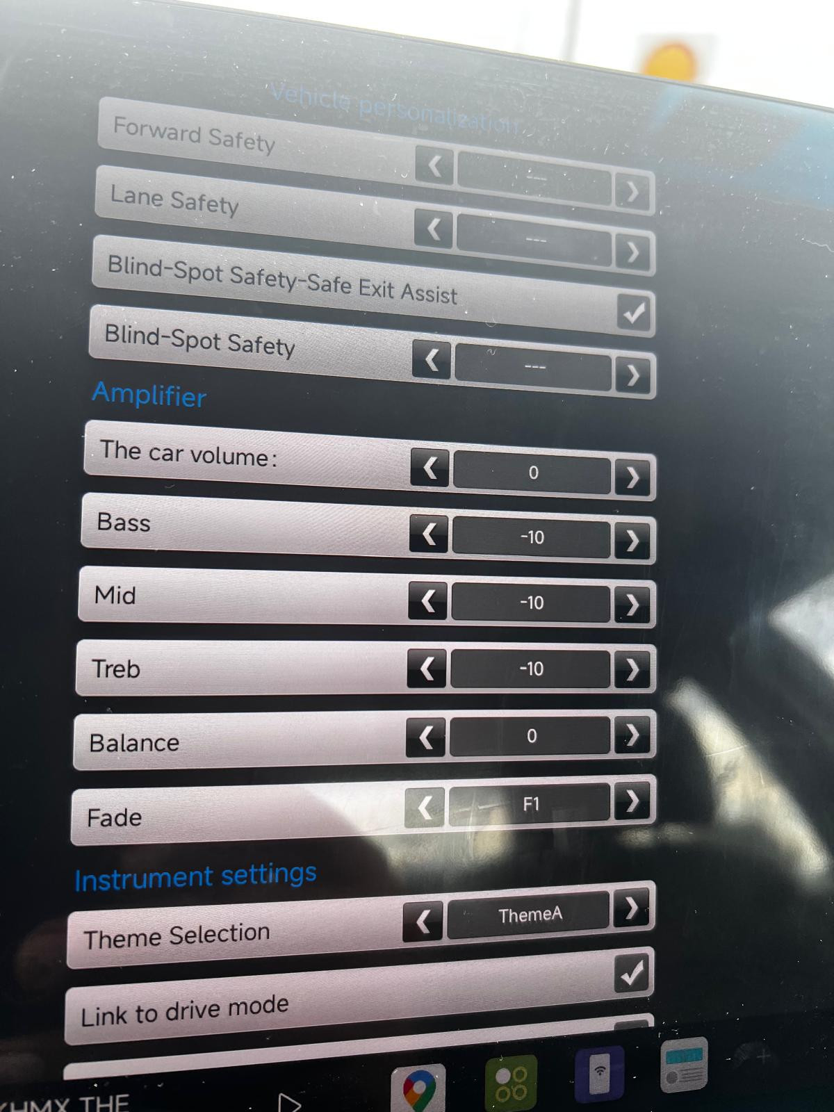

              After DUDOS3.6 update I started having issues, so far the most annoying issue is the pop sound when turning off my vehicle. Before the update the sound worked with no issues.
              2015 Sonata Limited with OEM amp (JBL)
              IF I move the Car volume to 1, it will not make the pop sound, but then I won't hear anything.
              Any suggestions?

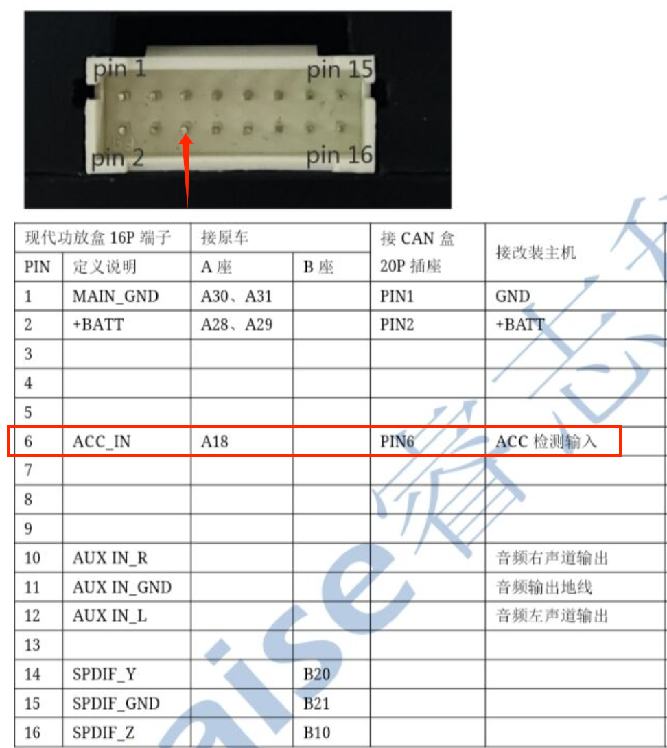

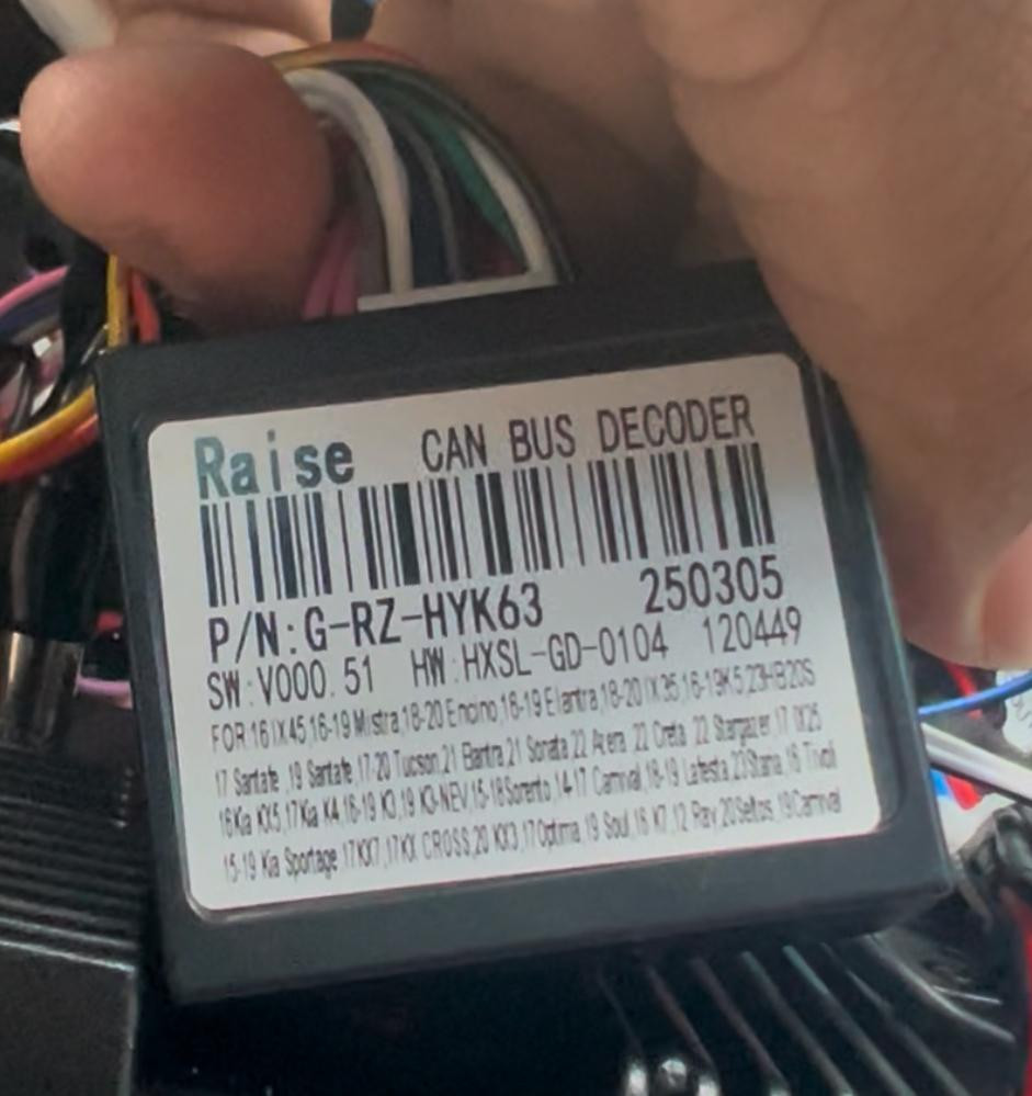

                eddyknowsit
                This method may help resolve the popping issue.
                Cut the 6-pin cable from the RZ-HYK-64 CANBUS box connector. Connect the 6-pin cable from the CANBUS box to the AMP cable on the DUDU A connector.
                Then upgrade the MCU. DUDU7MCU - https://drive.google.com/file/d/1S9OWl8tIw6fElllTs_M8ott7ZmMSA6AR/view?usp=sharing
                  I did as you
                  dudu-lai I did it as you instructed, it worked, the pop sound is gone. Quick question, now it seems the sound is a bit lower than what it was. Any suggestions?
                    eddyknowsit I don't know why the sound has become quieter. This doesn't affect the volume, it just changes the way it boots up.
