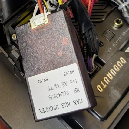

After hours of troubleshooting, chatting and waiting responses I ordered another canbus decoder, this time it's the HiWorld AU10.20. That one apparently isn't recognized at all.

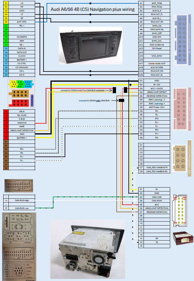

Since I was always asked if the wiring is correct, i drew a wiring diagram, in case anyone wants to know, I'll attach it.
This is the screenshot with the old LZ(HZ) box, it always states "unknown can-protocol". Tried several different settings, A6, A4, A3. If they worked, it was only the 4 steering wheel buttons, no more.
Any chance that's going to be updated?
New Protocol Box:
Old Protocol Box:

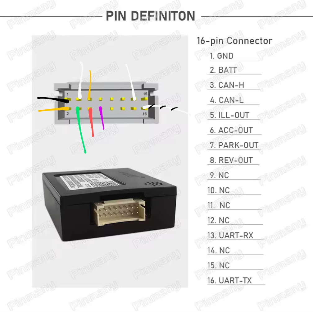

Used the same cable, from what the seller told me, pinout is the same, he provided this:
LZ: 1/5
HiWorld: 0/5
