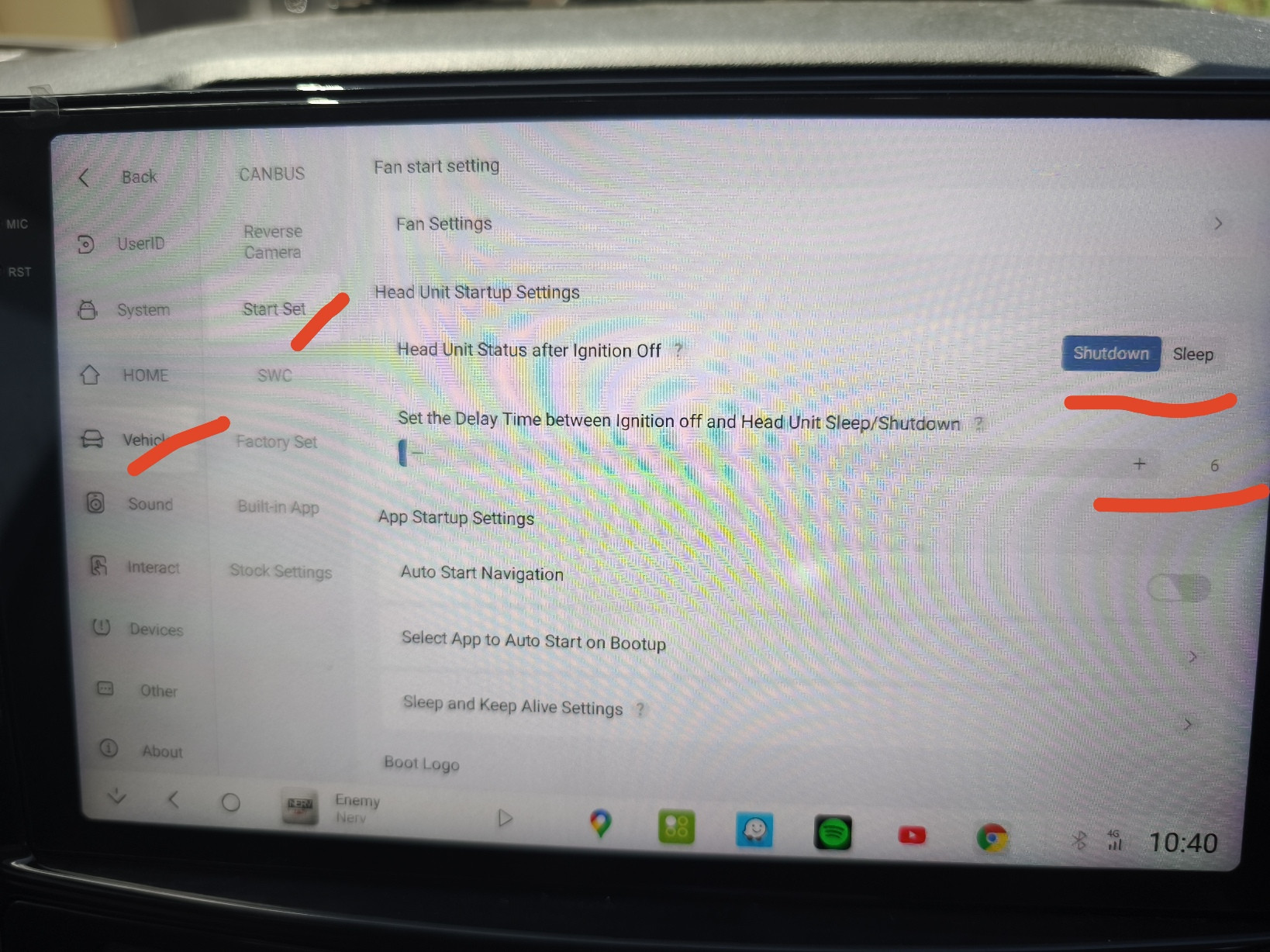

Hi. Just to update. Issue solved! Got assist from Duduauto telegram global group. Bunch of thanks to Vitaliy!
Steps:
Go to Setup - Vehicle - Start Set
Navigate to "Head Unit Statis after Ignition off" Change from "Sleep" to "Shutdown". In the ? Duduauto do recommended to set it to off.
2nd:
Navigate to Set the Delay time between ignition off.... Mine i set it to 6sec.
Hope this helps!
Thanks for all the helps. Dudu7 works flawlessly.
