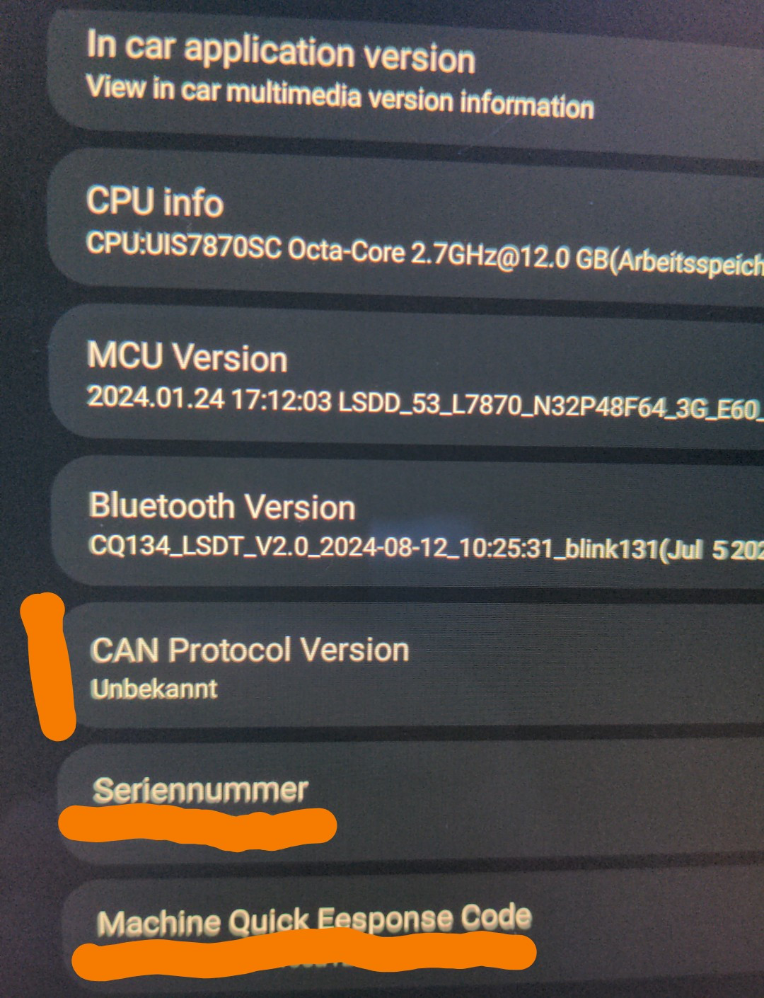

I just can't get my SWC to work in my e82. All that is working via CANbus is recognizing reverse gear (screen shows non existent rear view)
Things I tried after scraping together any info I could find on several threads about CANBUS in general:
- Reached out to Sales (official Mekede store) setup up everything exactly as I was told
- Try to Update relevant app through the DUDU (?) App store. Everything was up to date already
- Get logs written to local Filesystem, via "factory settings" (no log file in is generated btw)
- Looked for anything else CANBUS related in the android settings, where I found this:
Here it says "Unknown CAN Box Version!"
