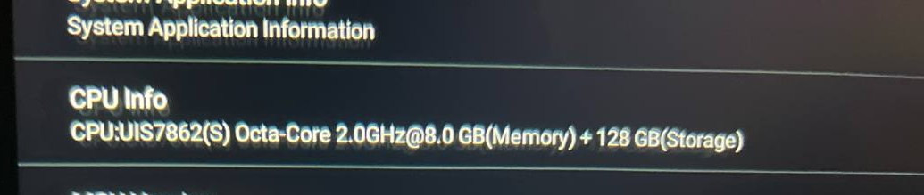

I recently joined the beta program for my EKIY T7 (UIS 7862S) device, expecting to receive DUDU 6, but instead, I got DUDU 5. Has anyone else experienced this?
Is this a mistake, or is there a reason why some beta testers are still getting DUDU 5 instead of the latest version? Would appreciate any insights!

        Why the system reconize my unit as dudu 5 if i have UIS7862s?
          nati9711 Because the differentiation between DUDU 5 and 6 is made by the DSP no matter if you have 7862s processor. If you'll read the FAQ thread you'll find the differences between DUDU 5 and 6. Google Translate will help.
