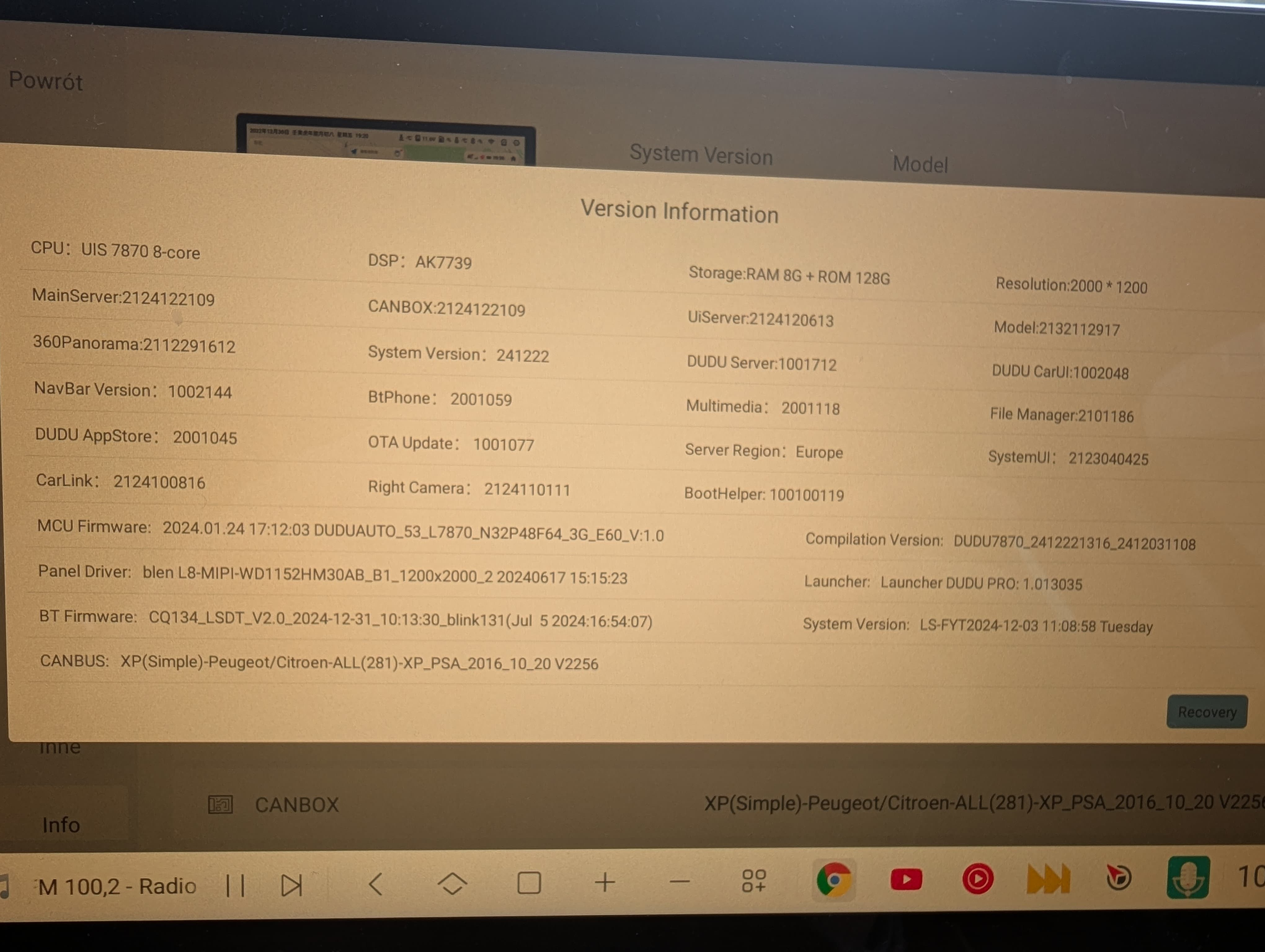

Hi,
I have this issue again. Last time I did a hard reset of my DUDU7 device and it helped. (This points to it being a DUDU device issue, not my WiFi hotspot).
This time, it happened after updating the software to the latest release. But the previous time, it happened without any apparent reason, so I can't pinpoint it to the software release.

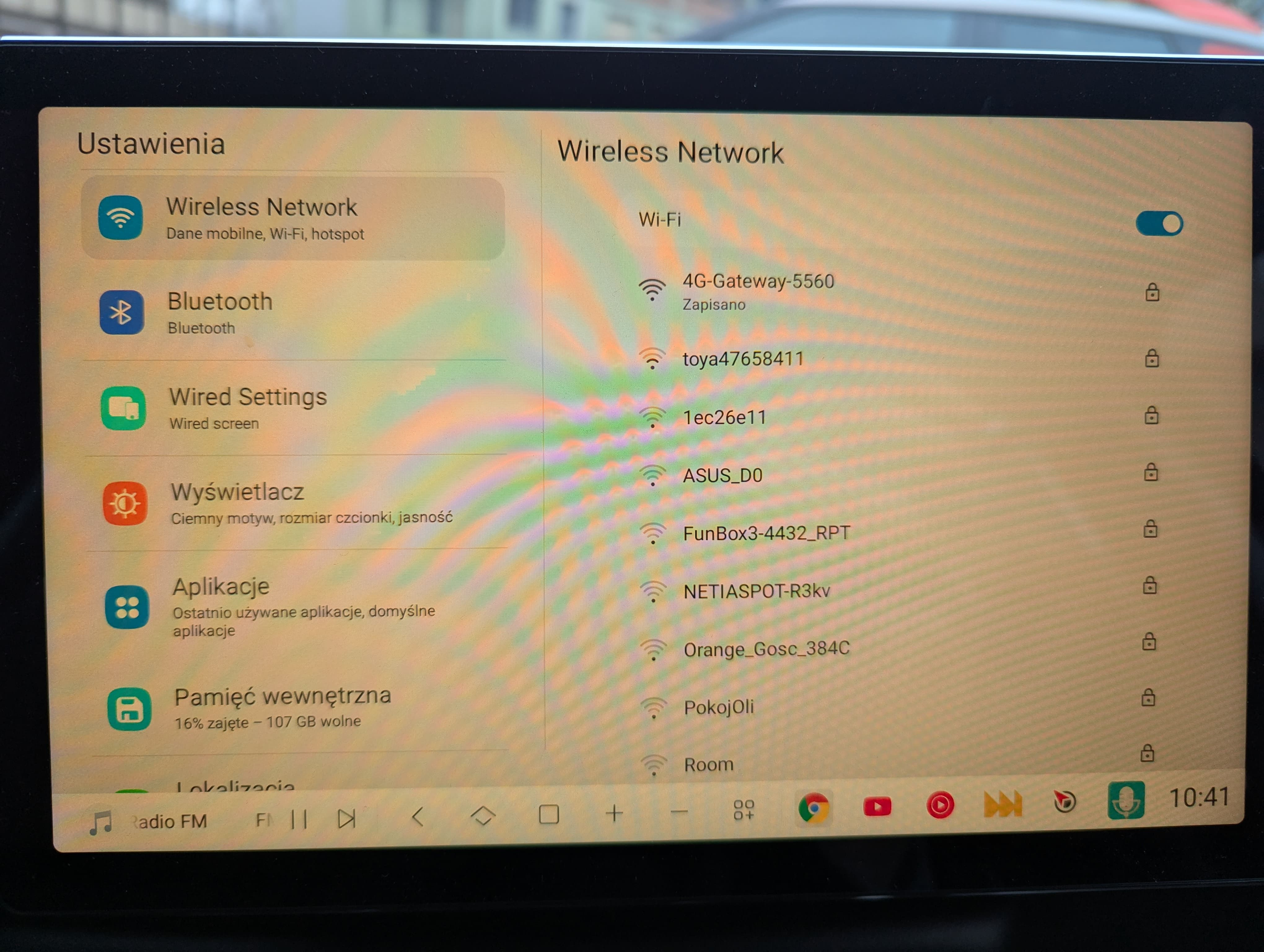

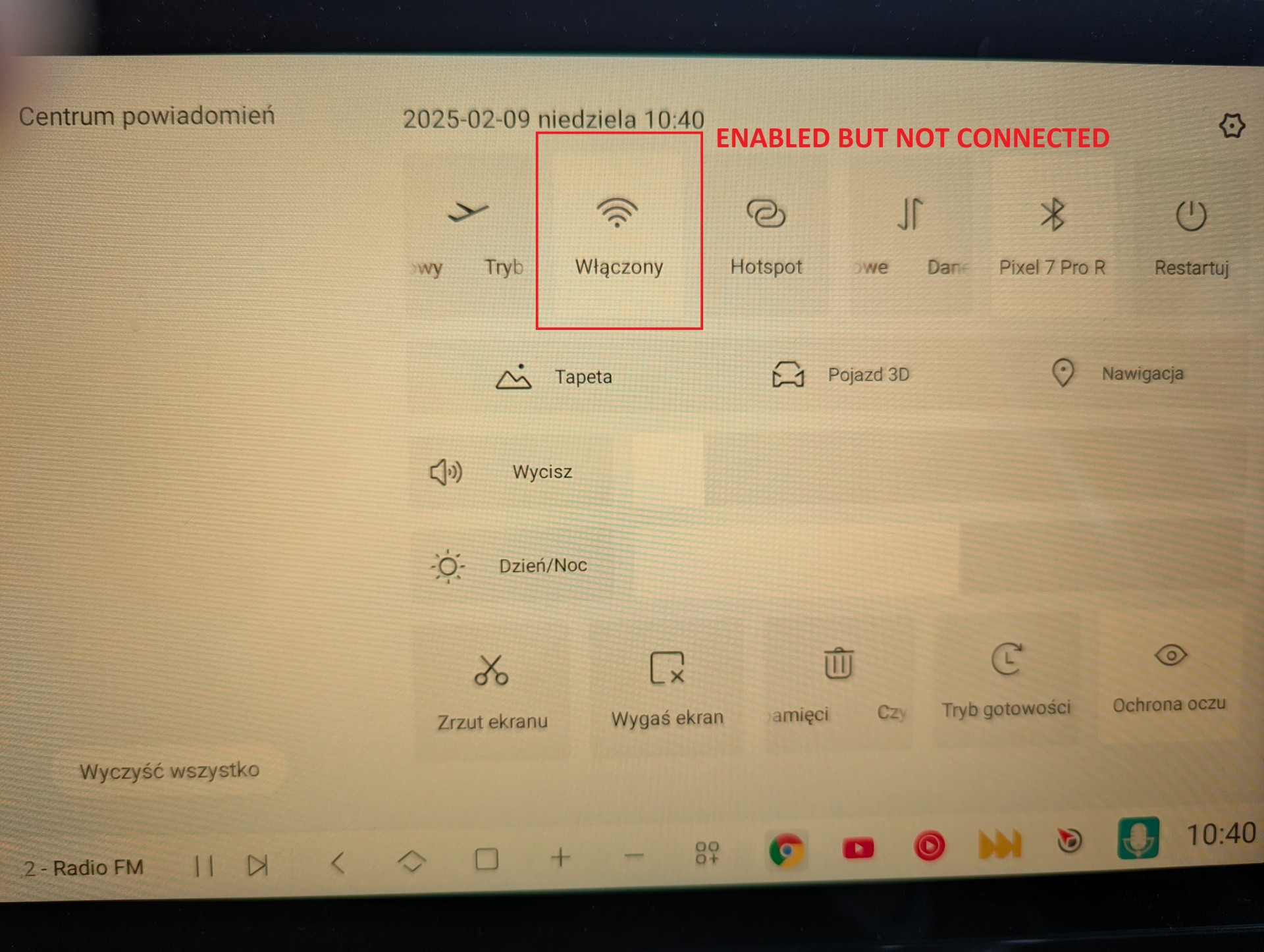

On DUDU, I see the WiFi hotspot devices list, but I can't connect to my hotspot (nothing happens when I select my hotspot name). However, I am somehow still connected to this hotspot in the background because the internet is working correctly.
When I did "forget hotspot" and "reset WiFi settings", I could see my hotspot again, but I still couldn't connect. However, DUDU is connected to this hotspot in the background because the internet is working.
