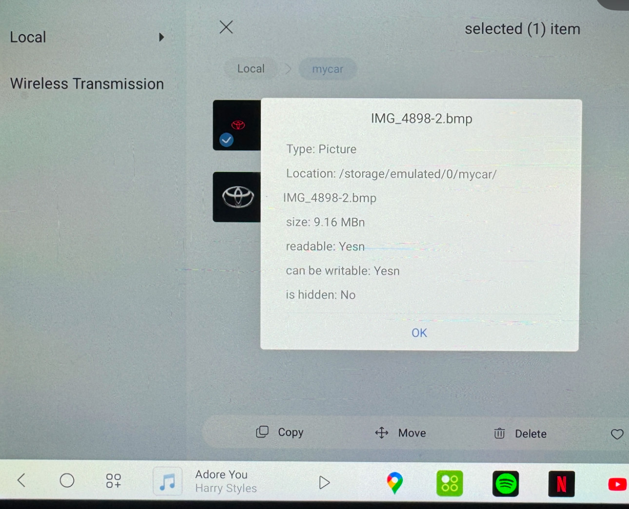

I have put it in the mycar folder from the root on the local disk.
The path is /storage/emulated/0/mycar/
Or do I have to put it permanently on a USB?
Is that correct?

    It doesn' t have to be permanent in /mycar. The system will copy it to an internal location.
