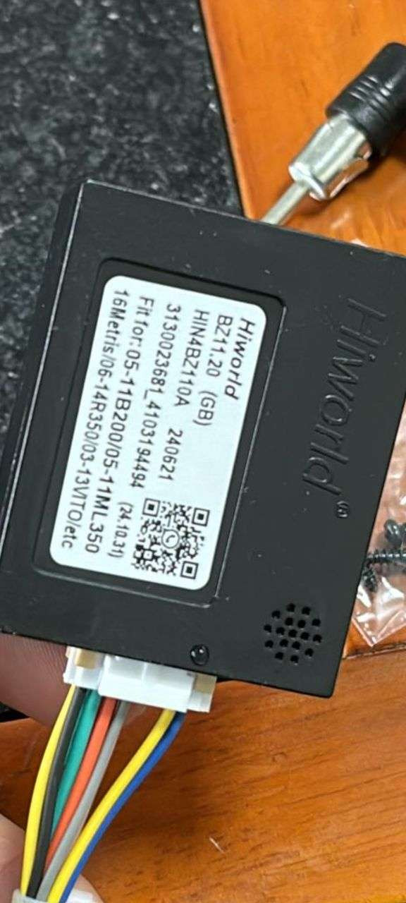

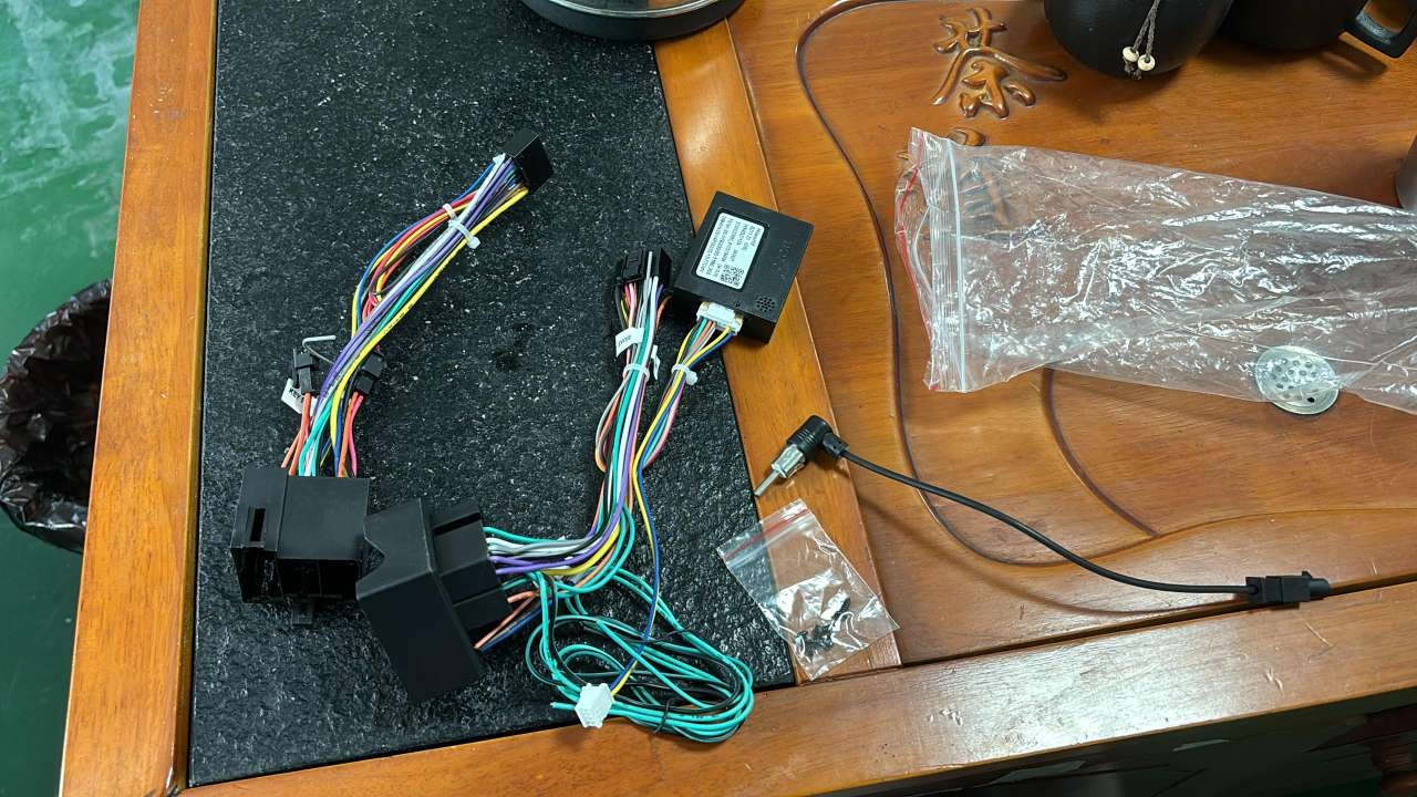

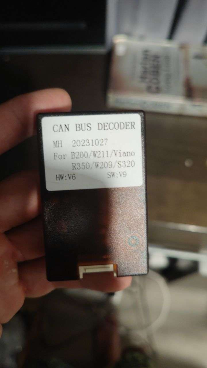

 My parking sensors are not working or detected. I have front sensors and back ones. The canbus works in steering wheels, door opening and car speed. But parking sensors arent detected or working. When i reverse the headunit detect reverse mode but i have not signal from the sensors.
I attached picture of the 2 canbus i tried and received and the cable used in addition to reverse mode i got
Model : dudu6 8gob/256gb
Mercedes clk 200 w209 2006
Tried 2 canbus hiworld bz11.20 and LZ(HZ) v6 both are showen in the pictures attached.

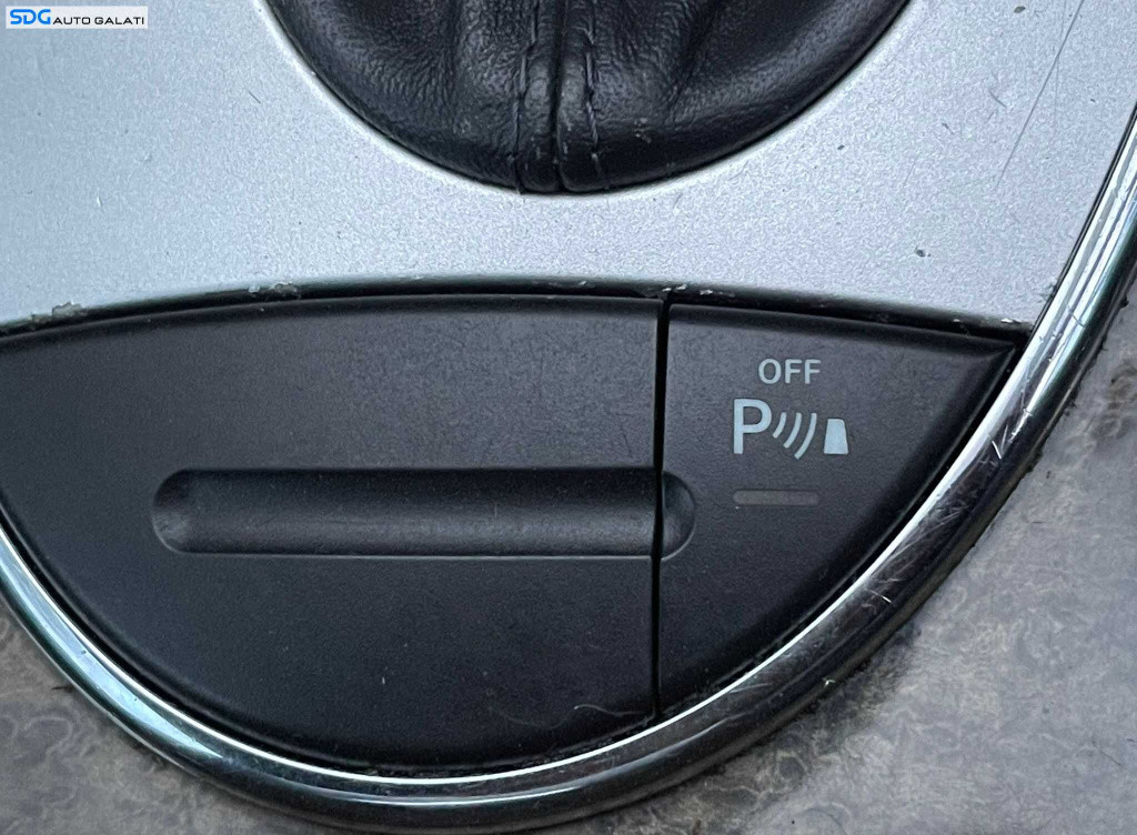

        Does the car have a physical “P” button to turn sensor sound on/off?
        Or is the radar disabled in the dash settings?
        Yes I think it does, do you mean this button
        No the radar is enabled in the settings, even the reverse lines work when I move the steering wheel.
          Grga Yes, that's the pushbutton switch I was referring to. The light is on to indicate on.
          Okay, but if the sensors are on there is no light on the button but if I press the button the light turns red and the sensors turn off.

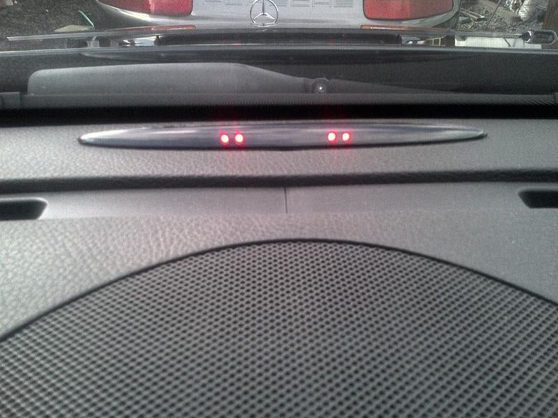

          The parking system uses those lights
          to indicate how near you are to something and they are working, just that the beeps were lost after the headunit upgrade. 😔🥲
