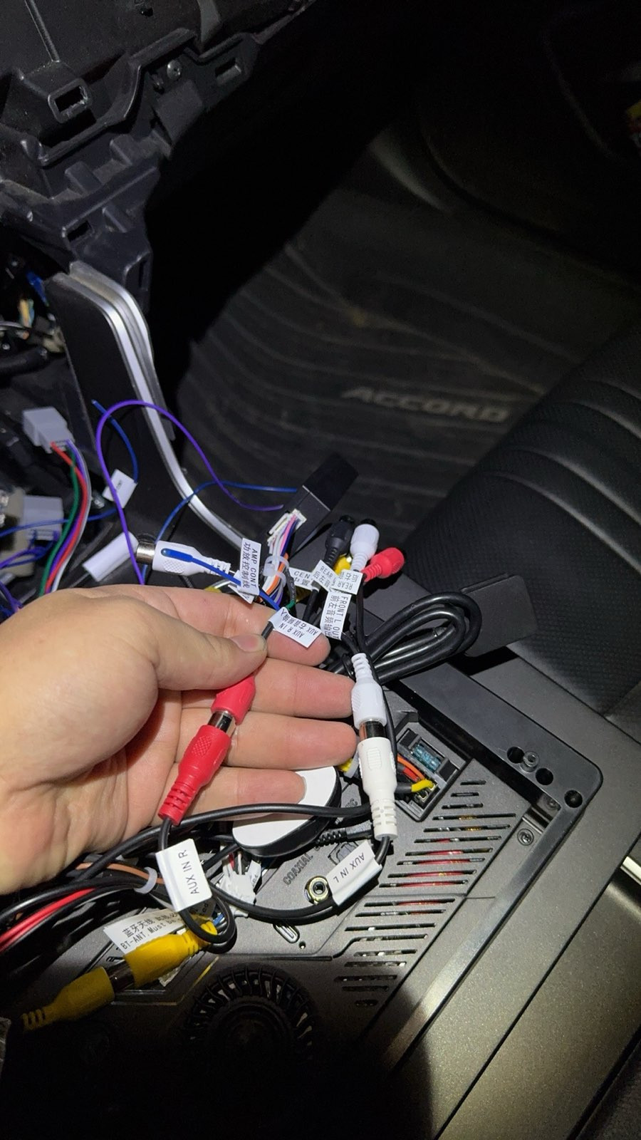

Problem: The car comes with an amplifier, but there is no sound output after the adapter harness is plugged in. The amplifier fiber optic cable is also plugged in. Hopefully this will solve the problem of no sound output.

    You should plug AUX IN into the front left/front right audio outputs of the DUDU.
      dudu-lai Thanks. I connected it the way you did. Still no sound

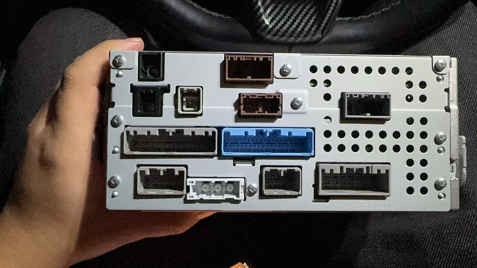

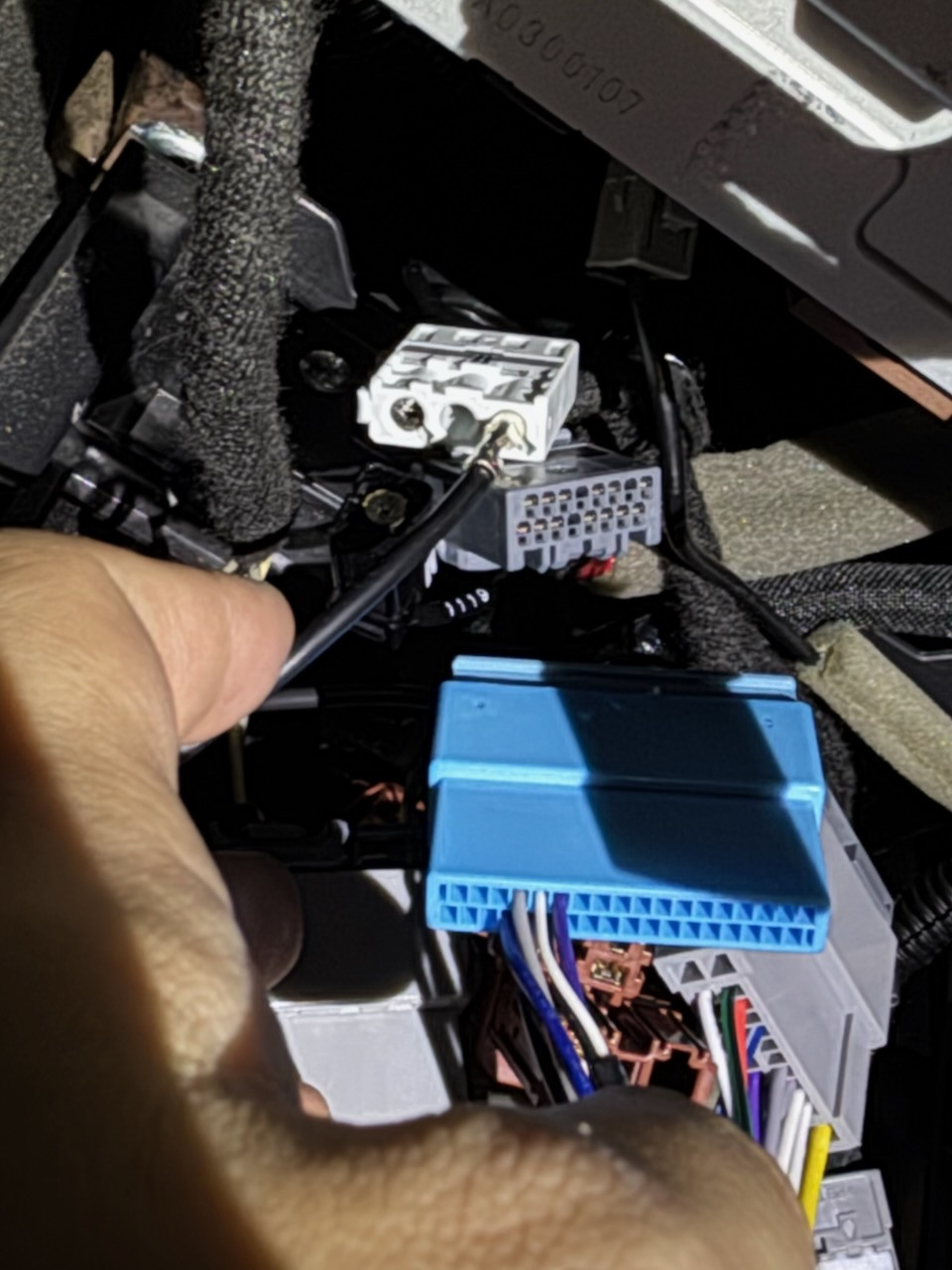

        beginner Please check that the factory coaxial audio cable is not connected incorrectly
          dudu-lai I will try again

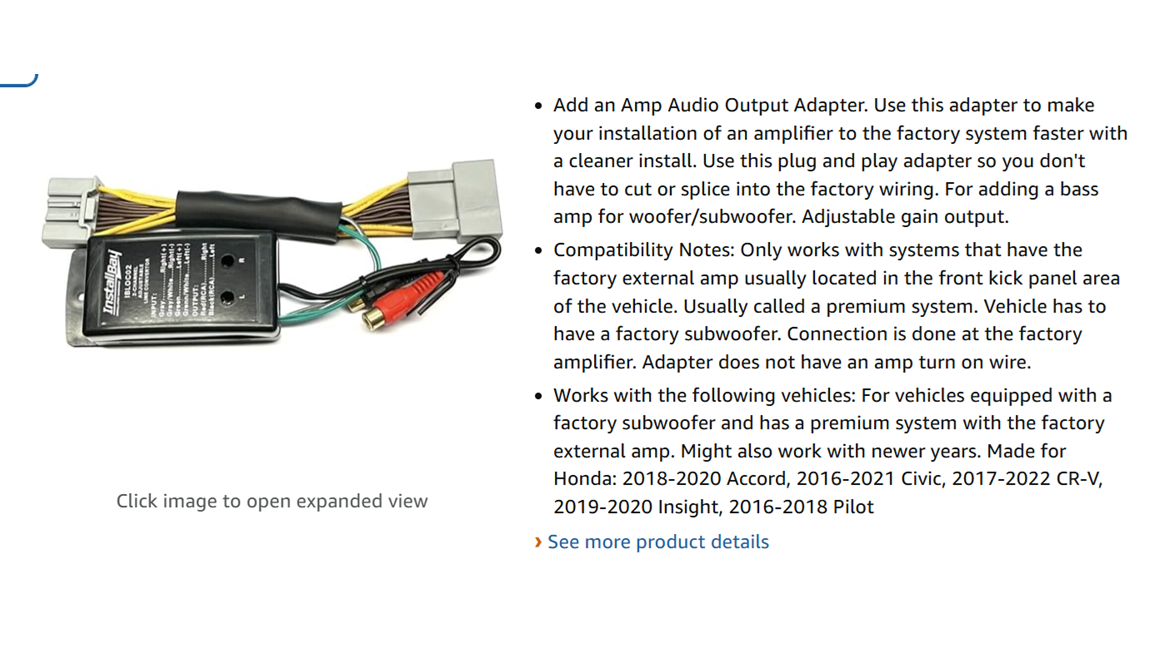

                i need you to help me with the sound problem as it is an issue not only with Honda and Dudu7 its an issue with cars that have factory Amp and subwoofer , i found this adaptor that might help with solving the issue of the sound can you link any technical personnel to confirm it will solve the issue or the issue can be solved with out this adaptor or you have any extra harness that will make the sound problem be fixed .
                  Moemen Have not used the unit
                  As long as the cables are correct, the sound will not be a problem. Also, Honda cars use coaxial audio, so even if there is an anomaly, it's not difficult to fix it
