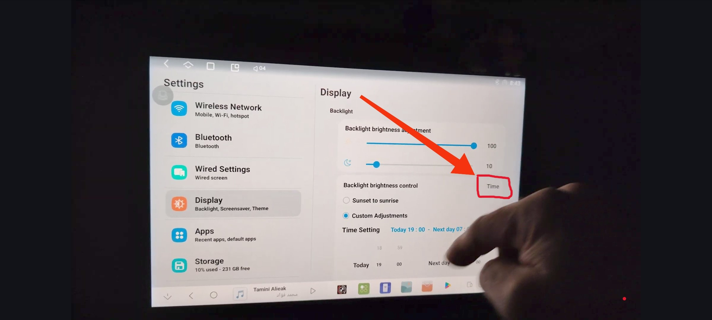

          Hello my friend, look at this video carefully. I chose the option to change the day and night mode with the light switch. It is supposed that when you turn on the light, the night mode changes and when you turn off the light, it changes to day mode in the background. This did not exist at all. This option is activated as if it were day and night mode, the same as the rest of the modes, as if it were set to a time. I hope to solve this problem. Thank you.
          (https://drive.google.com/file/d/115KtAQn1QzPvtJ1myQLf-0VXRa4x-hza/view?usp=drivesdk)
            Abdala2085 When in this screen press the text "time". Even if it looks like simple text it is a toggle. It will change to "lamp" and your problem will be solved.
              MihaiFlorin
              Tomorrow I will take a look at it and work on it and fulfill the matter for you Thank you
              MihaiFlorin
              Thank you my friend I did it and it worked right greetings to you
