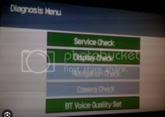

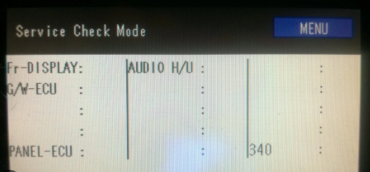

                you see how there is a service check and diagnostics menu?
                typically these menus come up when you short obd2 pins 4 and 12 or 4 and 13.
