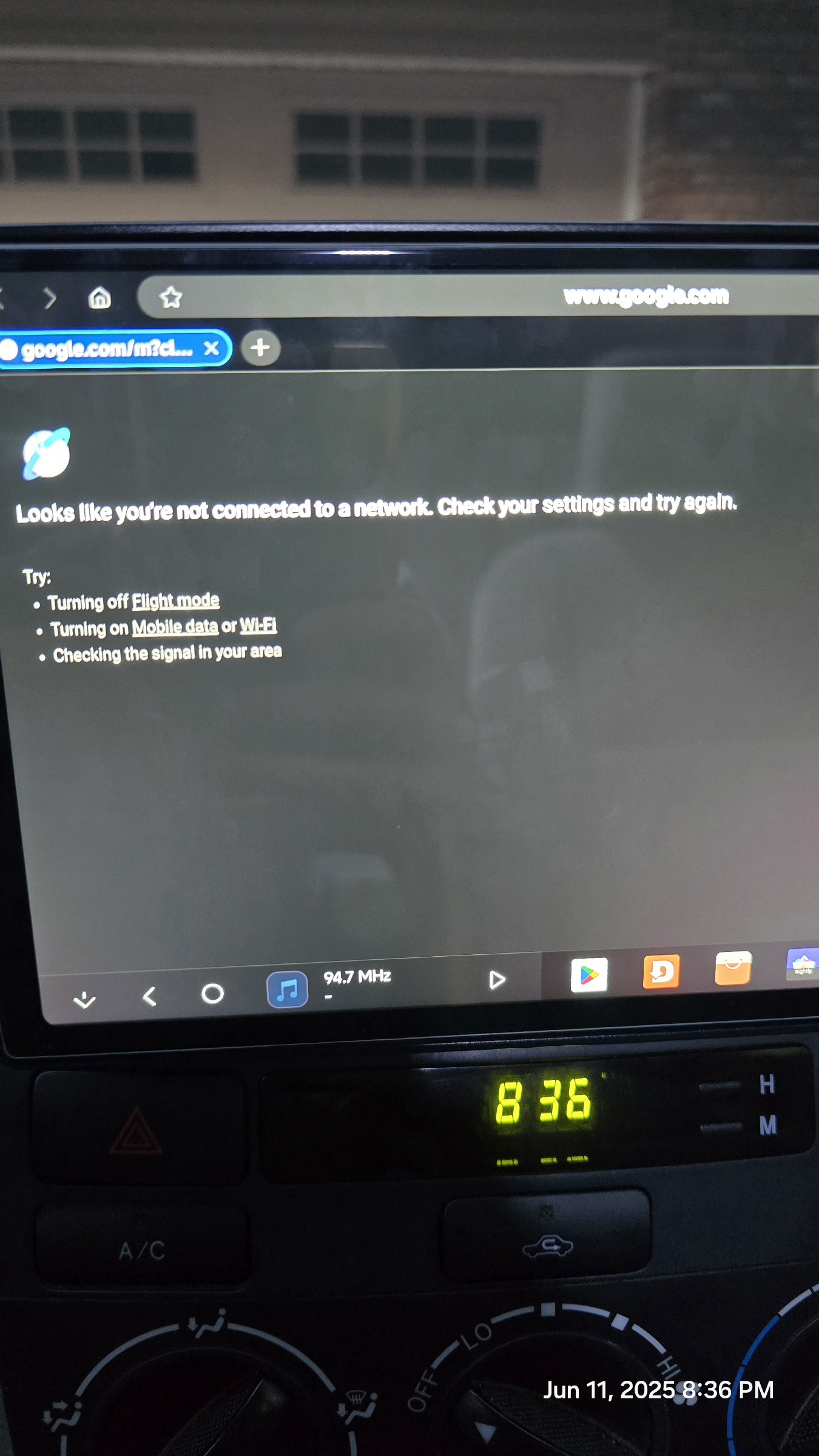

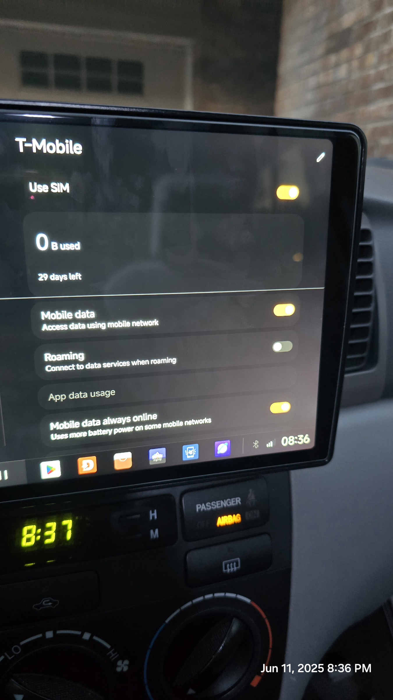

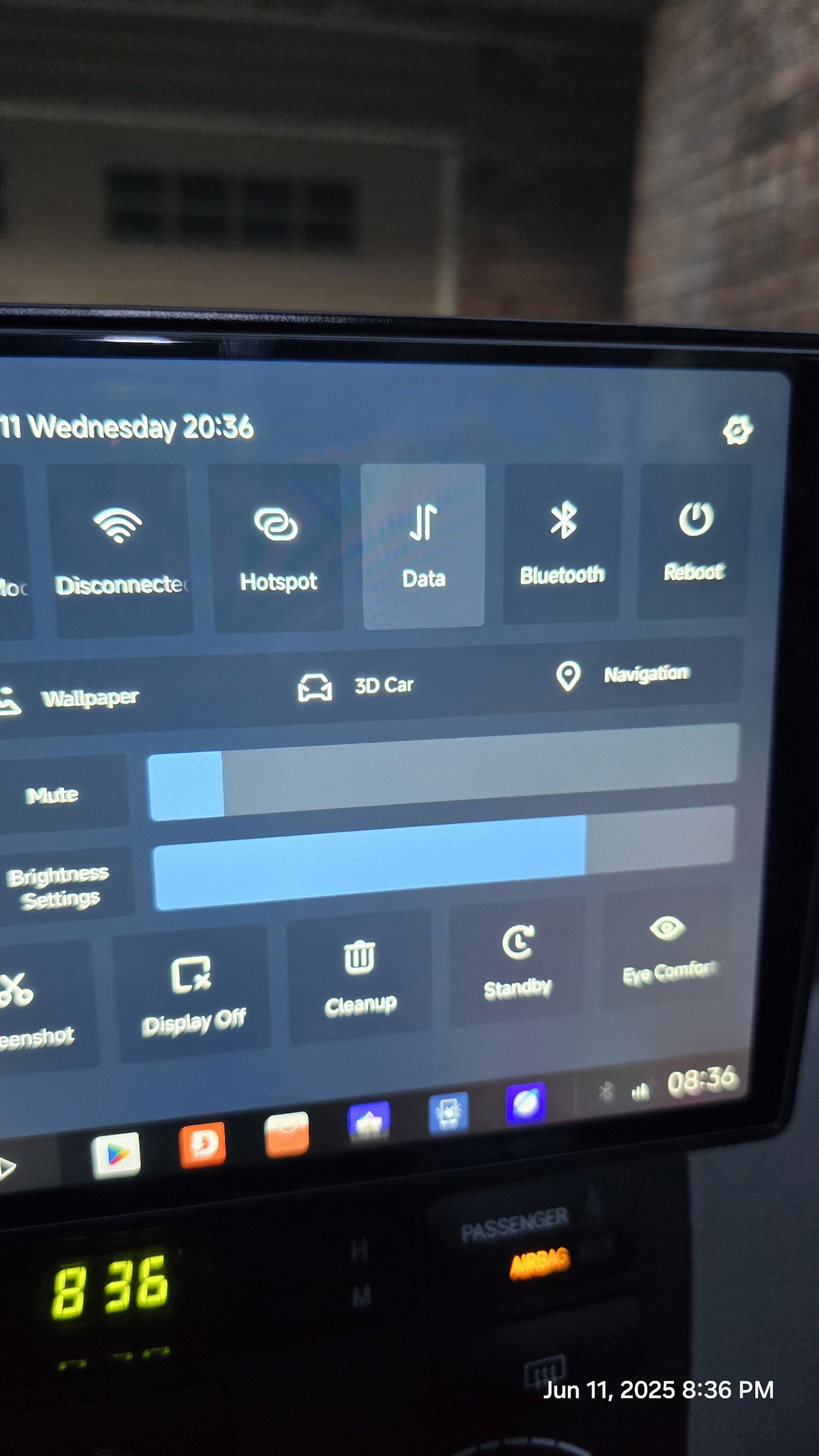

                  If anyone else in the U.S. is interested, I just received a "tello" brand SIM card yesterday (data only option) and installed it in my DUDU7 - 3.5 os and I'm happy to say it WORKS!! I initially did the same as others, where I tried to verify the DUDU7 IMEI number on Verizon and other sites and it never returned as valid. I even called tello customer service and they said their card wouldn't work because the device IMEI number I gave them indicated it did not support the three bands?? I decided to chance it anyway and ordered the cheapest option (2GB data, zero mins).
                  I first registered the SIM card using my computer. After finally figuring out how to open up the SIM card holder I inserted the SIM card and hoped for the best. Not sure if it matters, but I made sure the DUDU7 was connected to my home WIFI first just incase it needed data to register. And then after inserting the SIM I rebooted the HU. I was about to be disappointed, but after about 5 mins I saw that it registered on the T-Mobile network with 4G, and I was getting data! This morning when I started the vehicle, I wasn't connected. I tried turing the SIM on/off, rebooting, etc. and finally after about 10 mins saw it registered. I'm not sure if it was something I did or it just takes that long to register. This time I saw it connected to T-Mobile's "EDGE" network.
                  So, it definitely works. I just hope I don't have to reboot the HU each time I get in the car or have to wait 10 mins just to get it to connect. Are other people experiencing the same as well?
