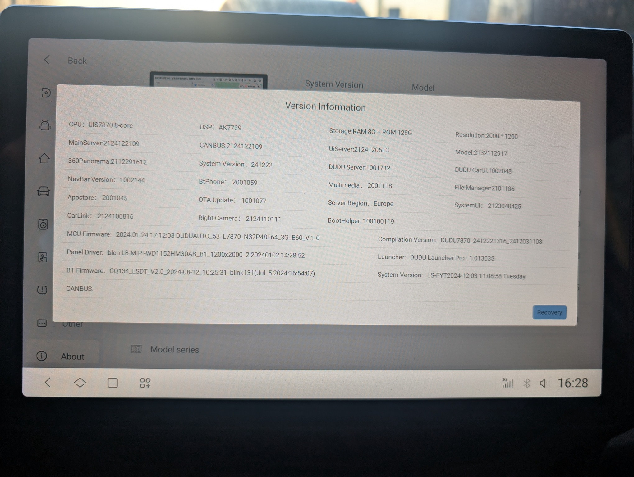

Прошивка устанавливалась с полным сбросом.

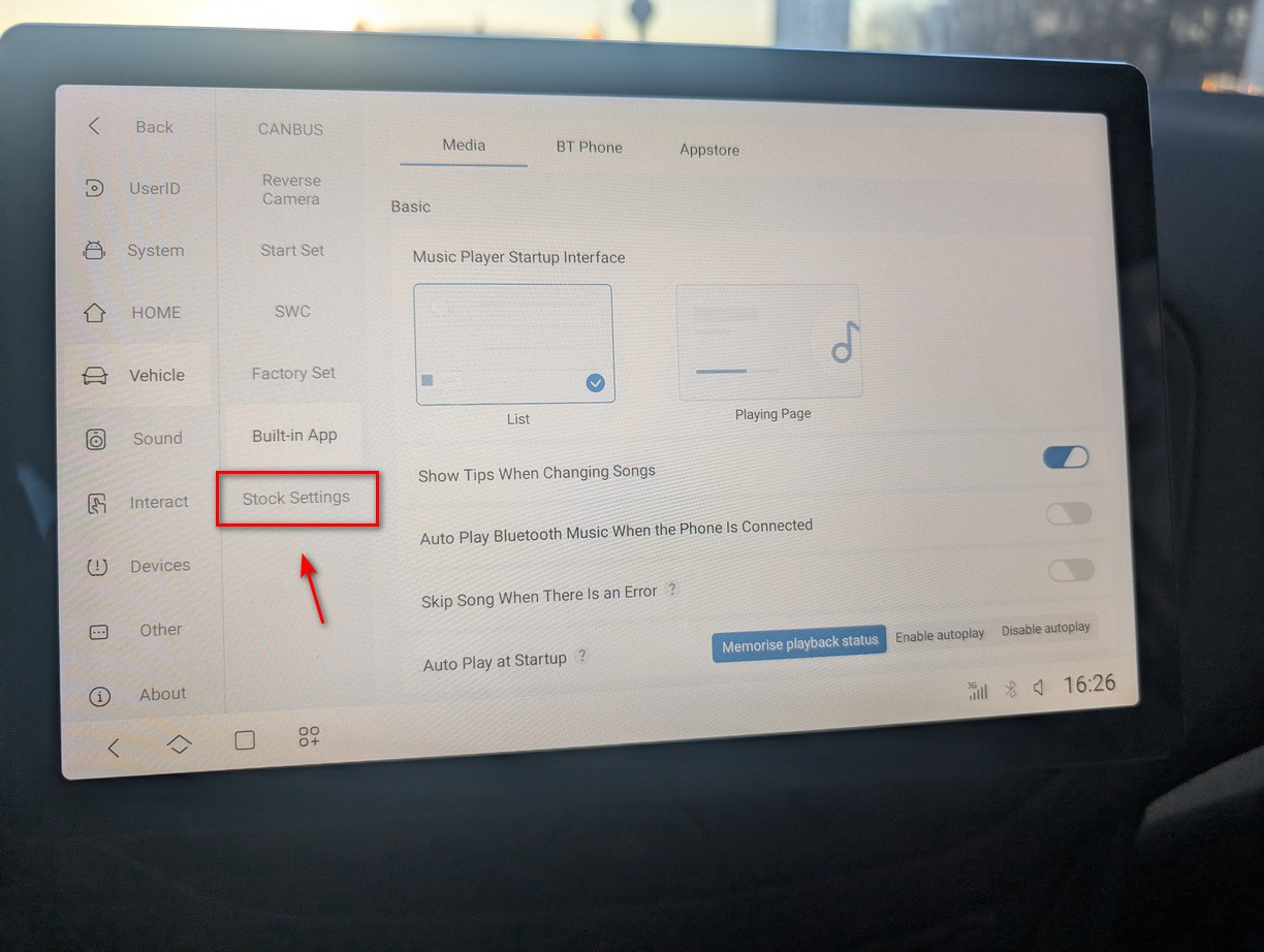

    For the first question, please select CANBUS first
    Vehicle>CANBUS>CANBUS>Select CANBUS

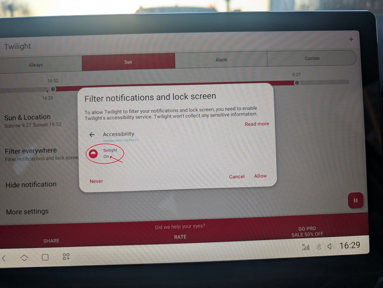

    Fort the "4th" (or 2b) question: Asking for accessibility will happen on every restart of the application. That is the Android security mechanism.
    Only system apps, or on a rooted unit, an non-system app can ask presistent accessibility access.
    But indeed: if nokill would work the app doesn't need to be restarted.
