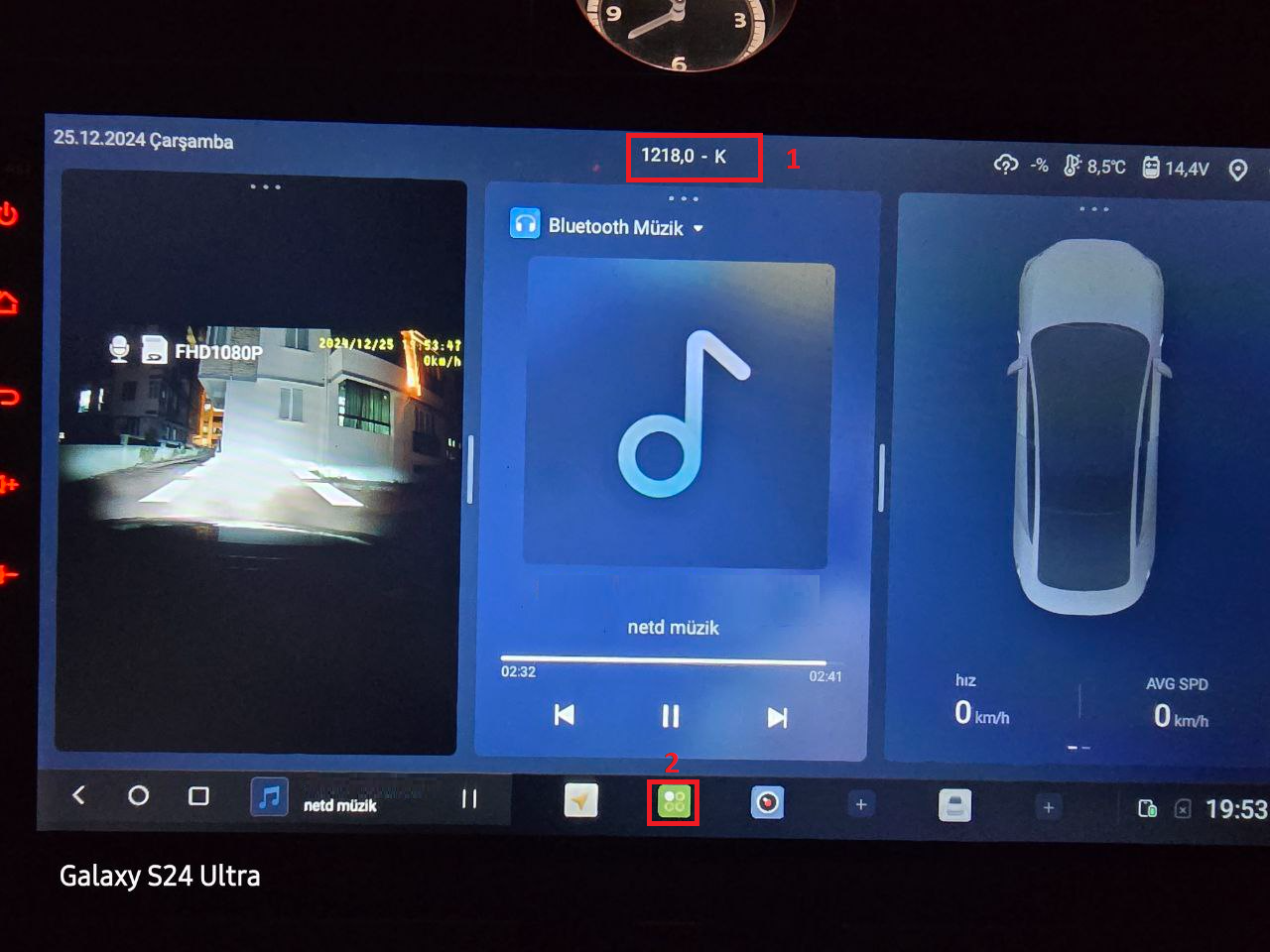

Detailed Description of the Issue:
In the image I have attached, there are two marked areas labeled 1 and 2:
Area 1: This area remains static and does not update. The issue persists constantly. It only updates after restarting the system and then remains frozen again.
Area 2: This area is completely unresponsive and does not open. Clicking on the section to the left, which displays the currently playing music, also produces no response. The issue resolves temporarily after restarting the system.

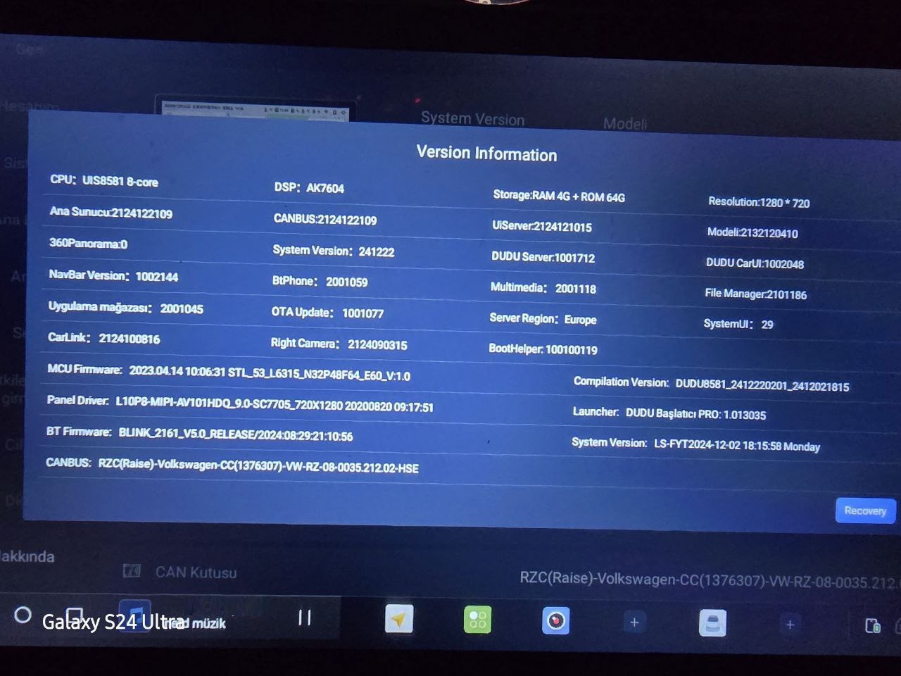

System Information Screenshot:
I have attached the relevant screenshot as per the instructions. The image was obtained by pressing and holding the top-left picture for 3 seconds in “Car Settings” → “About.”
Attachment: I am sharing a screenshot below with the marked areas for detailed inspection.
