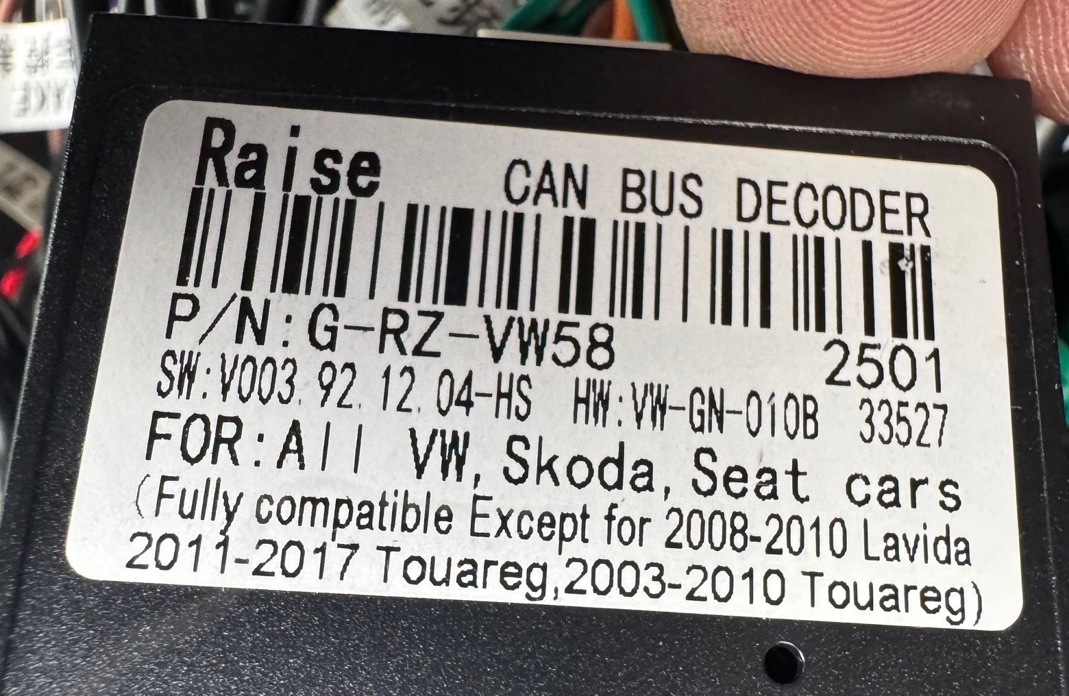

imed88 gismo and plz which is not compatible ? the box ? because i tried simplesoft box but the same result i get only MQB and PQ40 Platforme and both did not work .

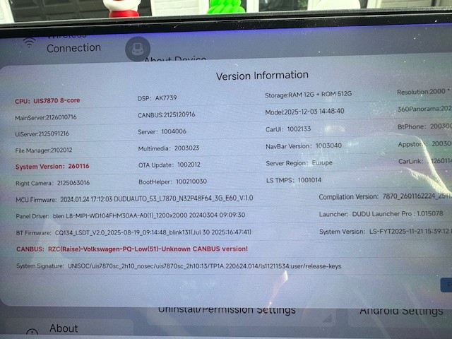

gismo @dudu-lai this has worked well for a long time. Recently however the SWC voice key no longer invokes Gemini but Google search. Gemini is still installed and works fine when invoked with "hey Google". Not sure whether Google has changed something or Dudu - but it would be good to see the old functionality restored. I'm still on the September beta.
MrMcFly gismo I think it happened after an update of DuduOs. Not sure if google can change what starts when using "assistant button" with an update.
dudu-lai gismo https://drive.google.com/file/d/11fcGIBEFwoeLF63Mo9mWb0mZPS6T745B/view?usp=sharing Try installing this APK and see if the problem is resolved.
gismo imed88 TS18 = Topway. Not compatible with DuduOS and different Canbus interpretation so nothing here will help you.
imed88 gismo hi friend, i want to be sure its a topway so i can search for a custom firmware that support PQ25 Platforme canbus and if you have a firmware in mind plz let me know so i can try it on it THX
MrMcFly MrMcFly i installed it by replacing the apk in the system folder, worked. And the Assistent is back to normal, so solved!!
gismo imed88 you should ask the reseller, really. If they advertise it for Skoda / VW then they should provide means to make it work on a Fabia / Polo.
JhonnyD imed88 There is a big Topway community on Telegram. The most people here have FYT and can't help. https://t.me/magnitolaandroid
