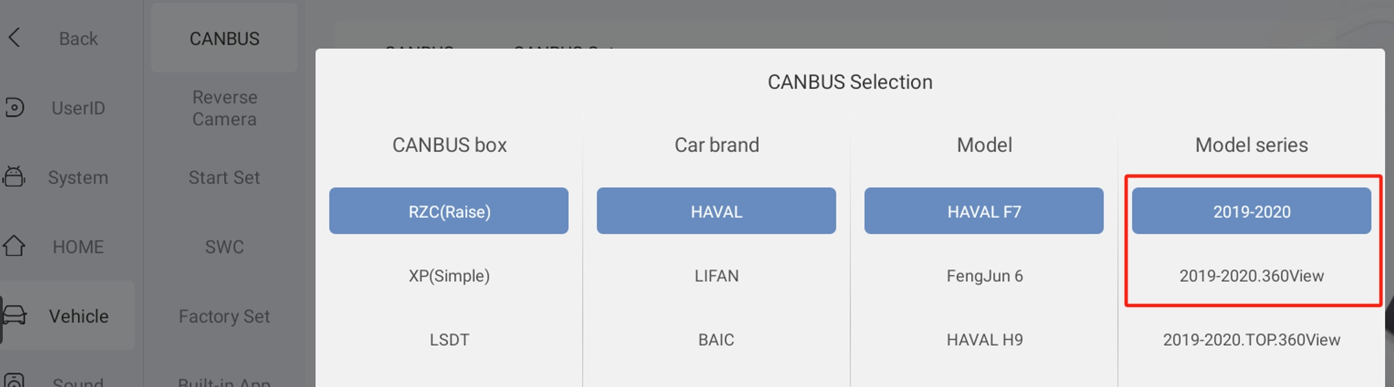

    Setup>Vehicle>CANBUS>CANBUS>Select CANBUS, CANBUS box: RZC(Raise), Car brand: HAVAL, Model: HAVAL F7 ?

        MoonDerDuck
        You can try selecting these two options and see if the temperature in the navigation bar will display decimals, such as 22.5 ° .
          caolz я выбирал средний параметр, оставалось все тоже самое. Верхний это я так понимаю без камер кругового обзора, они в таком случае будут работать?
            MoonDerDuck
            2019-2020.360View
            You can try selecting this option and see if the temperature in the navigation bar displays a decimal, such as 22.5 ° C.
            If the temperature in the navigation bar still does not display decimals, you can check this issue again after the next system version update. We have made some modifications to address this issue.
