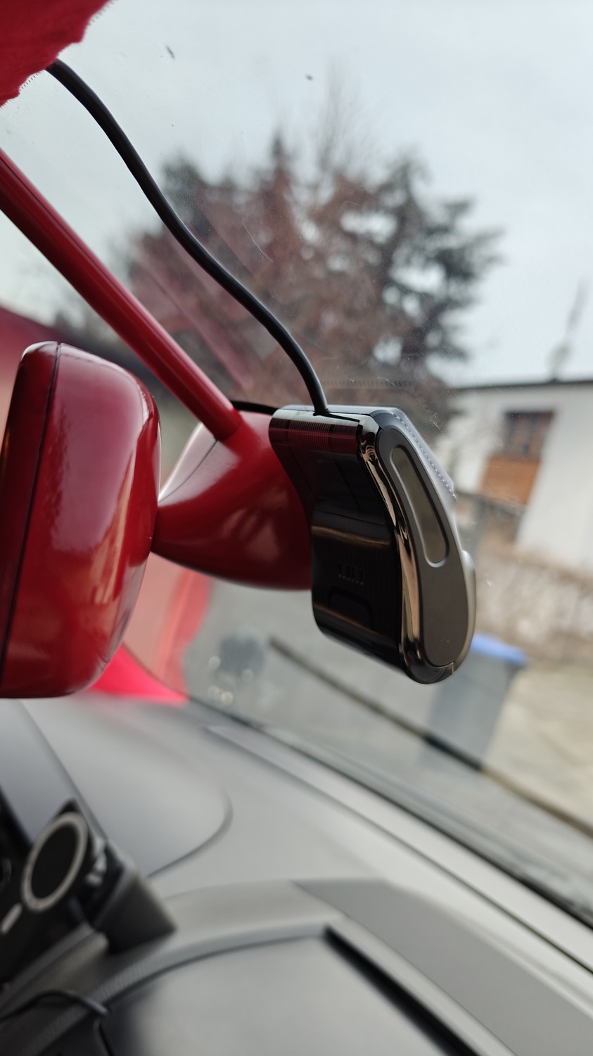

1st thing the adas DVR camera in not working after conecting to USB (tryied all 3 plugs) there is no memory card, i have tryed the file manager to check if there is any app file inside, host unit is not detecting the camera via USB

      santino Please take a picture of the shape of the recorder to confirm whether it is 1080P or 2K

        santino Is the indicator light on the left side of the logger on? If so, you can plug the Logger into your computer's USB port to see if you can read the Logger's internal disk drive.

        Finaly i had to take out the main unit for some work, and pluged in the camera to a computer, and i get a message that windows is not recognising the usb device, ore there is a problem with the device
          santino Camera malfunction or cable reason, please contact sales staff for after-sales service
