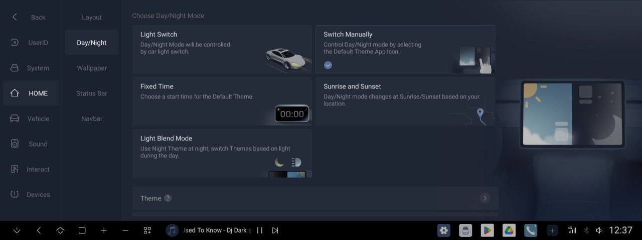

        Nolex переключите изменение день/ночь в ручной режим. И включите руками (ярлык приложения день/ночь) ночной режим.
        Nolex I can confirm that @Chubaka885 method works. Just tested.
        Thanks but it isn't really what I wanted. I'm already using the manual day/night switch. The thing is I use the function with the extra brightness reduction in Nightmode and would like to switch to day mode to increase the brightness with a single button. And there is my problem. As soon as I switch do Day mode all the menus go back to white while I would like to always have darkmode everywhere.

          You must select dark mode and leave the unit on the dark mode. When you turn on the lights (or the car turns them on, if you have light sensor) if everything is connected properly, the screen will dim the brightness to the one set in the day/night settings.

          Indeed, it is a bit confusing that the unit will change the brightness according to the lights on/off but this is how it works.
          I think I finally got it, thanks.

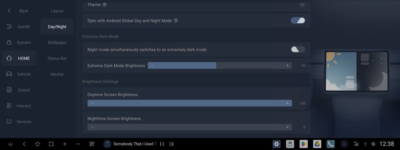

          The last thing that still isn't perfect for me is that the extreme dark mode will be always on this way if I want to use it.
            Nolex The extremely dark mode should be active only in night mode (lights on). I don't use it so I cannot help you here. Check the level of brightness you have set for the day mode (second picture on my last post).

                    Gwinambele Man, if you use the method above you won't have white UI. And the screen will get even more darker when you turn on the lights. You must enable manual mode and leave it manual mode. Even if it's in manual mode the brightness of the dark UI will change according to the lights. Lighter or darker. But you'll have always dark UI.
