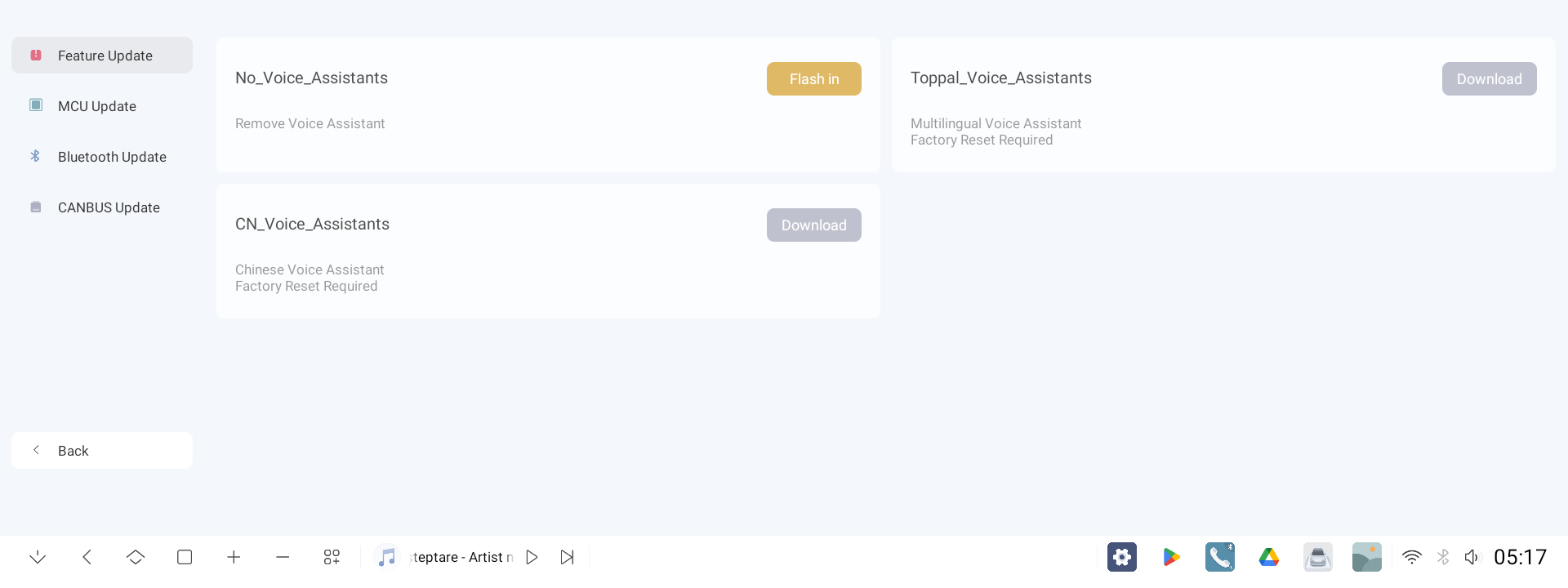

    Ranger OTA/Other update/Feature update/No voice assistants. Download and install that update and you'll get rid of toppal. After that, that button will be mapped to GA. I think you'll have to install it from Play Store, but not sure. For the moment it works as it should only for music. You cannot make phone calls or navigate with GA. Our team of developers are working on it.
    I think a factory reset will be needed in order to everything work correctly after this update.

    By the sound of it if I update the firmware, Toppal will be removed and the extra functionality I have from GA now, will be gone?
      Ranger This I really don't know. I am located in Europe. And I uninstalled Toppal first thing. Maybe there are members here who can assist you more. Sorry. And yes, if you update, Toppal will be removed, but GA will remain.
        MihaiFlorin Afaik, after the update nothing will change, meaning Toppal will still be tied to your SWC key unless you delete it. Then, GA would replace Toppal on the SWC, but as written before, you still can't make phone calls or use Waze navigation (Gmaps works...) with it.
